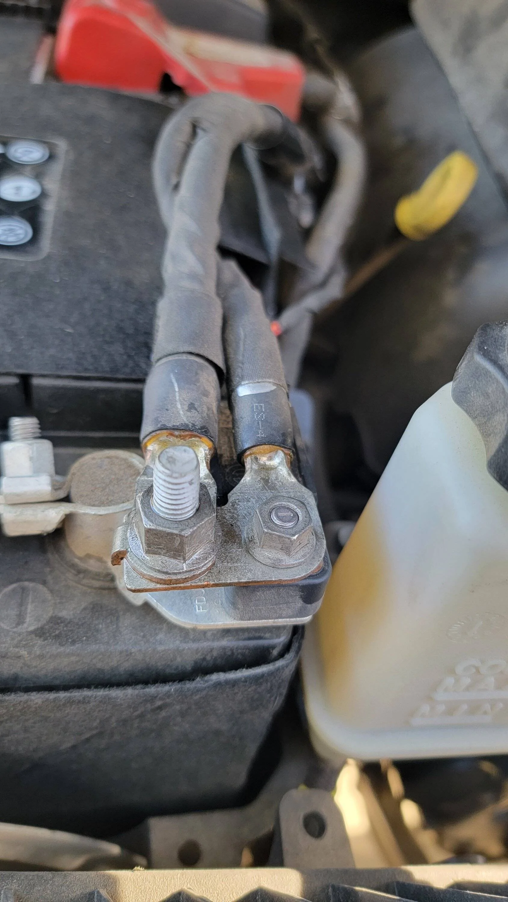

Question. The flat L shaped terminal is the Aux negative. Correct? That needs to get isolated. Looks like I have to get the 10mm nut on the right out, and mount the left side terminal directly on top of the battery sensor and put the 10mm back on. Correct? BTW it is really hard to get the left nut (the post one) out. Too tight.

Ok. Got the nut/connector out. Disconnected the Aux -ve. Taped it up well. Left the F42 in place. Tested the main battery at O'Reilly's. It failed. Replaced main battery with a H7/R94. Everything is looking fine now.
At the end of it all, I am now driving around with the ESS alarm still on, but there are no other symptoms of a weak Aux. My Aux switches unavailable warning is gone. ESS won't kick in on the main battery, so I don't have to remember to turn it off, or don't have to invest in a Taxer like solution right away either.
Will update in a day or two how it all fairs. Thanks all.
So was it the cable with the L connector?

@Upnarms I'm glad that Sam @WhitneyWillys found the correct cable,but in light of this post https://www.jlwranglerforums.com/forum/threads/ess-battery-cable-change.86624/ that reports on how Stellantis swapped the two factory cables on the main battery's negative post--one of those cables leading to the body ground and the other to the negative terminal of the Aux battery--I think it always prudent to start at the vehicle's body ground and follow that cable to the negative terminal of the main battery, regardless of what model year JL you have.
Once identified, that's the cable you leave connected to the main battery's negative terminal. It's the other one from the factory, which leads to the Aux battery's negative terminal, that in this exercise gets removed and has its metal end tapped up.
