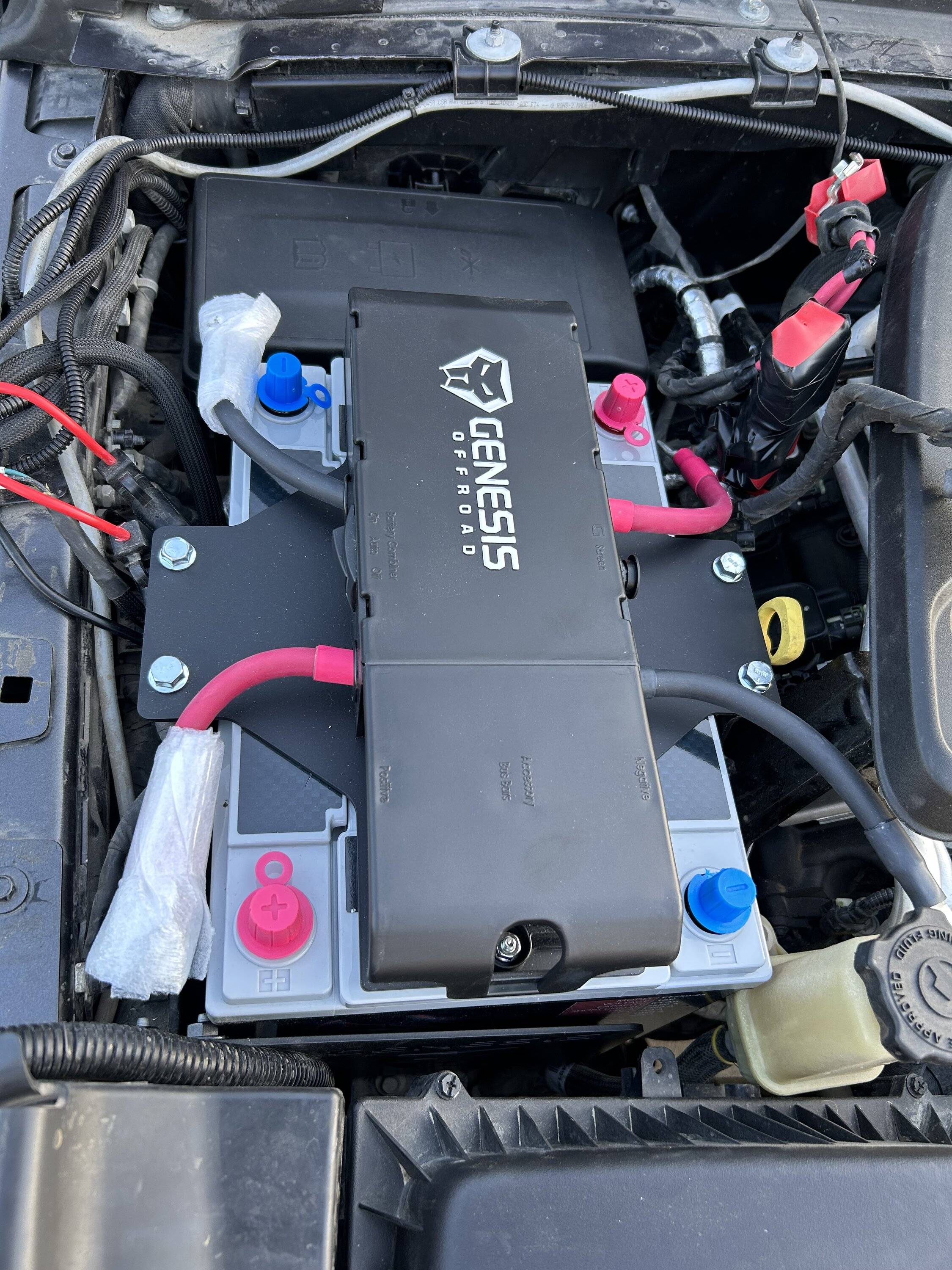

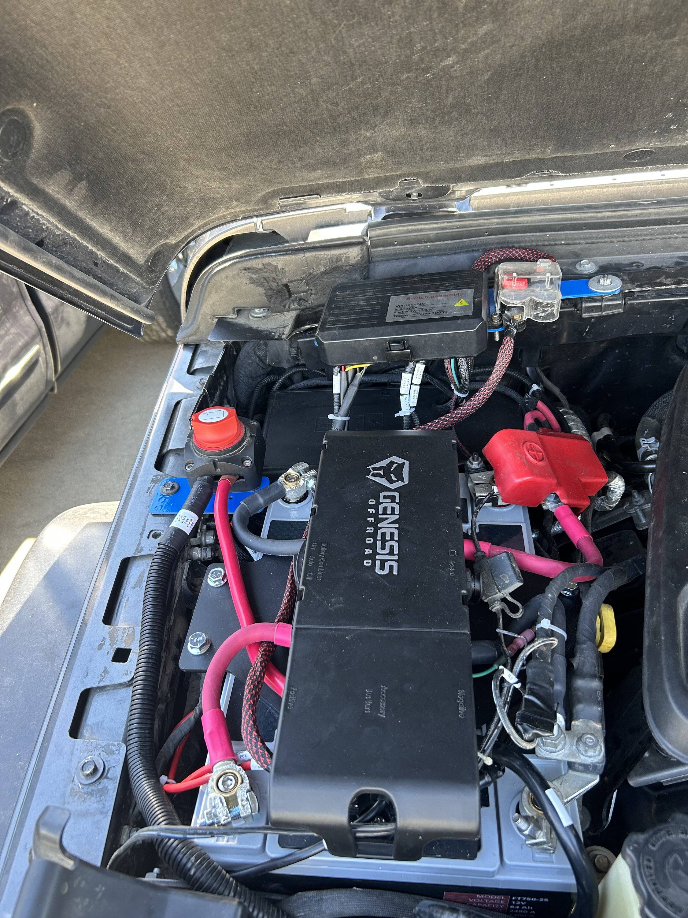

Batteries are failing. Might as well get the genesis dual battery kit and get your self a couple full battery’s instead of seal with aux batteries every couple years. Thus it is expensive to setup its well worth it
I love the Genesis kit for dual battery JLs/JTs but think it a lot of $ to part with, not to mention installation time unless you plan on running overlanding appliances off your batteries while camping. In that case the additional power and power management capabilities, I think, are great.
It’s an easy install. Maybe two hours. 3.5 if you don’t have much hands on experience or even 3.5 if your enjoying a couple adult beverages of your choice.
I couldn’t fathom buying aux battery’s ever other year and 100+ bucks each and know that it isn’t going to last. Plus it’s a good upgrade if you run winch
We clearly have different opinions (which is perfectly okay!) on whether 3.5 hours is a fair amount of time to work on a Wrangler mod. :)
