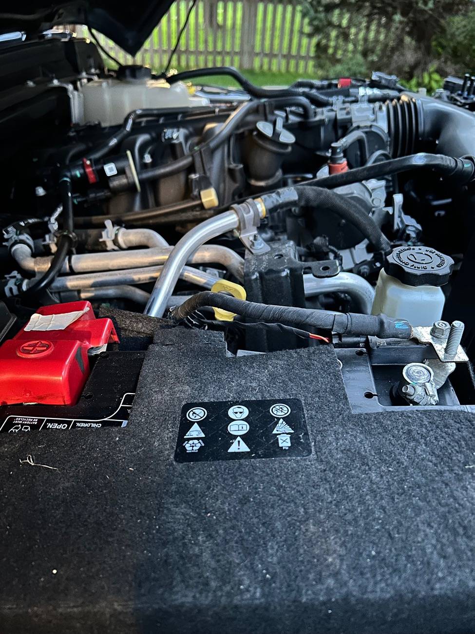

Jeep Wrangler JL Aux Battery Delete - Need Help! IMG_0125
Which leads me to my next question: my model JL does not have 2 cables to the negative post like I’ve seen some older models have. What cable would I be taping in this situation?

You have an eTorque 3.6 engine, it doesn't have an AUX (ESS) battery.
Wait, is this true?? How did I not know this??
