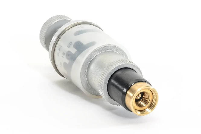

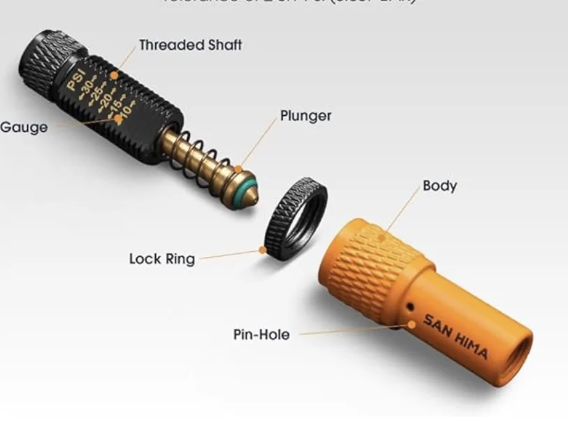

All of the tire deflators use the same principle. Tire air pressure lifts a piston which allows air to escape. The problem is that as the tire pressure drops not only does the pressure differential decrease also the piston lift decreases, so the tire pressure tends towards the target in an exponential curve that takes forever to get to the target. So I always drop the air manually for the last 5 psi or so. Which is a pain.
Jeep Wrangler JL Automatic Tire Deflators - recommendations? 1768324759777-pv
It would help if the piston diameter was larger and the bleed hole bigger. A better solution would be to use a spool valve, but no one has done that as far as I know.

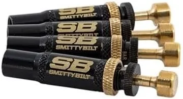

These were the best deflators but I have not seen them for sale for a long time.

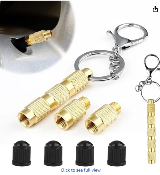

I gutted my deflators 2 years ago, I run different pressures on different trails. Just watch the dash and say close enough. Just bought the cheapest deflators I could for the wife's jeep, no hoses or crap to deal with. I also fill with a single air hose for the same reason, less stuff to mess with. I am usually the first one aired down and the first one filled back up on trail rides.
