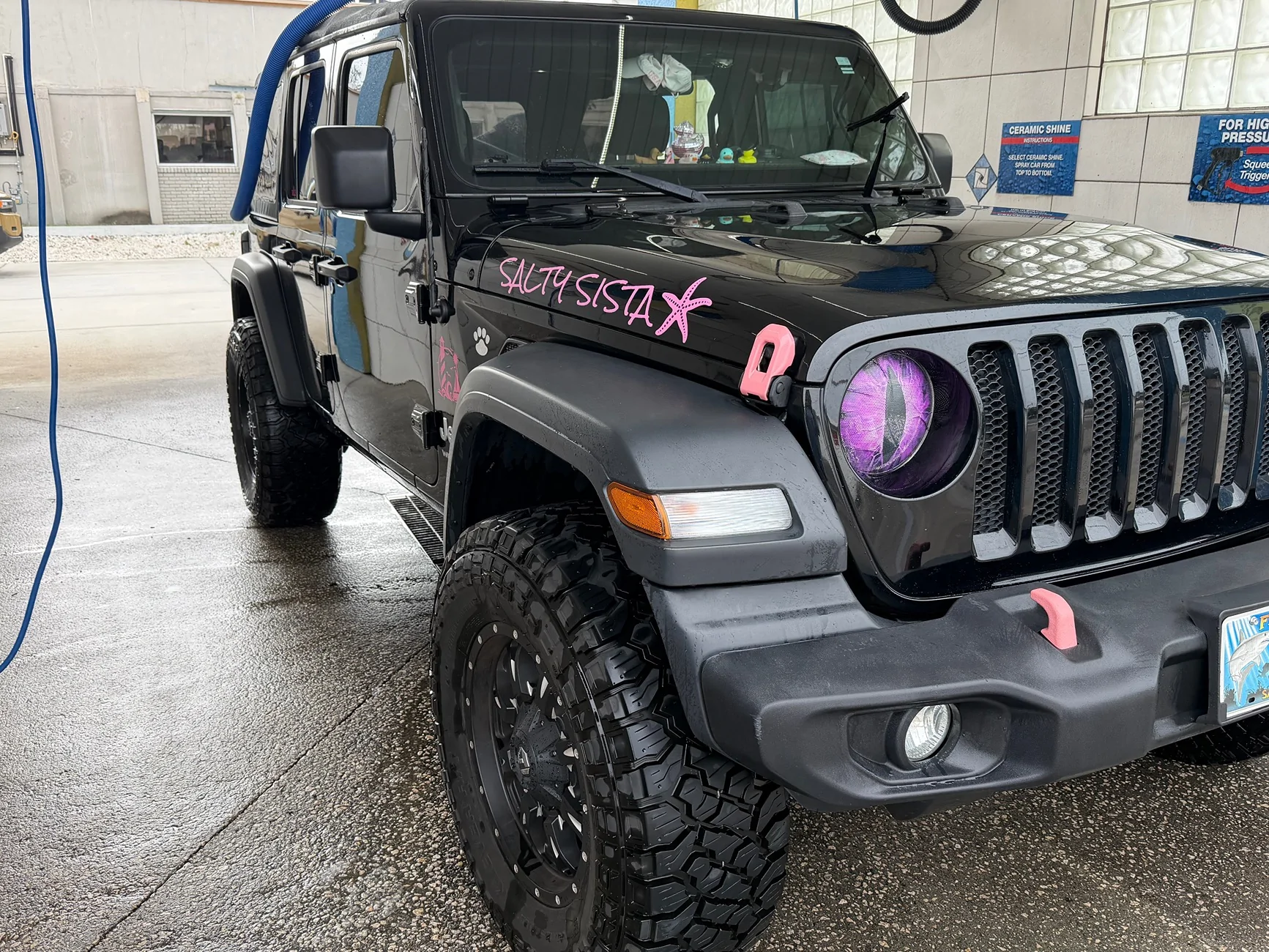

Pic for attention.

Get it scanned for diagnostic trouble codes and report back for better answers. Otherwise people are givung you best guesses. So…tell me about those headlight covers.
lol you like? Had to have them.

Not my thing but I’m just nosey in general. 🙂
