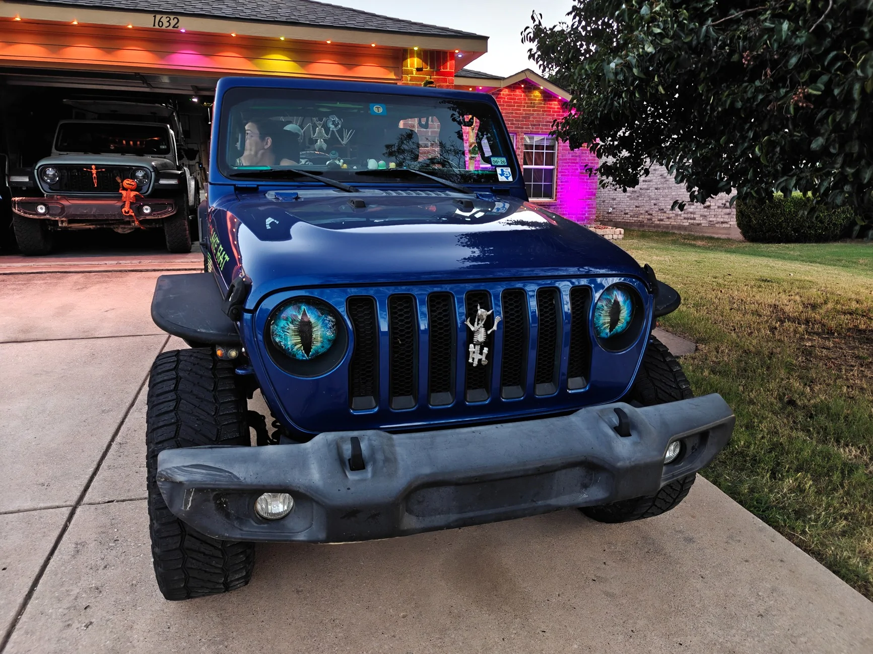

Not my thing but I’m just nosey in general. 🙂
@mwilk012 does this for a living. You can trust his advice
They are cheap stickers from Amazon. We met some people on the trail that gave the wife an extra pair they had. Would not recommend with the halogens and driving at night in the country or desert
I was brainstorming something for offroad mud guards for my headlights so I don’t have to clean them before getting back on the highway at night and this thread popped up. I’m not sure anyone in our group would invite me to wheel with them again, but still.
They are kinda thick and I have no idea how easy they come off yet. But I think your wheeling friends would love to see some accenting your ride :giggle:
Is it an optical illusion that the passenger is giving you the finger?
That's the ole ball n chain so it's 50/50 depending on what stupid things I said before taking the picture.
