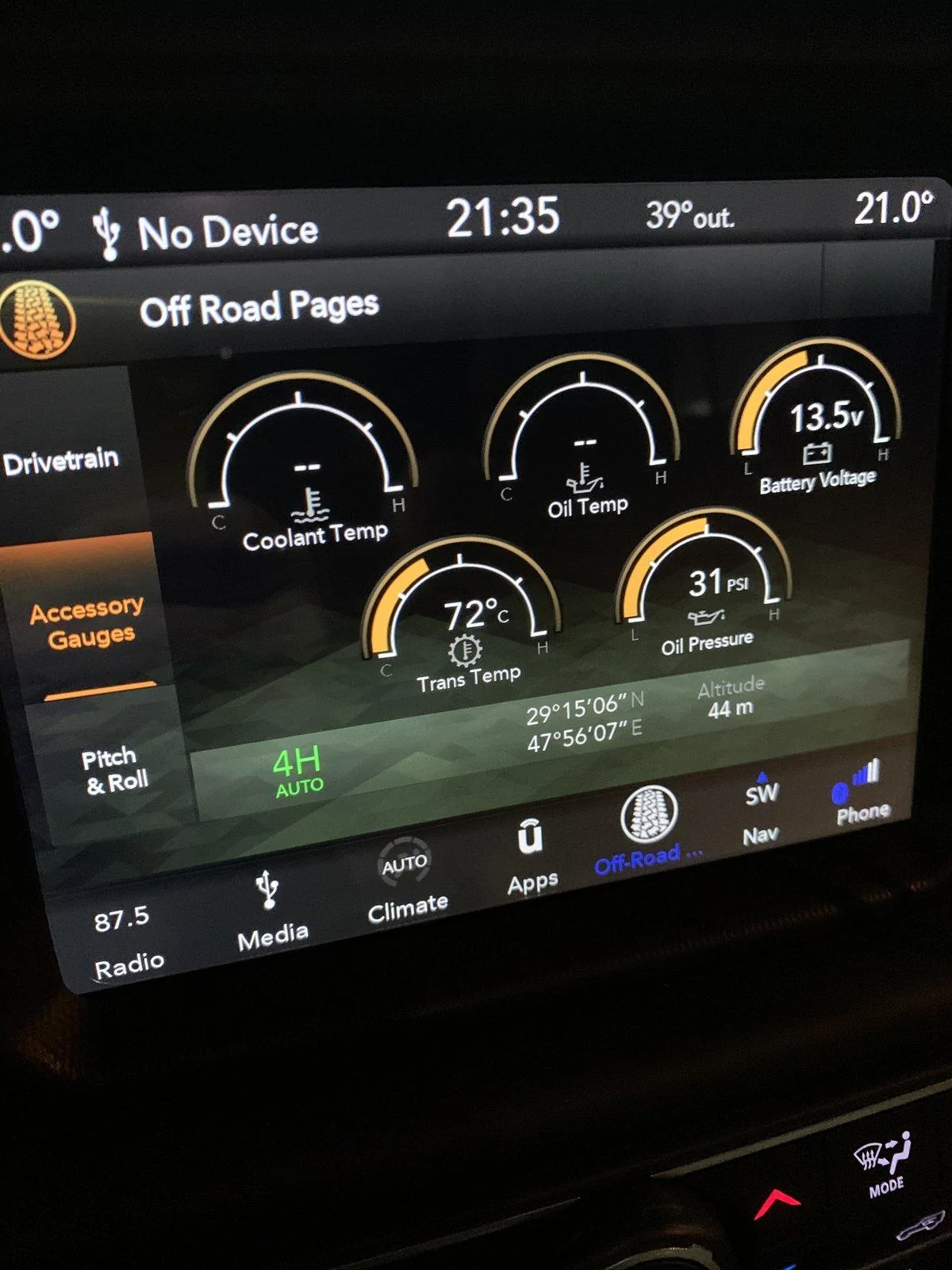

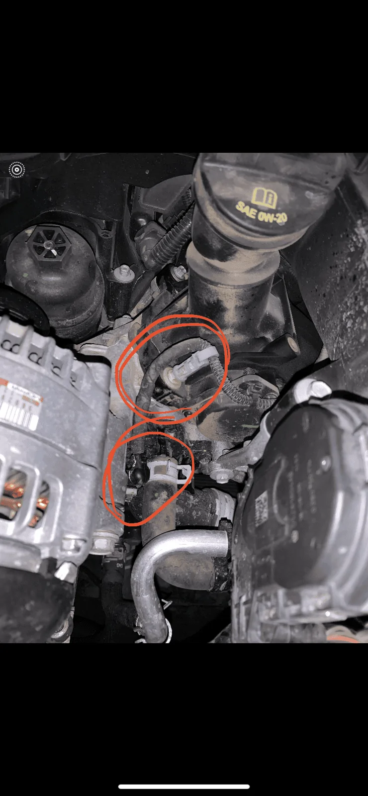

Who said the radiator ever hits 210 ever, let alone constantly? Have you measured the radiator temp? Have you even located the sender that drives the dash temp? Obviously it's your prerogative to go re-engineering things willy nilly, but I'd think understanding what is going on first would be beneficial.
You mean this thing ? Plugged into the thermostat housing ?

I dont know what im doing, i know places that are hotter than kuwait in the US, people are assuming i want to lower the overall temp, some replies are you will lower you temp so much its going to mess the electronics, some are saying it wont lower anything, if the radiator and fan have enough cooling capacity then i will be able to maintain 180, if it does not then il be back at 203.
And how does 220 degrees on the head-side of the thermostat translate into a 220 degree radiator? And how would a 220 degree radiator temp (that doesn't exist) turn into a 220 degree ambient temp for the fan?
