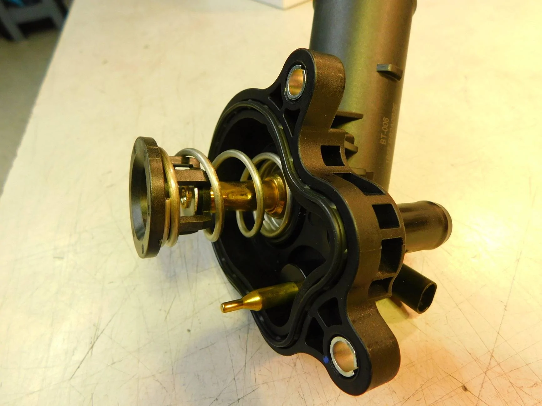

I'm running 5w-30 Valvoline (Dexos) in my new Wrangler Sport S 3.6, I also have a RIPP 180° thermostat for newer JL (185° is stamped on the housing). Haven't installed it yet...RIPP says it opens 12mm compared to 7mm for the stock 210° thermo.
I had excellent results reducing the temp on two BMWs, my '13 128i (the last 3 liter non-turbo six) always ran hot when stuck in traffic. I took the thermo housing out, took it apart, searched for a similar diameter 180° thermo to replace the 205°. Worked perfectly, overheating in traffic was gone. One note of caution: do NOT go below 180°, the engine will stay in cold-start mode.
Final note: my C8 Corvette specs 0w-40 oil. They also spec "Dexos", which is GM's approval for proper cold start viscosity. IMO, every engine should run a Dexos-approved oil, certainly in colder climates.
