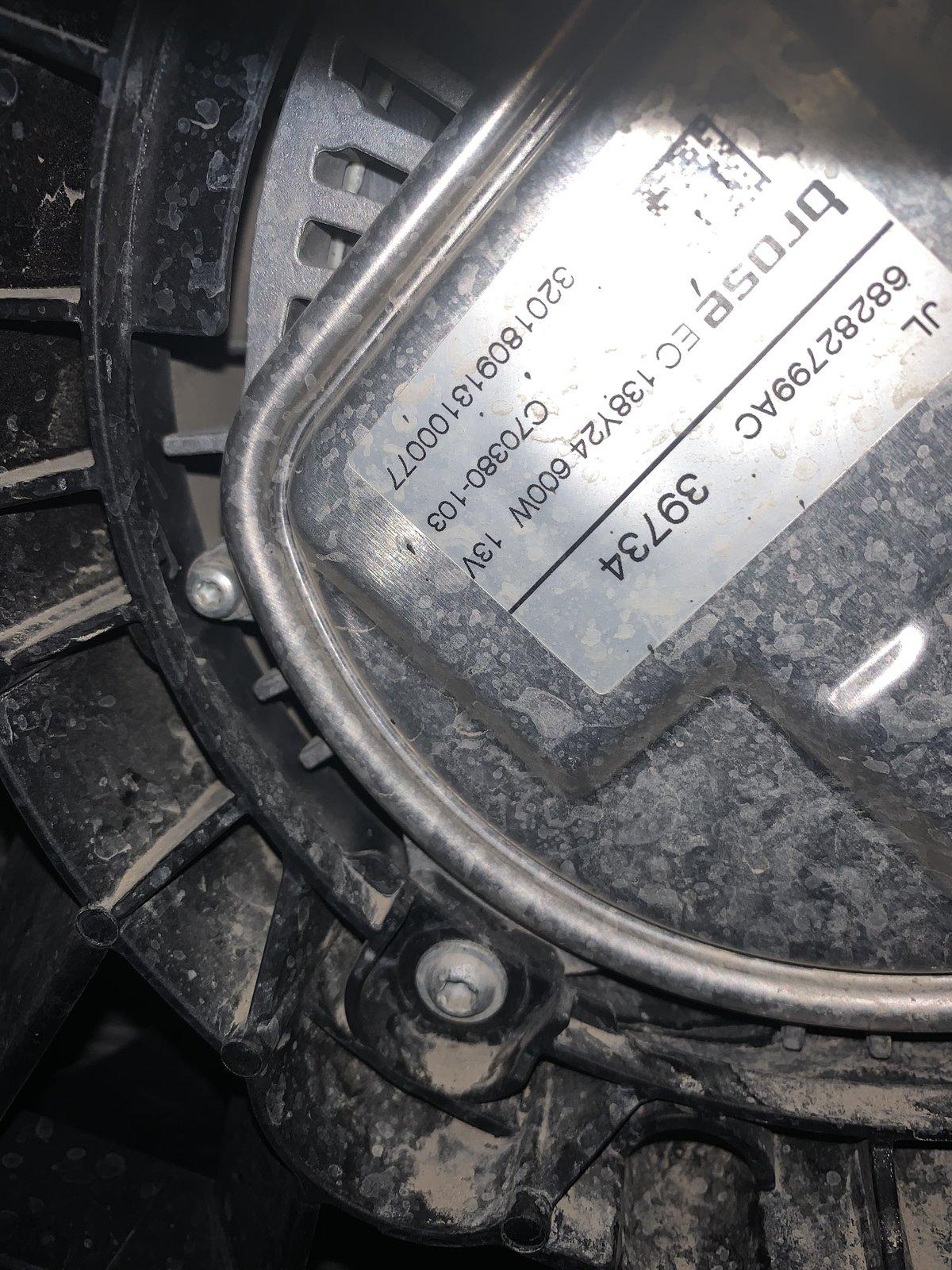

The same upgrades above should apply to any jl, do you have the tow package ? I know the tow package comes with a 240amp alternator and 850w fan on the gladiator, i assume its the same on the jl not sure about the fans. So if you bought the tow package i would check the fan if it says 600w or 850w. Its a white sticker.

The gladiator with tow package has its own fan, the JL was not built for towing and does not have additional cooling options.
