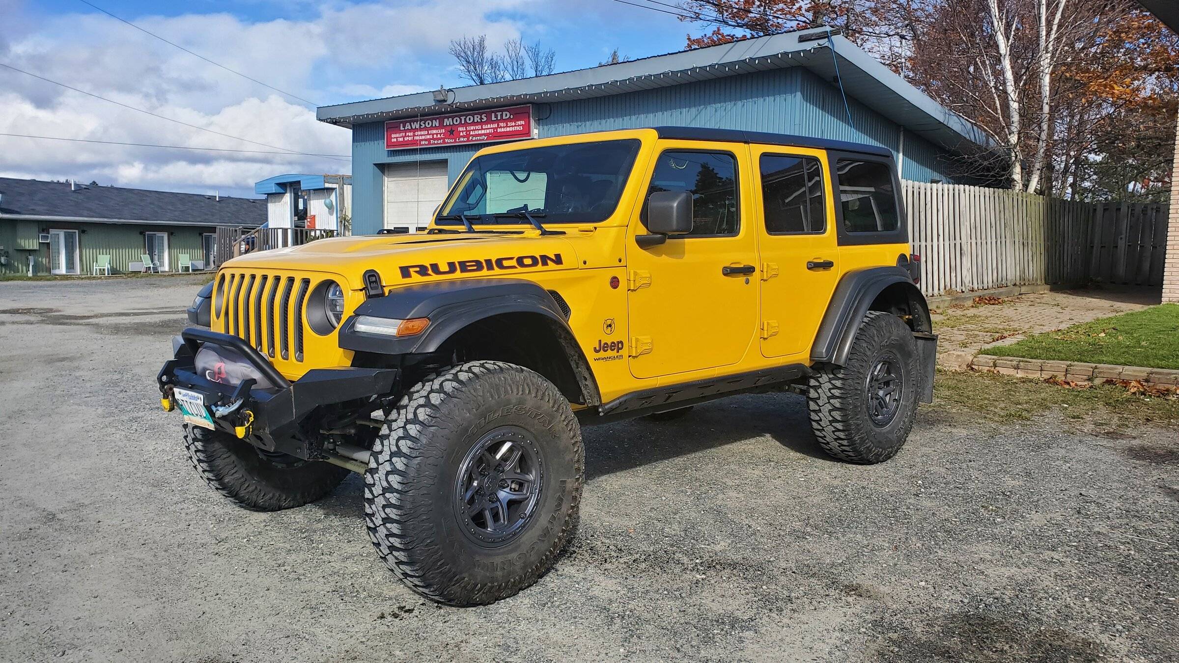

SO, I got the Borahs for my 2020 with 3.5" Metal Cloak lift (plus 1" spacers for 4.5"). With Milestar Patagonias 38x13.5, I rub my control arm on full turn. Also, when I'm on the lift (both tires drooping), the driver side rear sway bar presses into my tire. I'm not so pleased.

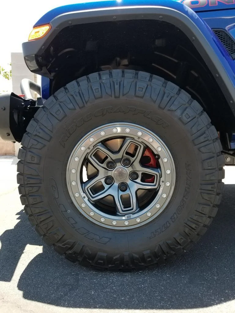

I just mounted the JL spec Borah's and was not expecting as much poke and I love it. I for some reason did the math wrong on the offset and bs and thought they would be tucked in more. Thankfully I was wrong.
Compared to the XR bead locks I just took off these don't poke out as much and I think they fit perfectly. Wrapped in 315/70/17 KO2's on stock height

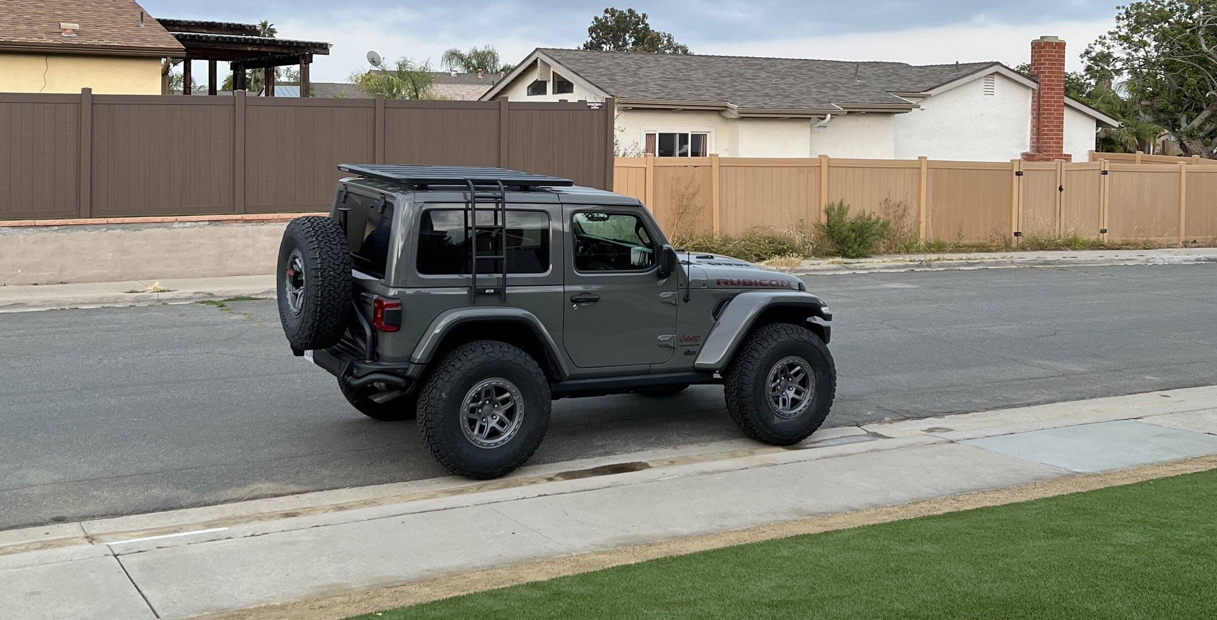

Thank you once again to all who posted on this thread. Adding my contribution to help the next person decide
Decided to give the Jk spec Borahs a shot with their slightly more aggressive offset; +4mm
Tires: 37x12.5x17 BFG's load C
Before rear leveling spacer:
After rear leveling spacer

38x13.5 was pushing it... you can add wheel spacers or add a washer or two under the steering stops to limit your steering radius. As for the sway bar, I'd bet your axle isn't centered. Have you ran an alignment after installing your lift?

I'll probably end up putting steering stops in. I have the Metalcloak GC lift 3.5 (with 1" spacers on drivers and 1.5" spacers on passenger), so the control arms are rounded... no tire damage if I rub. I won't be doing wheel spacers.
I definitely got a full alignment after the lift. Visually, the axle is centered. The tires stick out the same on both sides.

That's weird then, I'm running 37x12.5 and the rear sway bar is not even close. Depending on where it is rubbing, maybe you can lengthen or shorten your links to help with the situation?

That's my thought, or just delete the rear sway bar.
Are you saying you first purchased the JL version then switched to the JK? Do you have a pic down the side to match the JL version you posted above?
