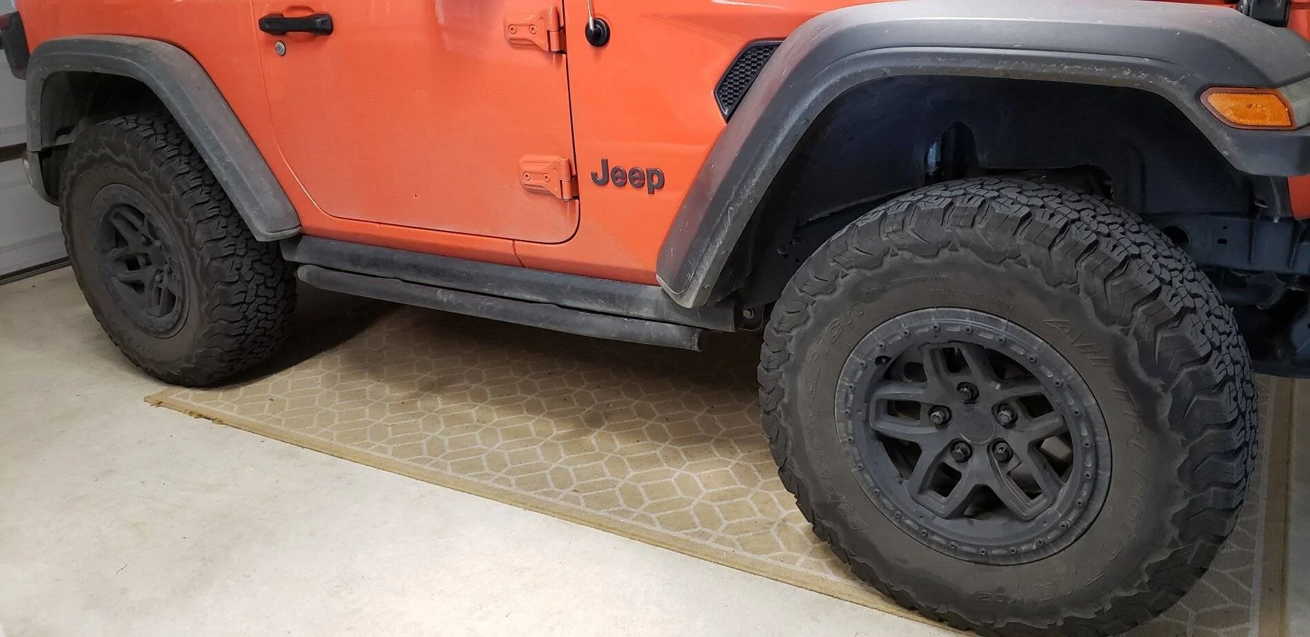

I swapped out all my bolts to stainless. Here is the link to what I used. I torque tested them and they didn't start budging till 30 foot pounds. They say serrated on the back but it is pretty much flat. Haven't had any issues. All torque down without a problem.
M8-1.25 x 35mm Flanged Hex Head Bolts Flange Hexagon Screws, Stainless Steel 18-8 (304), Plain Finish, DIN 6921, 15 PCS https://www.amazon.com/dp/B07SSRT59...abc_T11C4Y8RSFPGAJGQDB63?_encoding=UTF8&psc=1
Jeep Wrangler JL AEV Borah wheels on JL 20210918_091423
Jeep Wrangler JL AEV Borah wheels on JL 20210918_091414

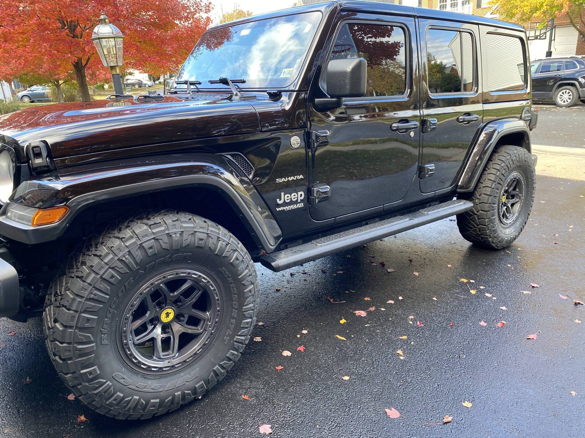

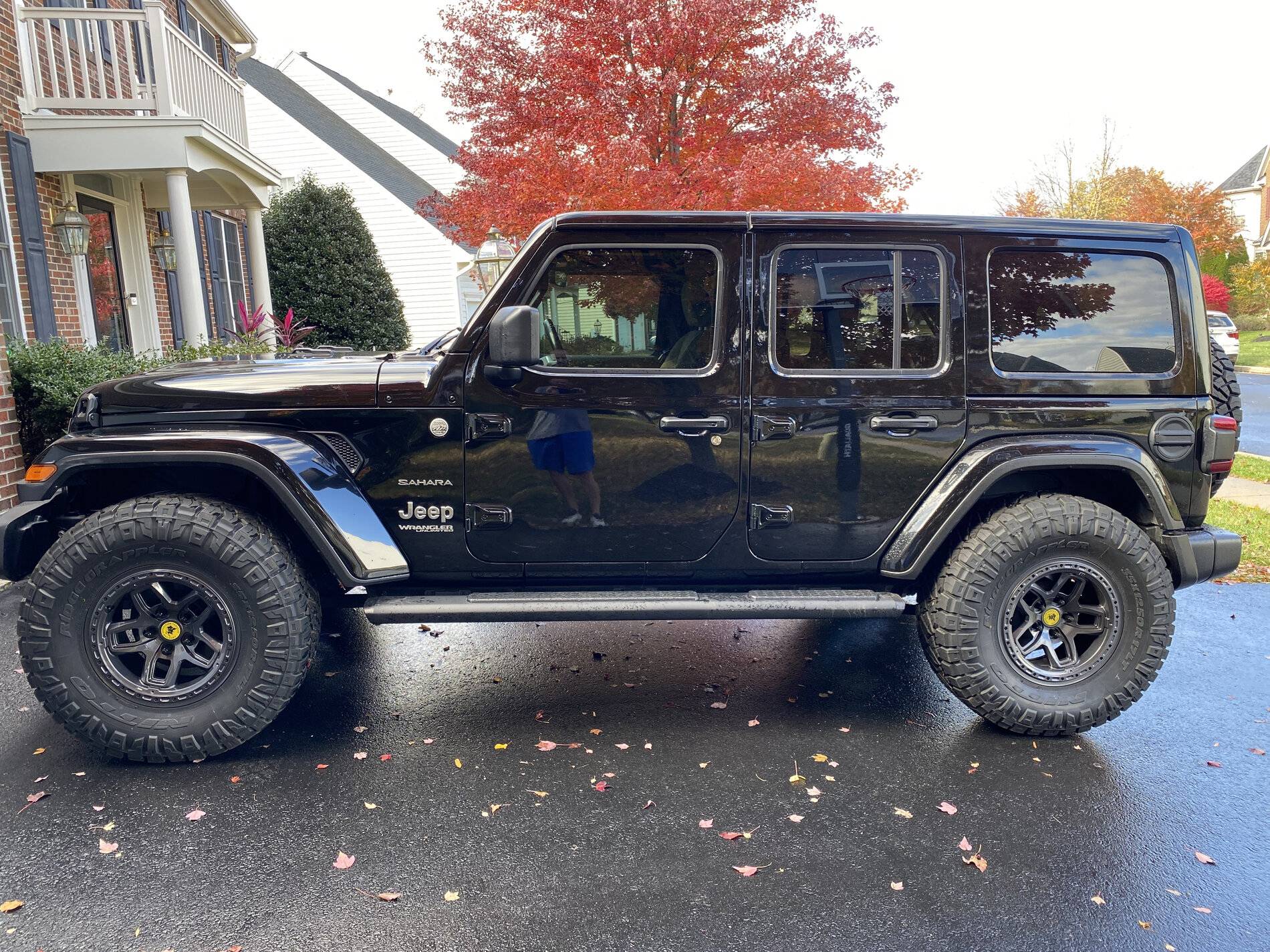

Late to the thread... but just put the Borah's on my Sahara JLU this week. Added NRG 35s w/o a lift. Had to add spacers to protect the control arms. All in all, pretty happy w/ the look
