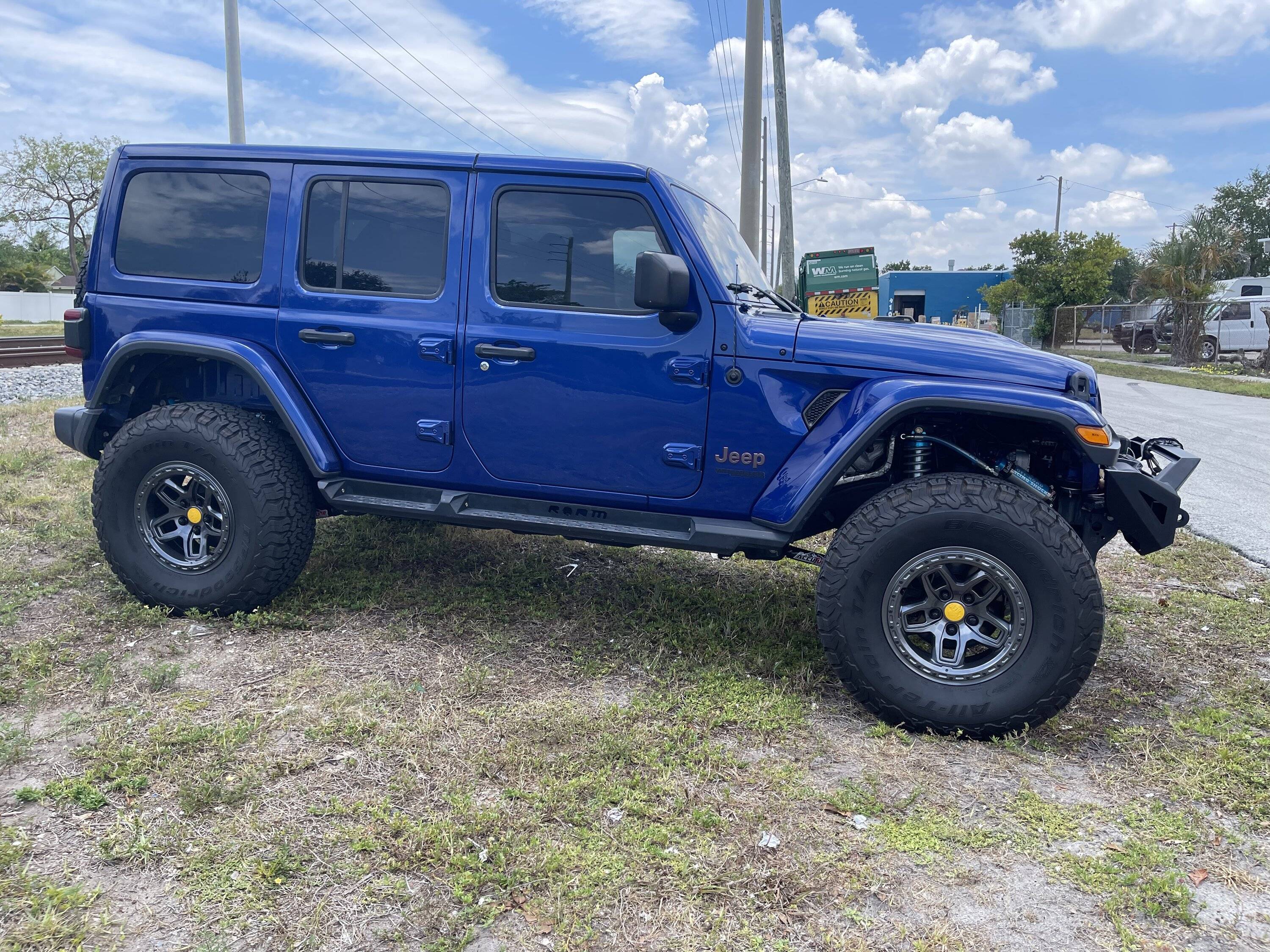

Are you saying you first purchased the JL version then switched to the JK? Do you have a pic down the side to match the JL version you posted above?
Correct. I had ordered both the JL and JK versions to see which fitment I liked most
Wrapped the JK Borahs(+4mm offset) in 37x12.5x17 KO2
Wrapped the JL Borahs(+25mm offset) in 315x70x17 KO2. These tires were actually wider than the 37's
As requested, JK Borahs(+4mm offset) in 37x12.5x17 KO2's
Jeep Wrangler JL AEV Borah wheels on JL IMG_1352
It seems they were pushed just as much with both set ups because the width of the 315's makes up for the 25mm offset on the JL Borah's. Maybe slightly more pushed out on the JK's but not by much

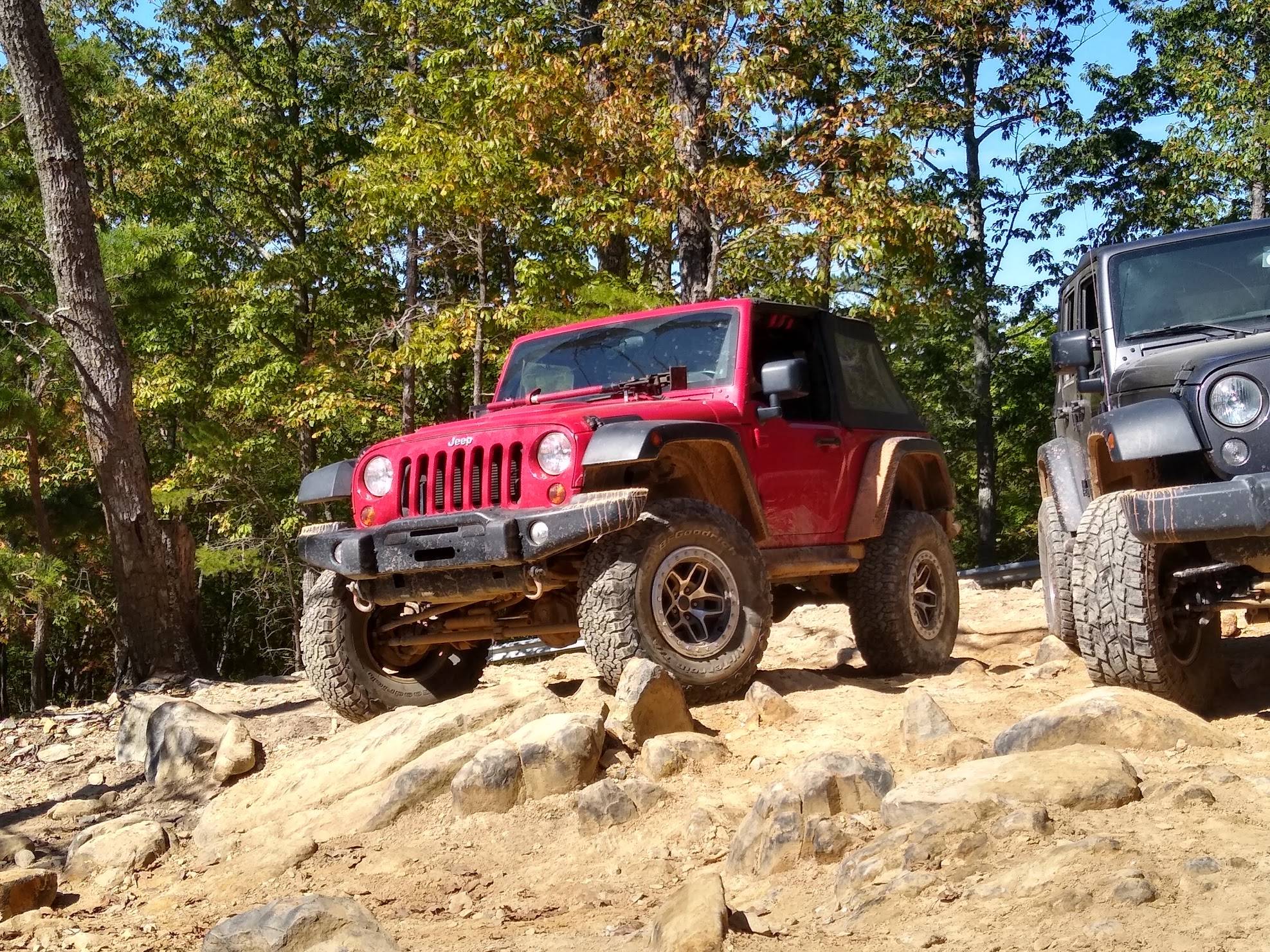

Damn, that's really torn up. I'm thinking that the protective ring wouldn't have stopped that outer scraping.
Totally does - pic below is my JK with the ring installed, covers that whole area. Bolts held up well to being rubbed against rock, too, thankfully. Ring does get scraped up though, but it's basically a wheel skid in reality, so a sacrificial part.

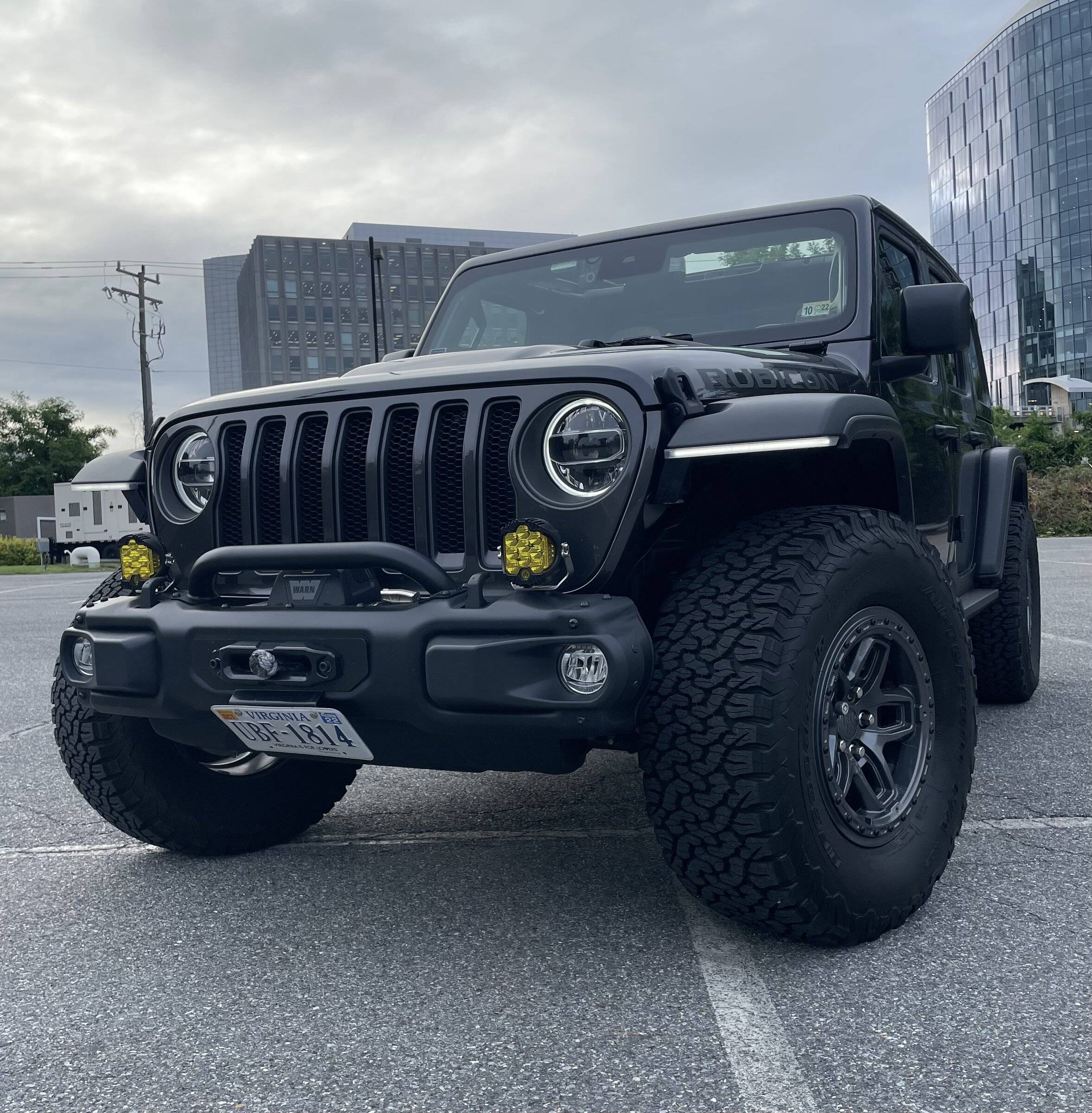

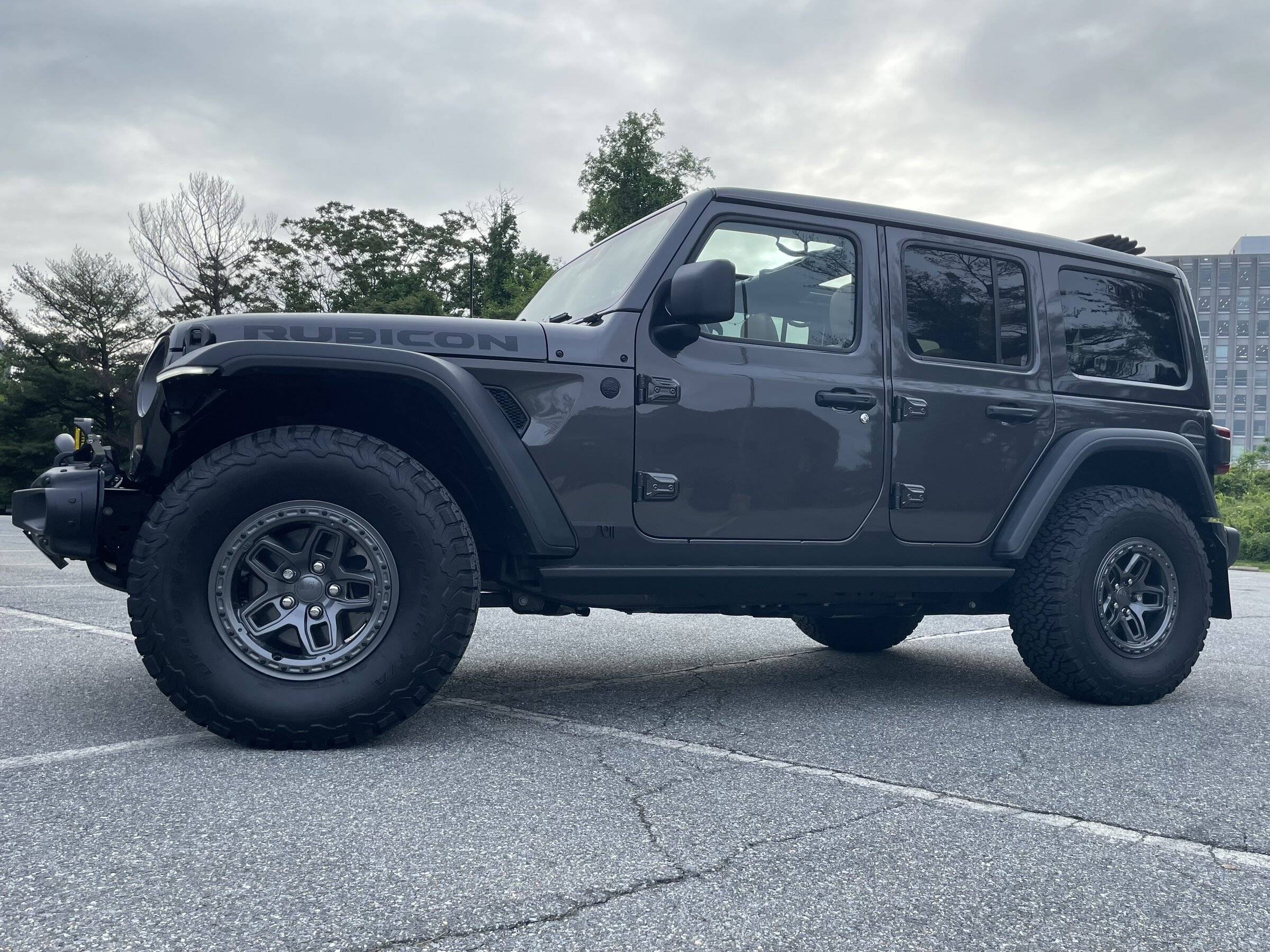

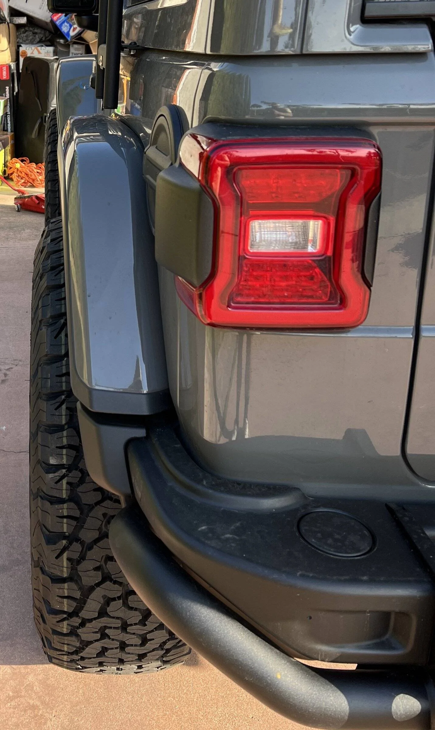

Got my Borahs on 315s. No lift just shocks and a fender trim up front.

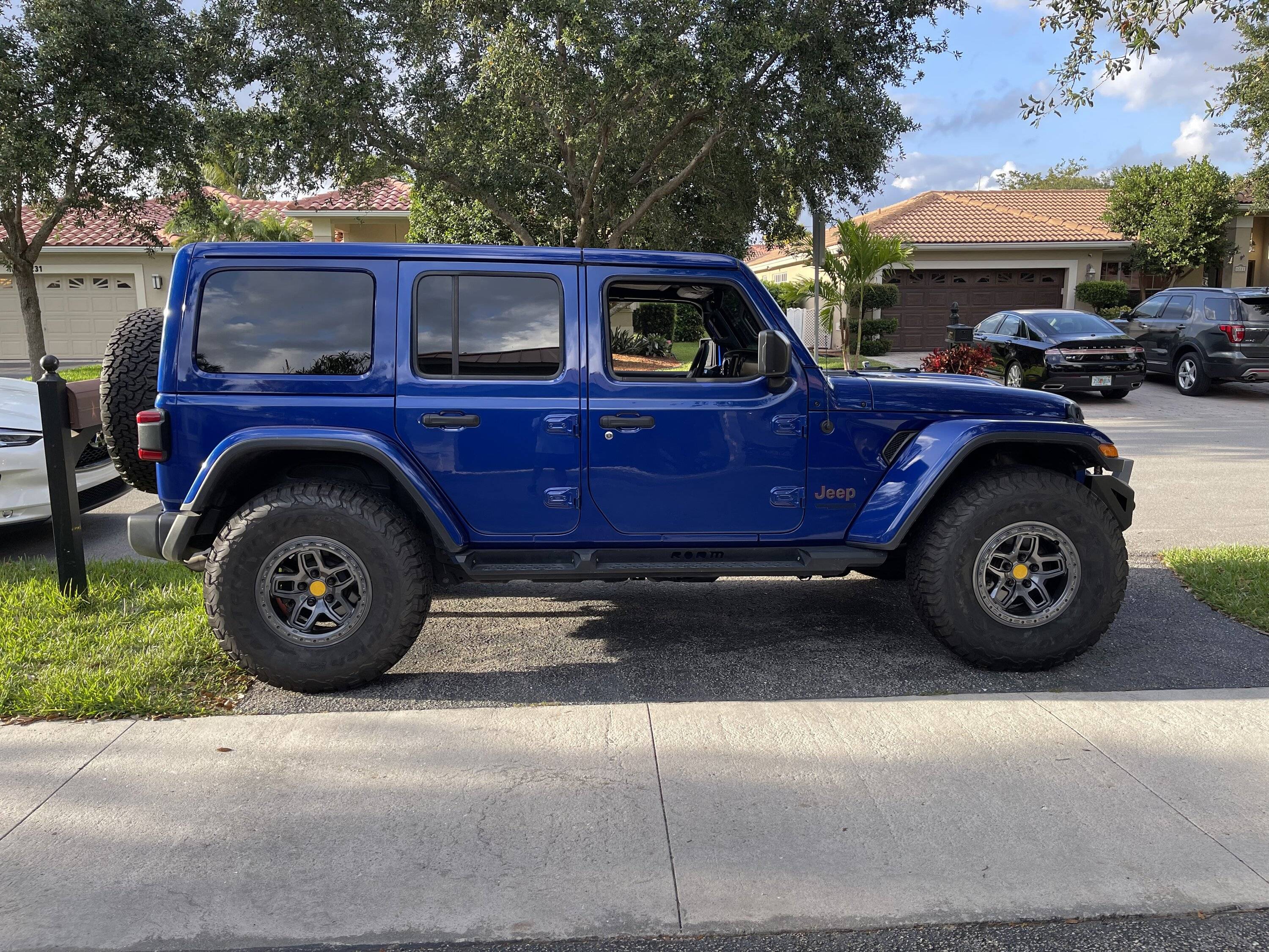

Decided to go back to the JL spec Borahs but went with 35 inch Ridge Grapplers
Jeep Wrangler JL AEV Borah wheels on JL Snapseed 10

Again, cannot thank you all enough who posted in this thread. Really helped me decide which direction to go. Hoping these pics help the next person with their next wheel setup

Looks awesome. Not my Jeep but if you ask me I personally prefer the slightly more tucked look that the JL offset wheels offer over that of the JK spec. There is still poke but it looks refined.
Thanks for sharing. You have reinforced my decision to get these wheels for myself someday in the future.

Thanks Tim! Agreed. It was a tough call but I leaned more toward the JL spec ones. Post some photos when you get yours :jk:
