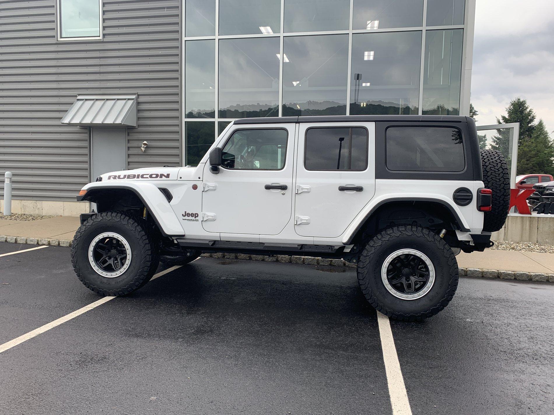

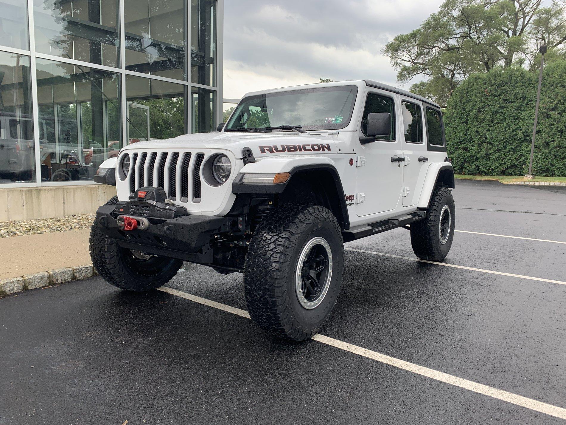

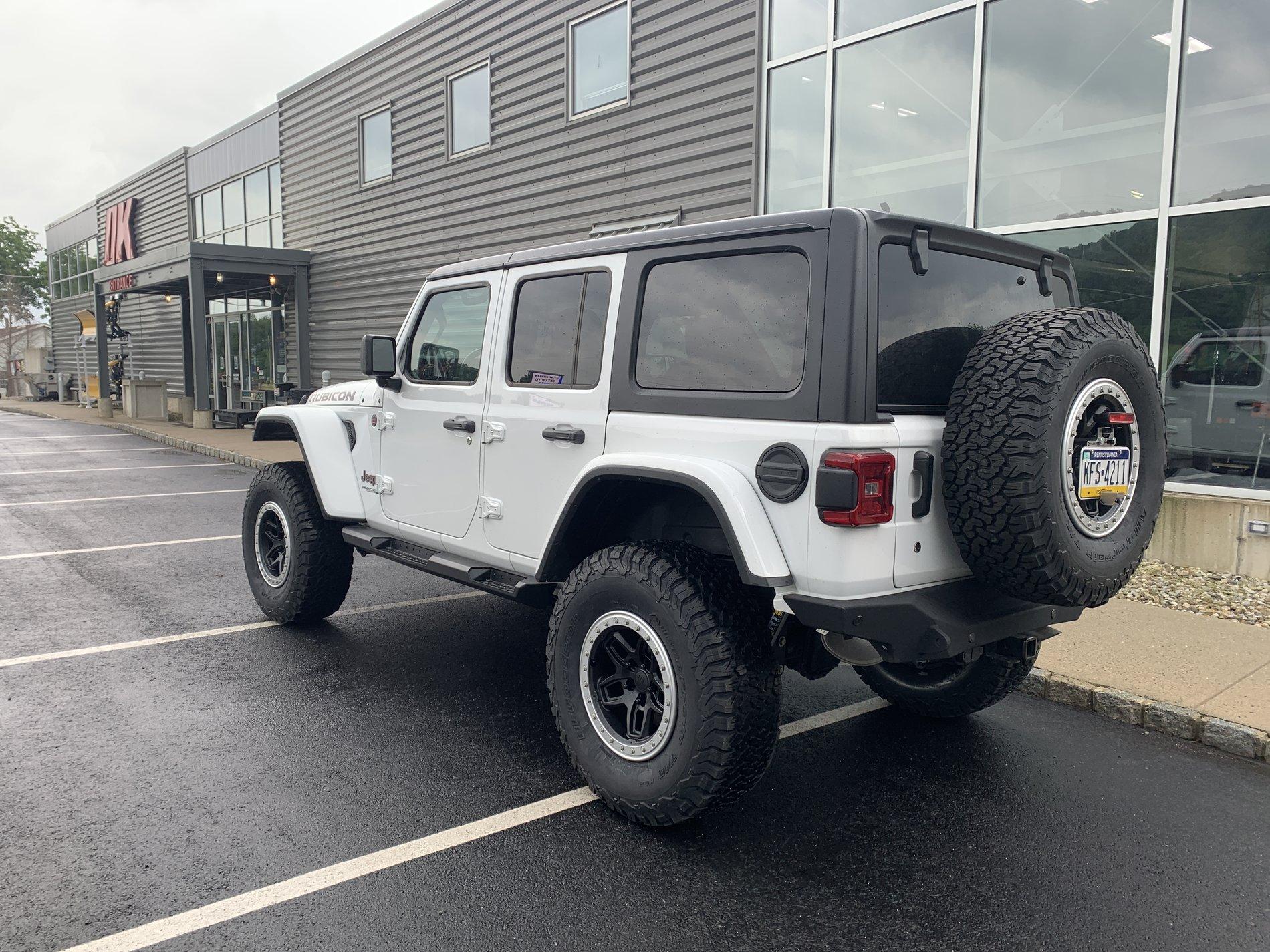

JK or JL spec?I went with satin and I'm loving them. Just picked it up at AEV yesterday.![]()
It's a JL370, so JL spec.JK or JL spec?
So those are the 37's?I went with satin and I'm loving them. Just picked it up at AEV yesterday.![]()
Yep. The diesel, 37s, and 4.63 gears make a great combo. Light years ahead of my previous manual 3.6L JLUR with 4.10 gears.So those are the 37's?

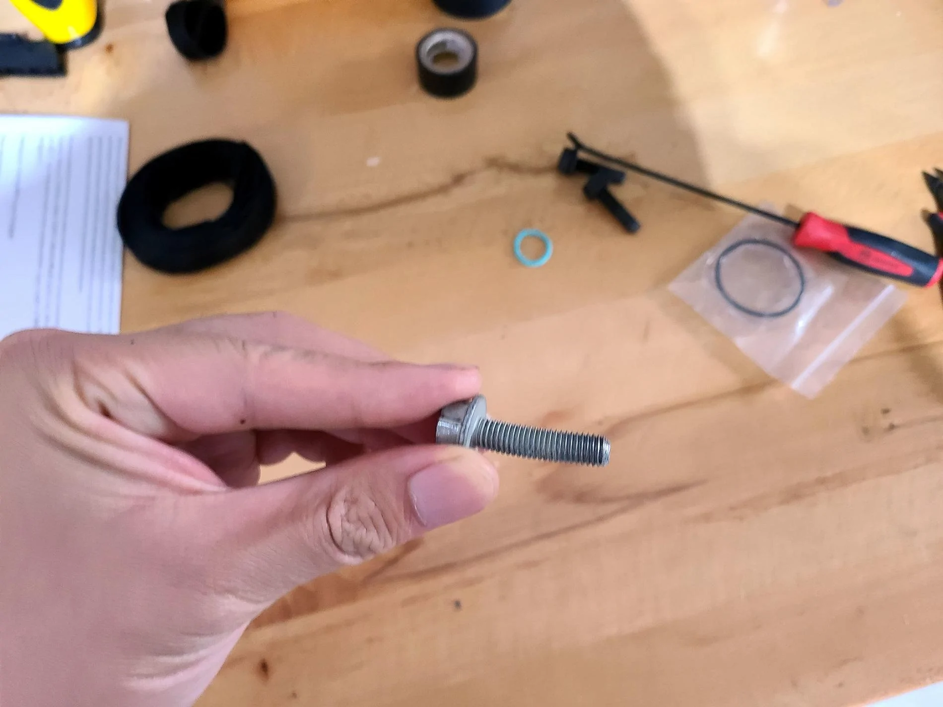

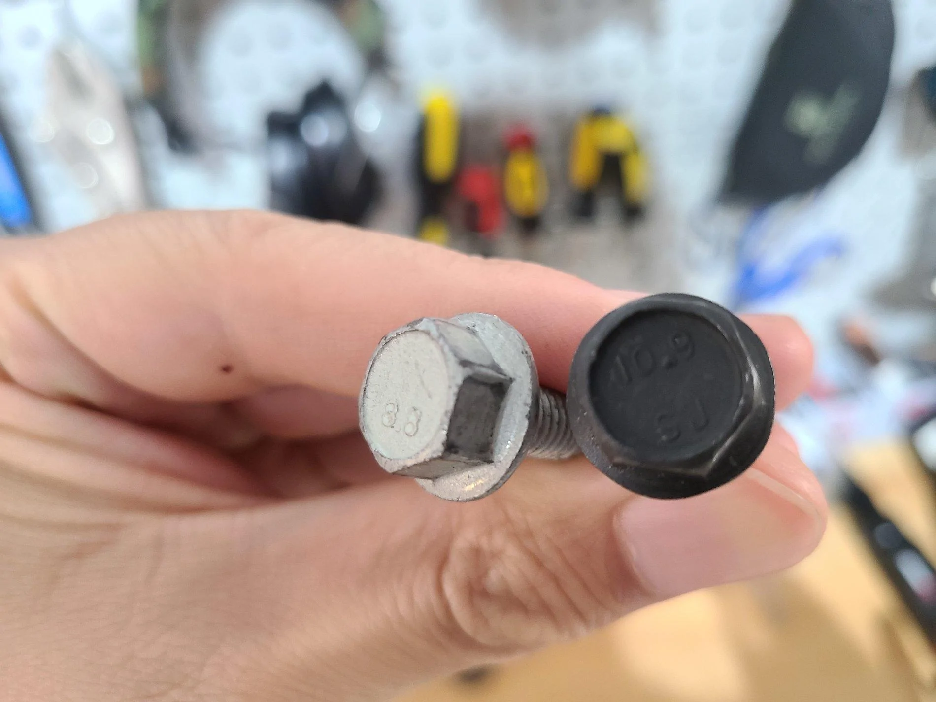

Where did you find these black bolts?So I drilled out another one today, PITA. Had to tap the thread and replaced all bolts with grade 10.9 black bolts, now it is much less likely to broke, and I dig the black on onyx look.
You can see some of the AEV bolts I get out are already bent, that is how soft they are.
