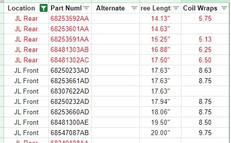

Does anybody know the extended lengths of the springs front and rear for Rubicon X?
I've only come across a few free lengths for OEM springs (some I measured myself). Might be close enough for your purposes.
Jeep Wrangler JL Actual height difference between Rubicon and Rubicon XR? 1722030189831-55
Basically a ~26.25" shock length unseats a Sport spring in the front, ~27.75" in the rear. These springs would unseat with some 2-3" lift shocks at stock Sport height. A more realistic scenario would have a 2" spacer on the Sport springs, meaning ~28" extended front shock length.

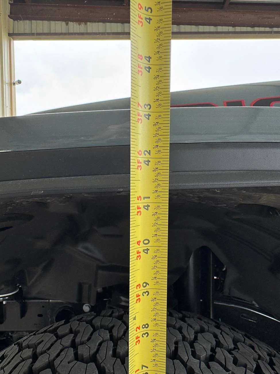

Alrighty, going to overshare a brain dump. Perhaps it proves to be useful for someone, maybe not... :) Note that throughout these pictures, the tire/wheel combo remained consistent.
I have a 2024 JLURX with factory steel bumpers and I added a winch myself. As far as I can tell, from the factory I had the same springs that come with the steel bumper/winch combo (Front, right factory coil P/N 68631093AA).
Front fender measurement, factory configuration, no winch (40.75")

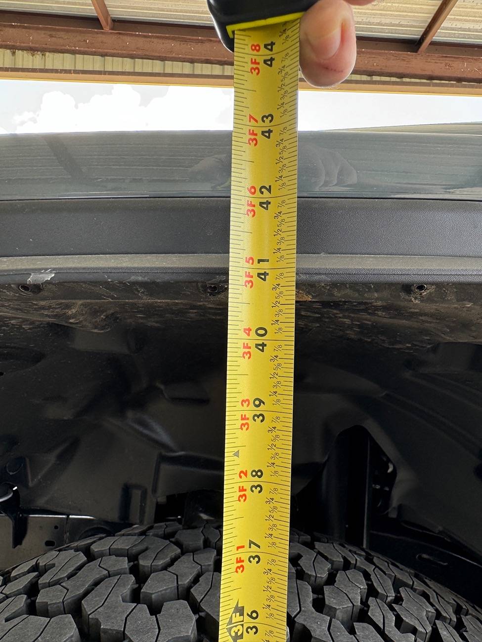

From there, I added a winch and bumper bar, prob about 100lb of stuff. This resulted in about a 0.25" drop (40.5")

Not thrilled with the factory rake anyway, and now additional 0.25" of sag, I went ahead and put in a 1" Teraflex coil spacer in the front. Oddly enough, this got me to about 41.25". I am assuming in the days between adding the winch and measuring, the coils settled a bit further, rendering only 0.75" of lift from the previous measurements.

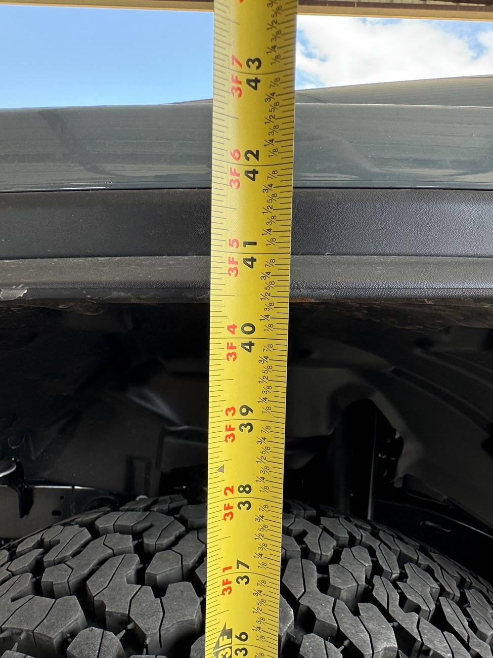

Happy with it visually, but still wanting a coil that handled weight a bit better, I went ahead and just completed the install of @Clayton Off Road 1.5" coils front and rear. I need to drive a bit to get a feel for how it handles, but it raised the measurement in the front to just a bit more than 41.5" after settling a few tenths.
Jeep Wrangler JL Actual height difference between Rubicon and Rubicon XR? 1722031015648-wt
If curious... The rear went from 40.8" to just a bit more than 41.25"

I’m wondering too on the factory spring. There are so many spring combinations from the factory, it’s hard to track.
From factory height, to after the clayton springs + winch, i gained right at 0.75”. (40.75” -> 41.5”)
