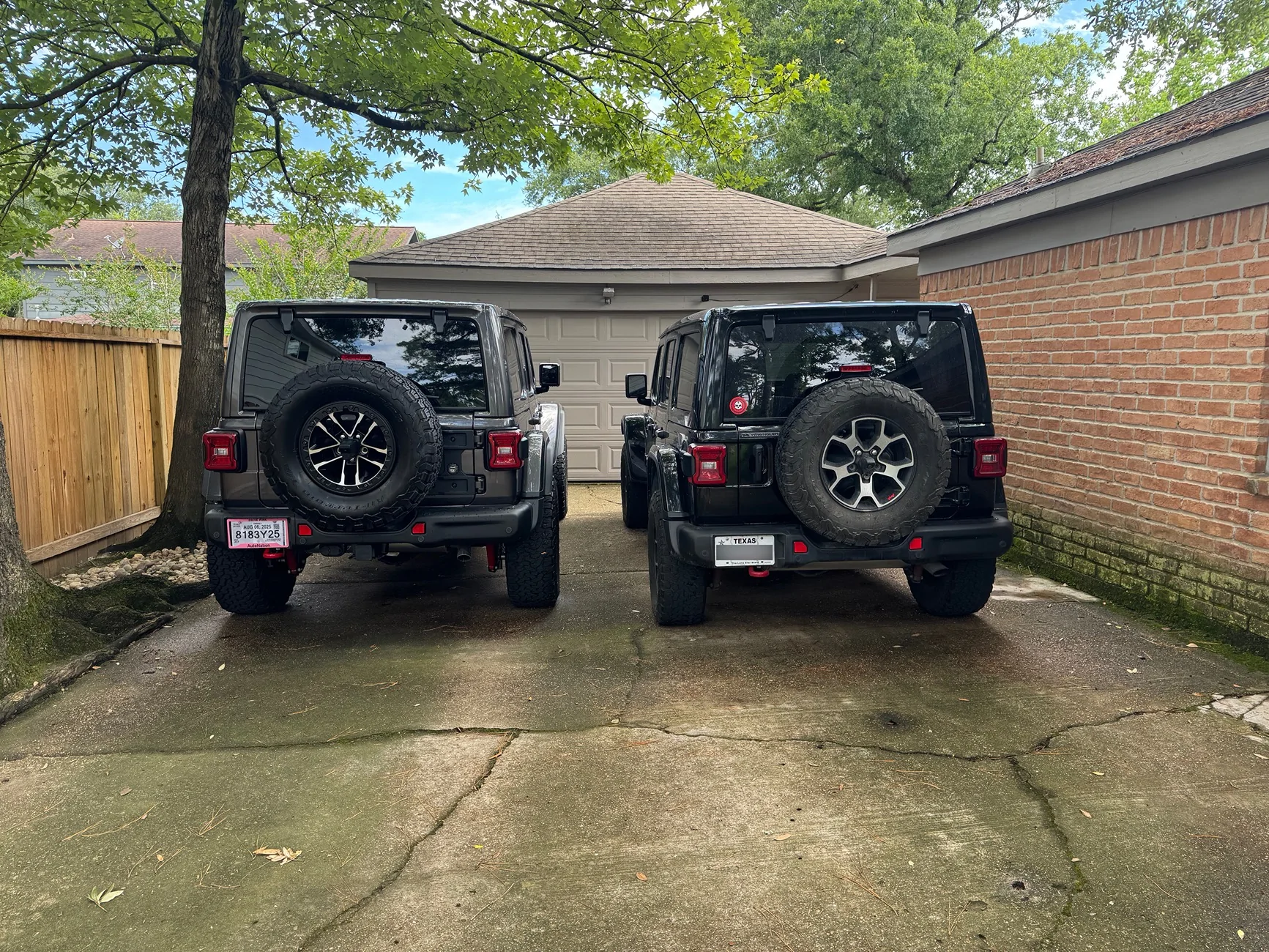

Since there's already been some measurements posted. I just wanted to share a side by side comparison in the driveway. Left is a '25 Rubicon X with the 35" tire package. Right is a '21 Rubicon on stock 33". Both have factory steel bumpers, KO2 factory tires, hard tops, etc. So optioned from the factory relatively the same aside from the 35" tire package. May be only 1.5" but makes a big difference to my eyes.

Yes, the complete XR package side by side is around 2.5” taller in comparison. In your case You have to factor in 1.5” for the suspension lift plus about another inch in tire height.
