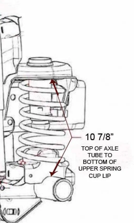

I’d be more curious to see what measurement people are getting as in the image below. Seems like it would be a lot more accurate data. Include what changes have been made like going from OEM plastic bumpers to metal bumper with a winch etc
Definitely more accurate than fenders etc as then you're factoring in tires and such. I didn't bother to measure as it wasn't really important since I was unhappy with bump stop clearance and adding spacers anyway. XR springs and spacers are long gone so I couldn't tell you at this point.

I bought a 23 JLU Rubicon XR 3.6 with OEM plastic bumpers. I added an ARB front and rear bumpers, Warn winch, Metalcloak skids, and RSE step sliders. I was hitting the front jounce tubes hard even on road at times. Recently I added a Teraflex 1.5” spacer lift. My measurement at that point is now 13.5 inches.

My 2024 JLURX with steel bumpers and winch, with 1" front spacer, is right at 12.75" axle to spring hat. I only lost about 1/4" by adding the winch, but still added the 1" spacer.
