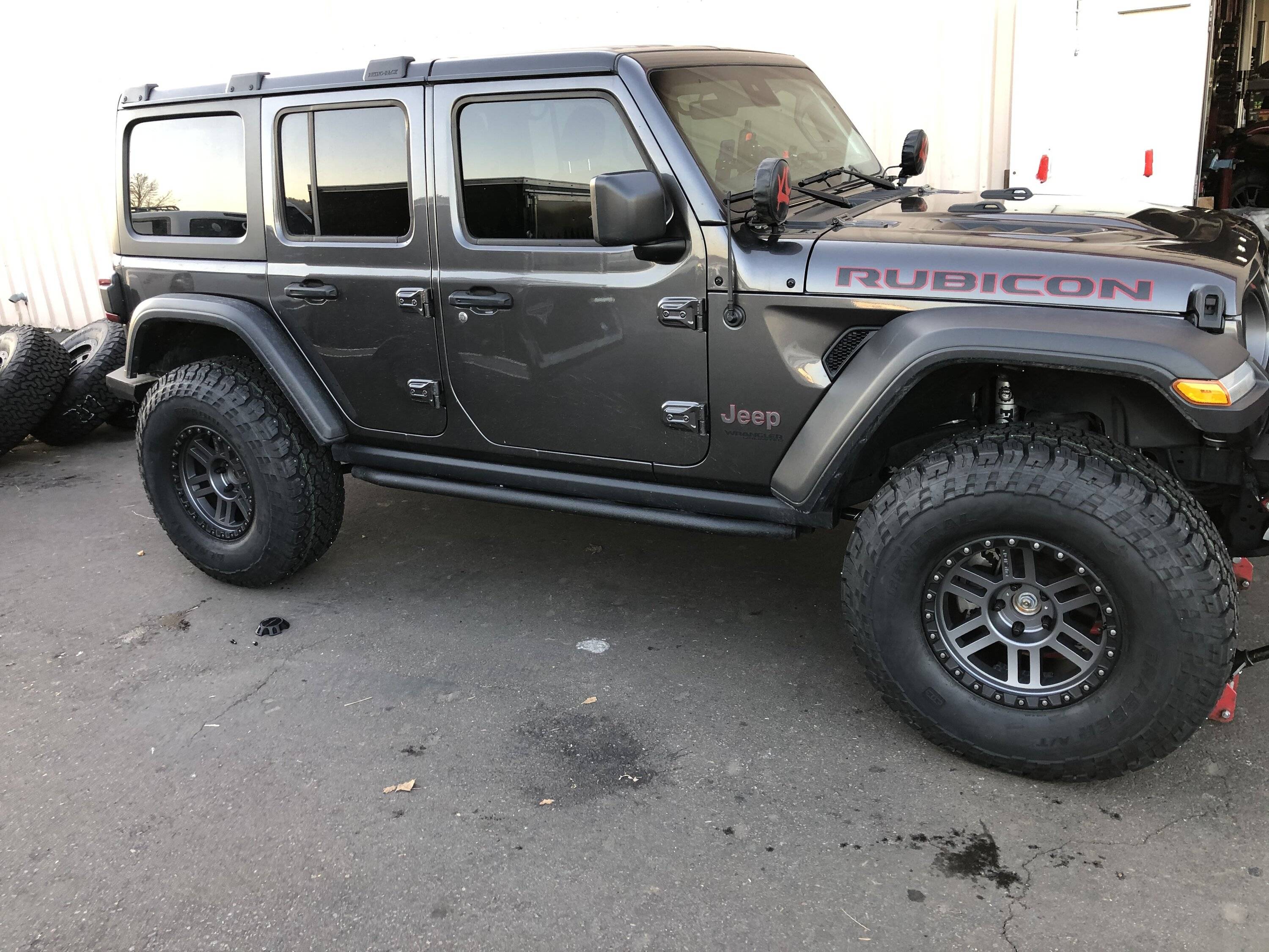

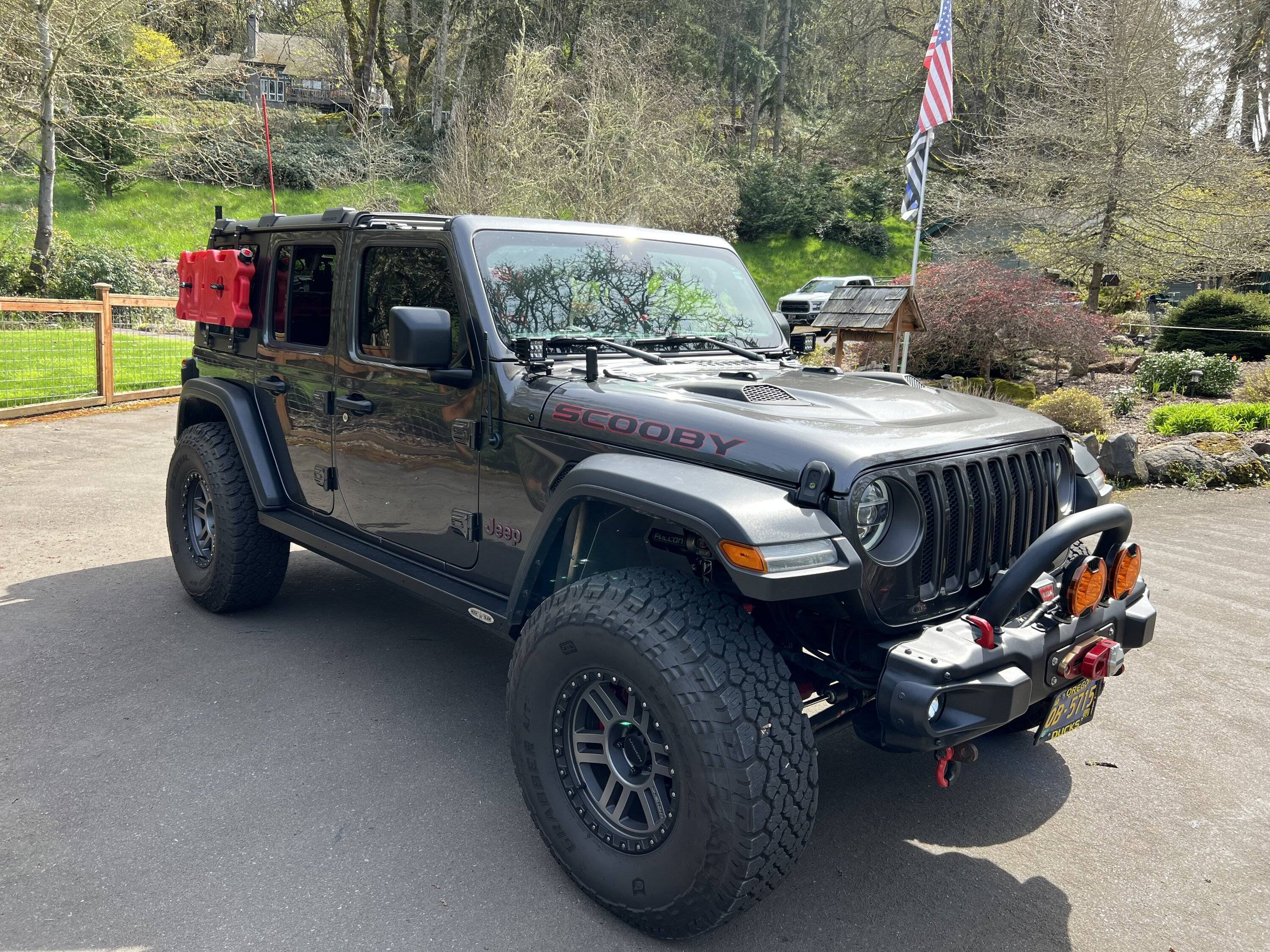

I thought it might help to show a picture of 37s* on a 2” Mopar lift -which nets closer to 3” than 2”.
Jeep Wrangler JL 37s too big for DD? IMG_5764
Jeep Wrangler JL 37s too big for DD? IMG_2693

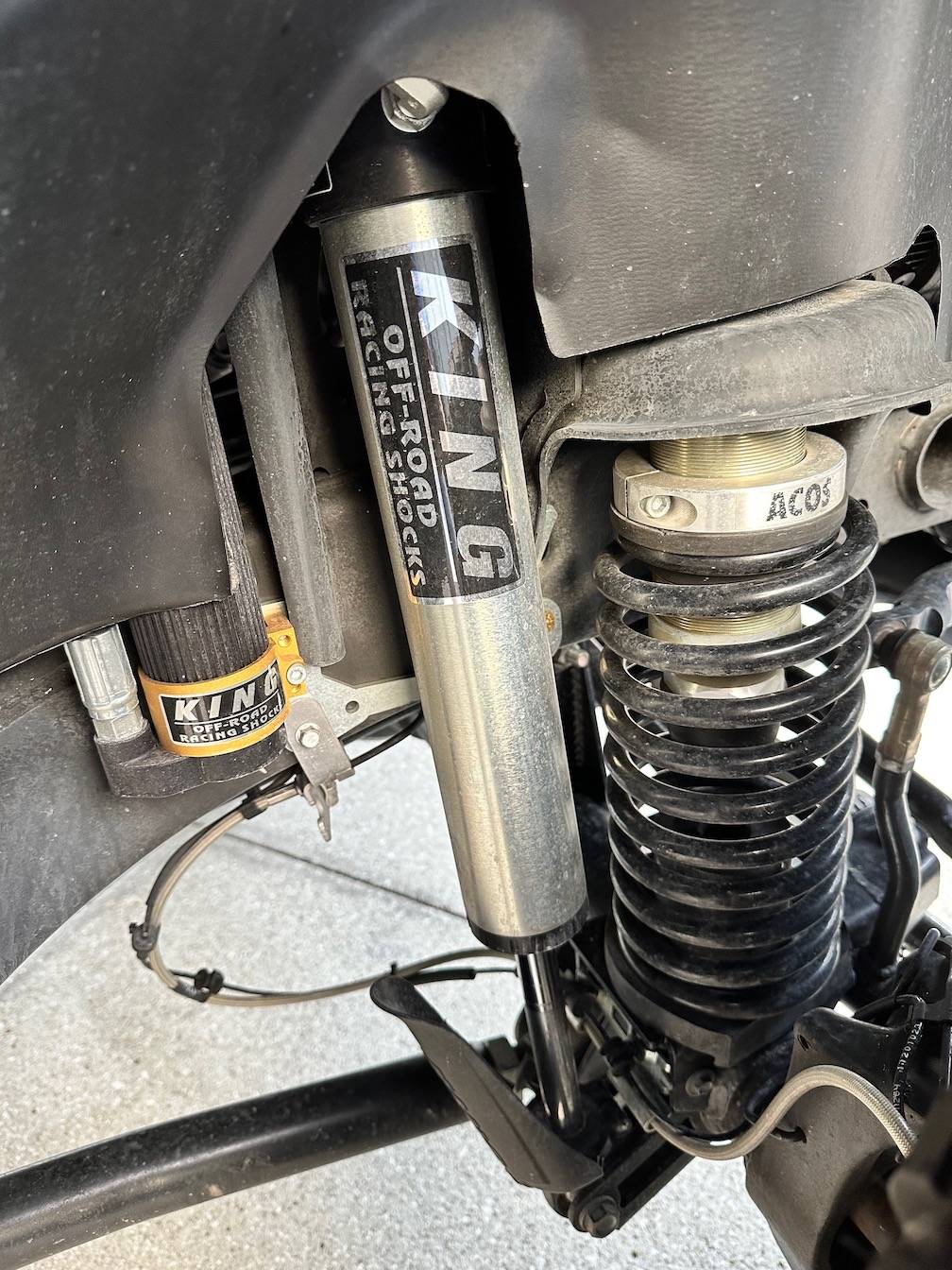

I drive daily on 37's (about 30 miles) and it's perfect. Started with 35's and a 2.5" lift (lower COG and less issues with pinion/caster), then moved to 3.5", 37's and re-gear. There are some considerations with 37's, more rotational mass/weight and torsional stress/wear on the steering & drivetrain plus more tweaking for caster/pinion, and always issues with leveling. Unless you have a 1 in 1000 Jeep you're going to have to add spacers somewhere to level out your ride. (Not a big issue but still something else to deal with)
I have a 2020 JLUR/3.6/auto, 3.5" lift, 37's and 4:88's and as mentioned, it's perfect for where I live (20' above sea level and a road trip to any destination). If I were at higher elevations or could do more climbing I would have gone 5:13's. IMHO it's dependent upon your environment and intended use, for 35" tires either 4:56 (probably closest to factory settings) or 4:88"s. For 37" tires, either 4:88's or 5:13. I will say that if I had a MT then I would probably go with 5:13's instead of 4:88's (with a JLUR you're not going to see that much difference on the trails between them since you'll be in the lower range anyway, but on the road you may see/feel the difference).
On the tires, it's up to you. I've run both MT and aggressive AT's on the road, find what you like and stick with them especially if they balance and handle well. (Again your environment should dictate what you use, myself I'm super happy with Nitto Trail Grapplers)
As I mentioned, I started with a good lift where the kit (control arms, etc., etc.) allowed adjustments for either 2.5 or 3.5 springs. After going to 3.5" and getting all my adjustments set (caster at 6.2), I added a bunch of MC spacers to level my ride but had to add more due to settling and sometimes added weight. After doing this, I stopped the madness, went back to 2.5" springs, removed all spacers and added adjustable coil spacers (ACOS from JKS or King) to the front and back. These add an additional 1" before adjustments, so I was back at 3.5" (2.5" Springs + 1" ACOS) and now I can adjust very easliy for ride and I was able to remove all the spacers (less pieces less problems?).
