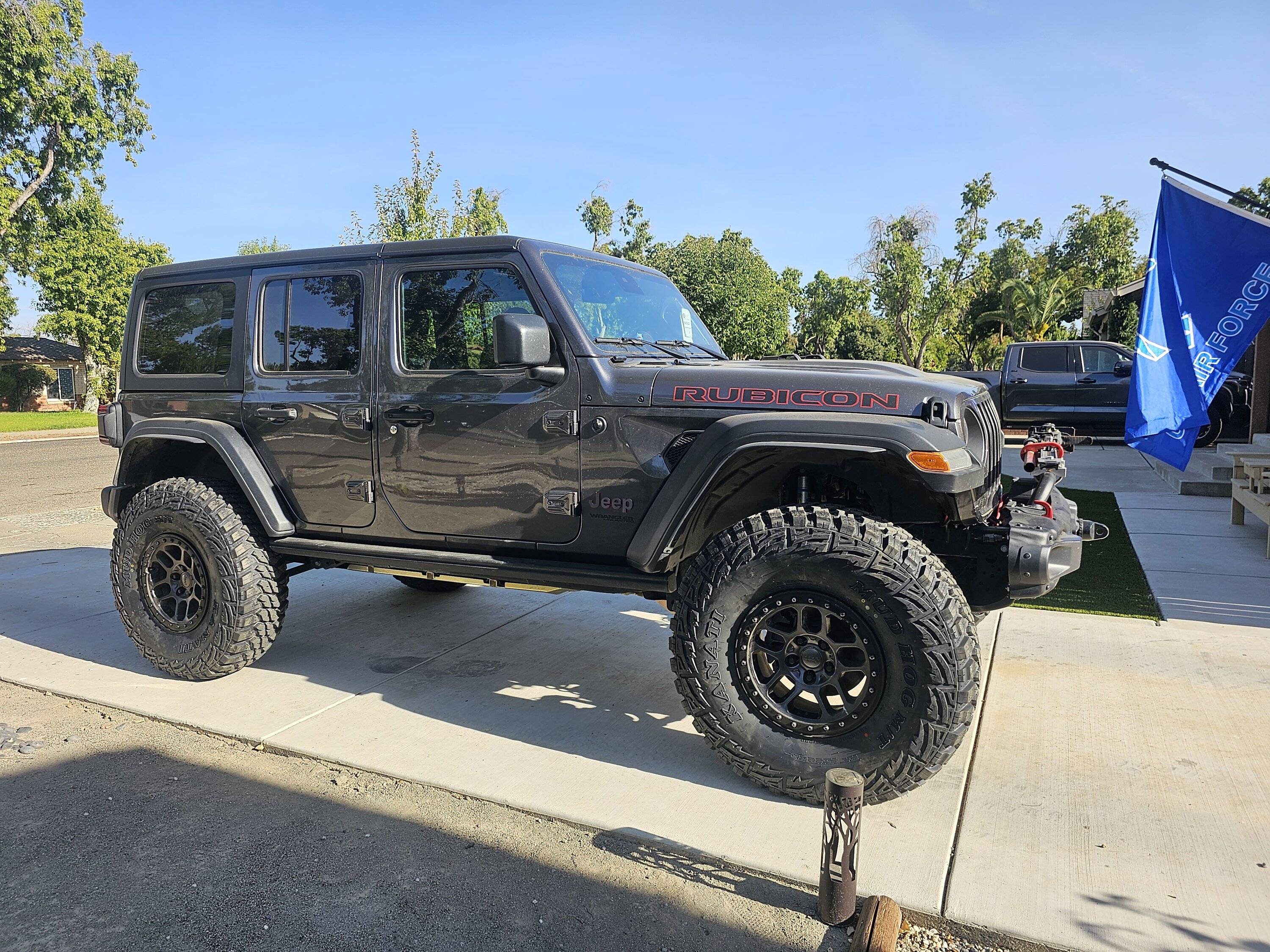

The wife's daily drive is about the same as yours and she does it on 39s and metalcloak 3.5" lift. It's an XR si 4.56 gears and the auto. Never felt a need for deeper gears. MPGs went from 14.1 average on stock 35s and 3.5" lift to 13.1 on 39s. I'll gladly give up that 1 mpg for an extra 4" of tire but to each his own. We regeared the last one all the way to 5.38s on 38s and it was terrible on the freeway and didn't gain much around town. Go with your gut and don't hear too low on my experience. You still have plenty of crawl ratio on 4LO. The idea that you get some kind of advantage anywhere but initial takeoff is lost on me. That's what downshifting is for. 4.88s in 5th gear is the same as 5.38s in 6th and so on until you get to 1st gear. I guess if you do primarily stop and go driving and never drive freeway speeds there no harm in gearing too deep but I'd much rather be able to drive down from Tahoe at 80mph at under 2k rpms personally.
