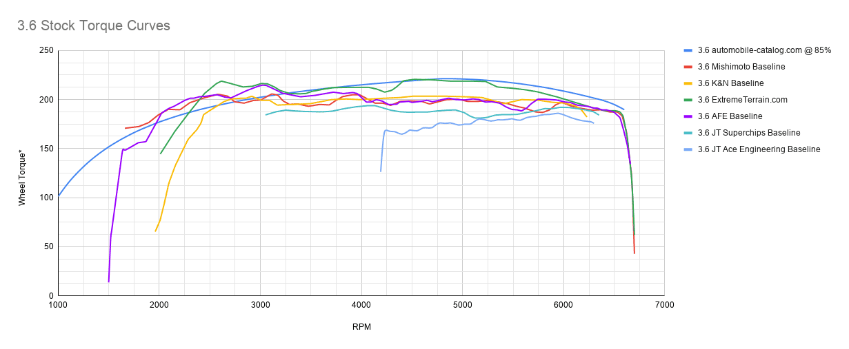

I've was wondering how all the aftermarket baseline dyno curves compare to each other, and found a neat website that lets you convert images into CSV data www.graphreader.com. So with some work, I've collected some baseline 3.6 dyno charts and plotted them out together.
Some observations:
  • automobile-catalog.com provides engine torque that has been estimated by a computer. I'm not sure how they do this, but I found that factoring 85% for drivetrain losses puts it about in the correct spot. Unfortunately the curve doesn't really match all the other data.
  • Some plots don't look accurate below certain RPMs, and should probably be ignored
  • not all dynos measure power equally

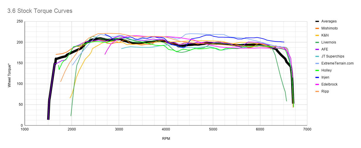

Update: I did my best to get a realistic average of all the curves. The max torque is about 210 lb-ft, with above 190 lb-ft from 2250-5250. This is equal to roughly 19% drivetrain loss from the published 260 lb-ft at the crank. Here's what I took into consideration when making this average:
  • Ignored the computer generated data from automobile-catalog.com
  • Ignored the unrealistically steep sections at the beginning & ends of some of the pulls (ExtremeTerrain.com's & K&N)
  • Smoothed out minor bumps & dips from where certain data starts & stops

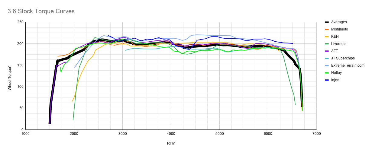

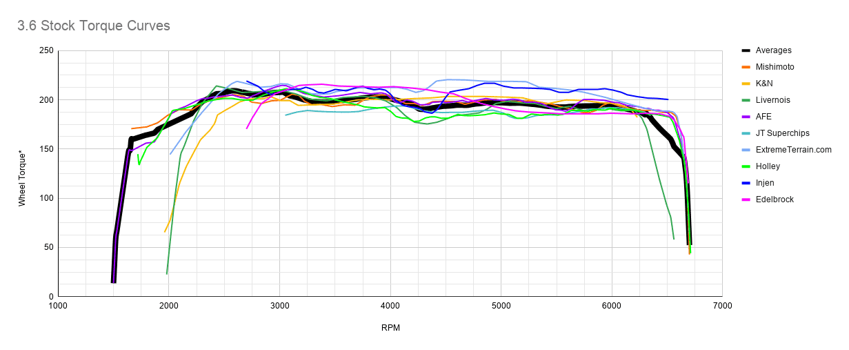

I found a couple more baselines to add: Holley & Injen. Holley's baseline was lower than my estimated average and Injen was higher, so I decided not to re-calculate the average at this time.
Jeep Wrangler JL 3.6 Torque Curves 3.6 Stock Torque Curves
Updated Sources:

I must say, I am a happy owner of the 3.6, but man the TQ and HP of the engine kinda suck on paper, number wise, especially in the 2000-4000 range where the 8 speed auto tries to keep the truck during most driving (2000 most times on mine unless I get on it). Peak HP at 6000 rpm's is not much use to me in a Jeep.
Now, I know the curve is nice and steady, flat, etc., but it just seems a decent V6 in 2021 should be more like 300 HP and something close on TQ at the crank, and in the more usable portion of the rev range. That would be like 255 HP at the wheel more or less. Oh well.
I never can understand why, same engine with a different intake, maybe ECU programming on another FCA product like the Challenger or Ram is 305 HP. Why neuter the Wrangler like that?
Not only sucks on paper but in actual use. The Pentastar is such a gutless engine at lower rpm. Should have never been in a Wrangler but it was better than the 3.8.
