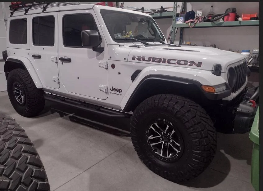

We put 37's on out 'x' without any problems.
Here is a picture of it on dealer lot before we picked it up.
Jeep Wrangler JL 2dr LCG Build 1748439577363-b9
And here is a picture of it after taking it to Discount tire and puitting 37x12.5 r17's on it without any additional lift changes.
Jeep Wrangler JL 2dr LCG Build 1748439608643-a

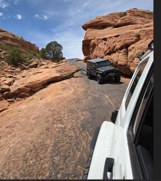

Last week we went to Moab and ran Hells Revenge. No real problems at all. There is small area in the right rear wheel well that rubbed just a bit. I had to really look to find it.
Jeep Wrangler JL 2dr LCG Build 1748440458091-r8

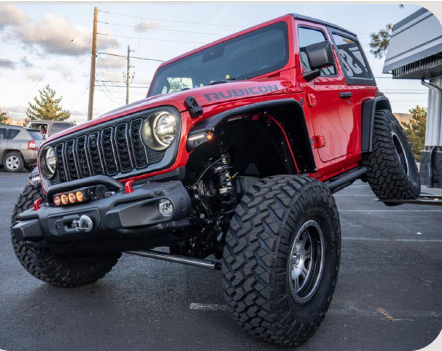

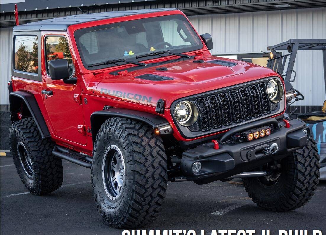

On the other hand our 24 2 door with the mopar 2 inch lift does articulate better. But we do'nt need this type of movement in a daily driver.
Jeep Wrangler JL 2dr LCG Build Flex 2
Jeep Wrangler JL 2dr LCG Build Flex 1
