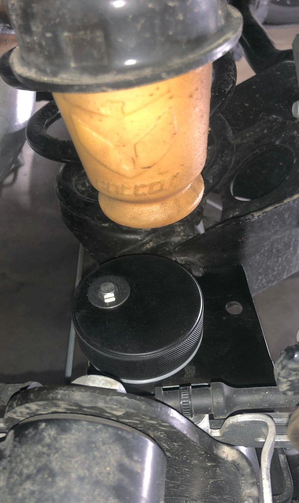

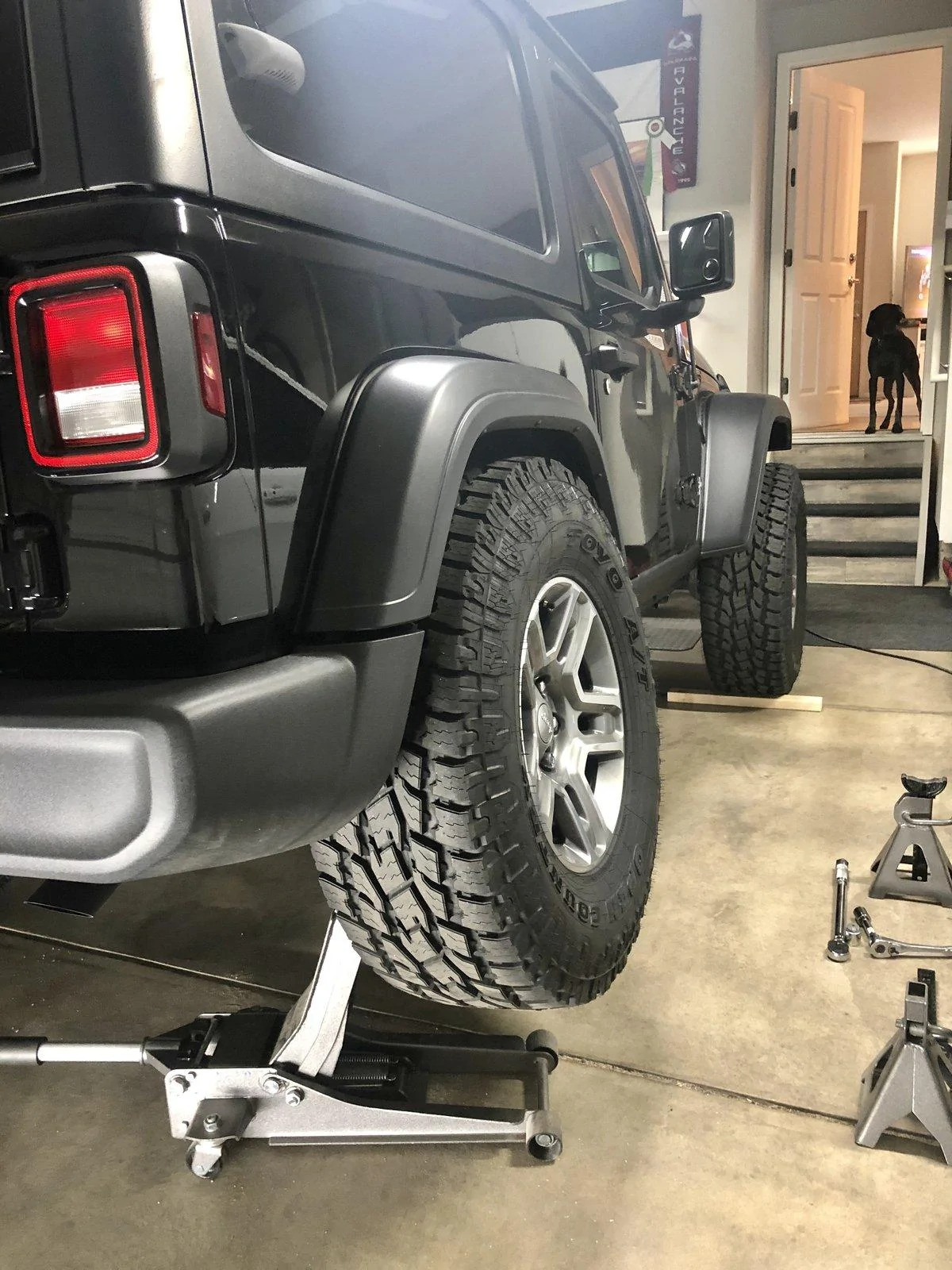

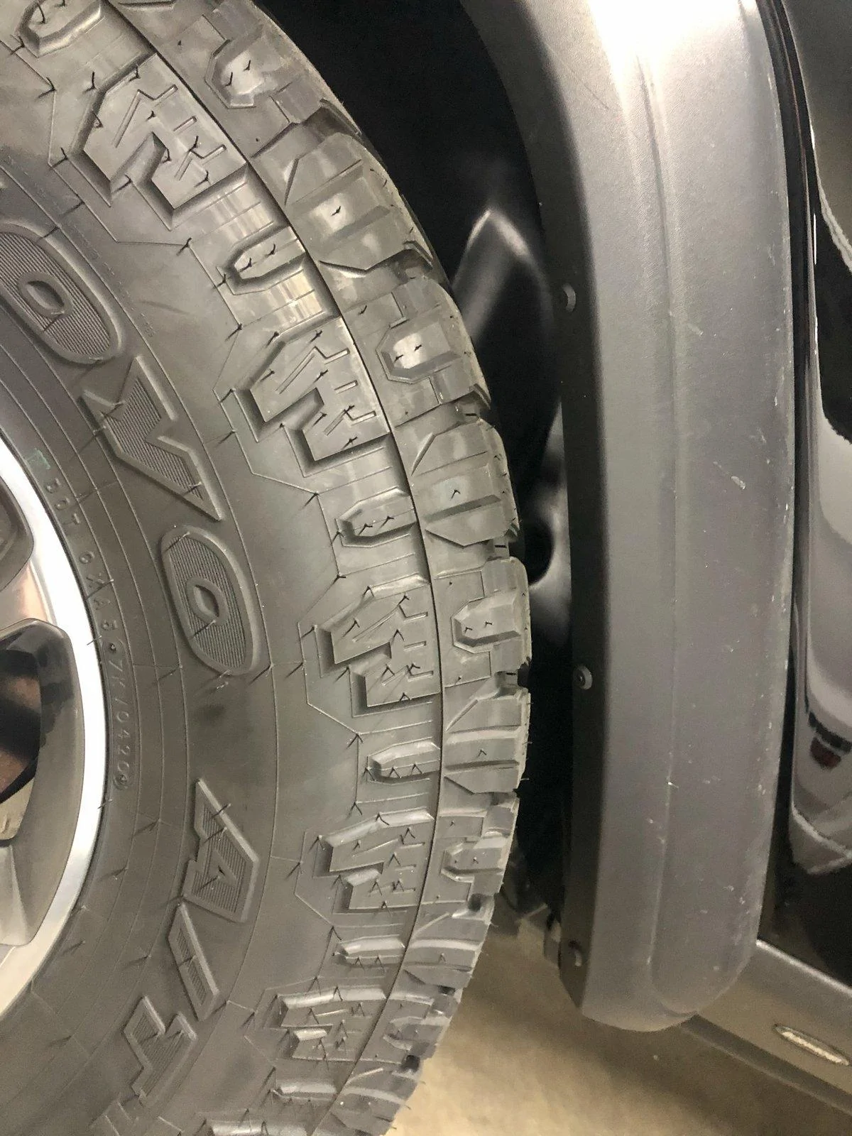

Ended up using the 1/2” teraflex spacers stacked to 1” on all four corners and also added the falcon bump stops. Did the “hockey puck mod” on the rear to add an extra inch to the bump stop to keep the fenders in place. The front didn’t contact so I’m fine there. Here is the final product I love the way it came out hopefully this helps someone.
