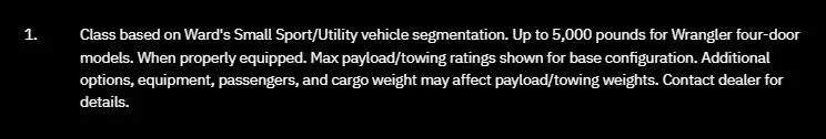

Jeep advertises 5,000 lbs
Jeep Wrangler JL 2024+ Towing Capacity Question 1720909978326-yk

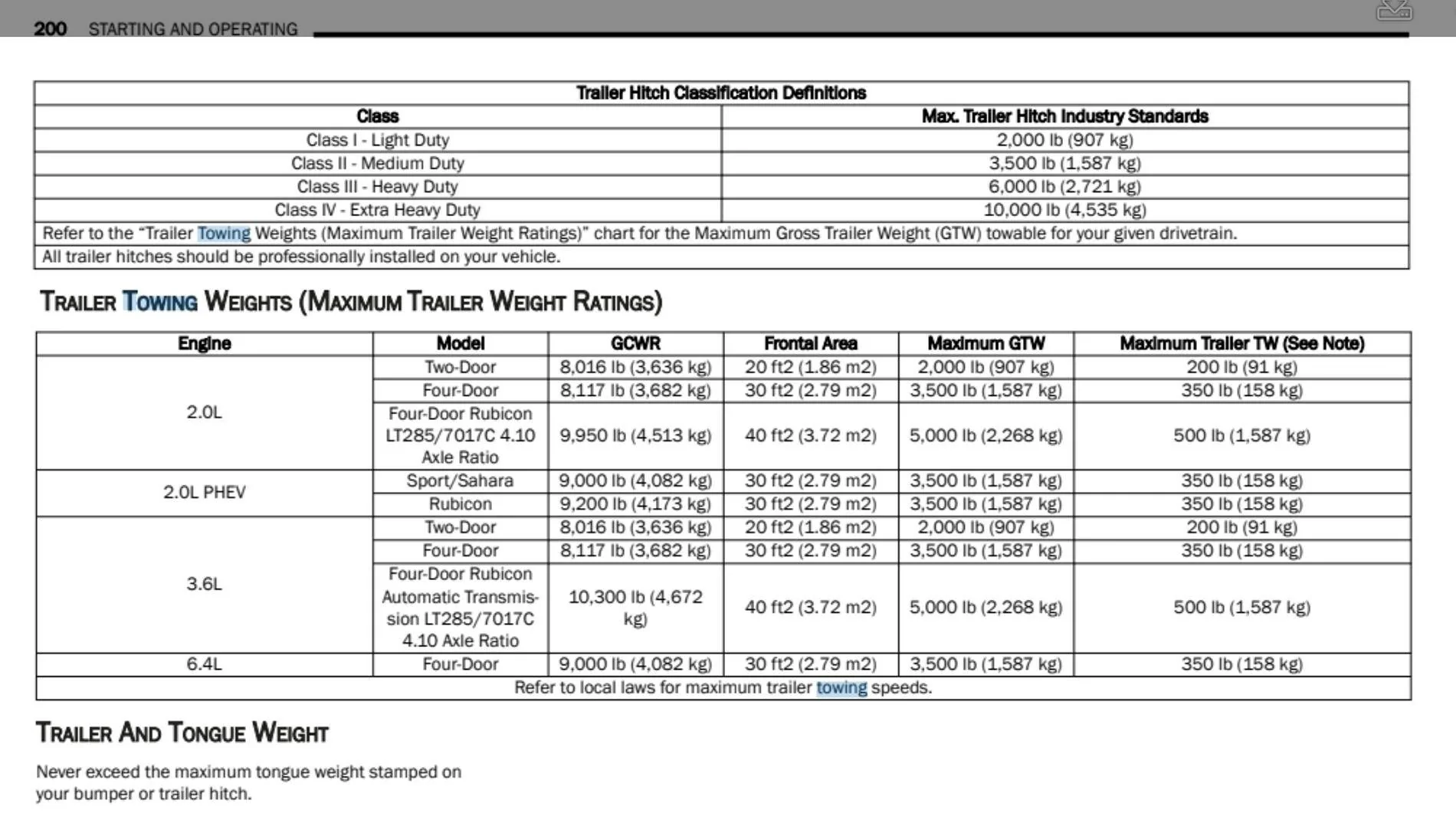

Per manual it is 5,000 lbs when properly fitted with class 3 hitch:
Yes it does, but notice the little "4" next to the 5000. Somewhere there is a note that explains what that "4" means. It could mean the 392, could mean the Rubicon with 4.10 gears... I wonder if towing 5000 pounds with my Rubicon with a 6-speed manual transmission will affect the clutch??? ;)

No look at the next chart, which shows both the 2.0 and 3.6 support 5,000 lbs.
The 4 link is (which has been changed to a 1:
What makes you think the chart shows that both the 2.0 and 3.6 support 5k pounds? "Up to" very much implies that not all of them do.

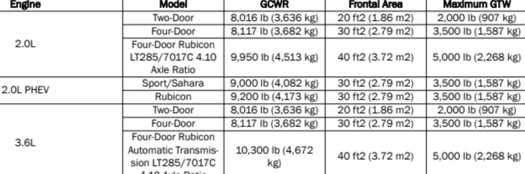

Because the chart says so,, Maximum GTW is 5,000 lbs for 2.0L Rubicon and 3.6l Rubicon:
Now the question is, does anyone have a door jamb sticker with a GCWR of 9,950-10,300lbs? If yes, then all they need is the proper hitch to LEGALLY tow 5k lbs.
