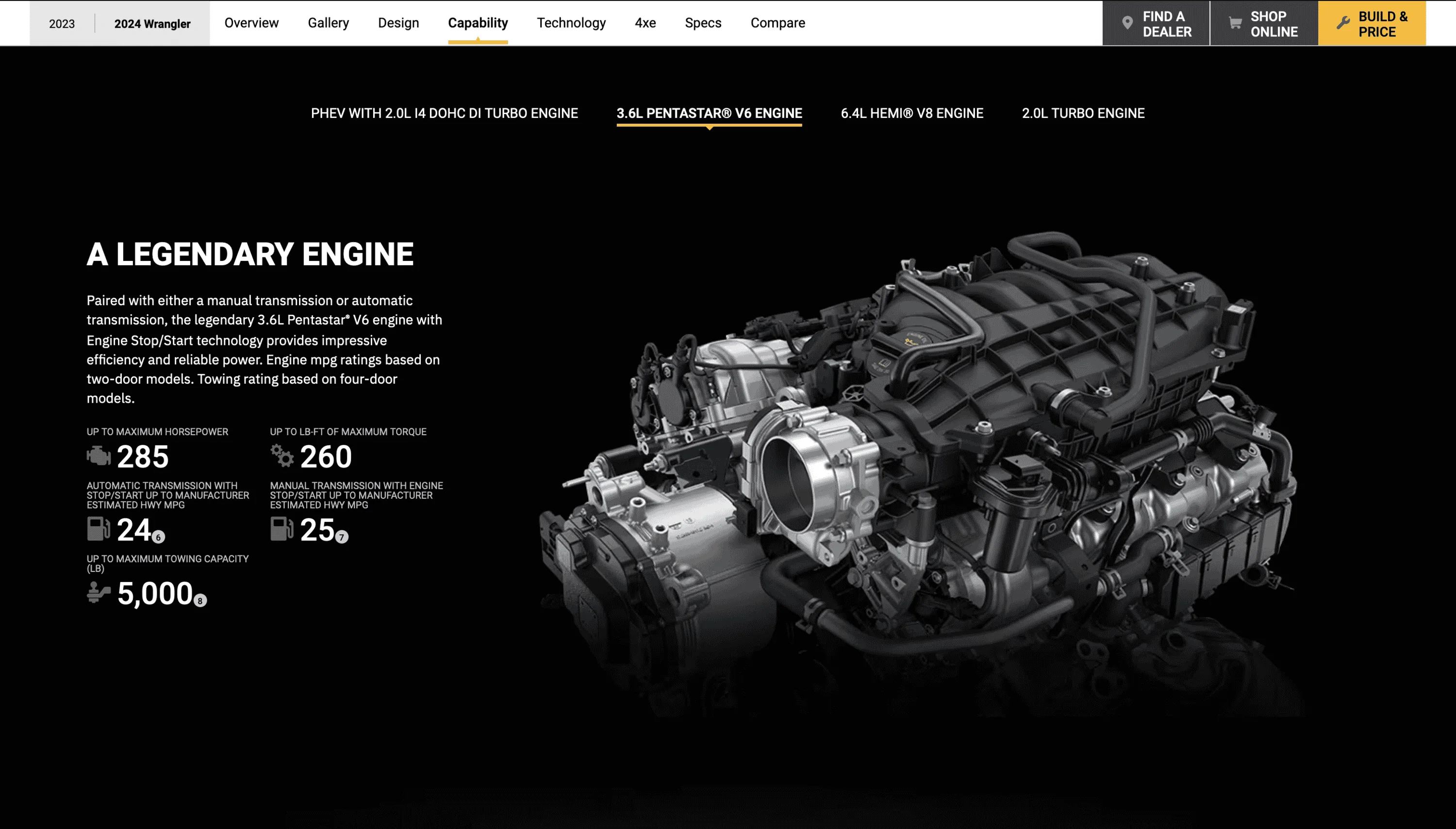

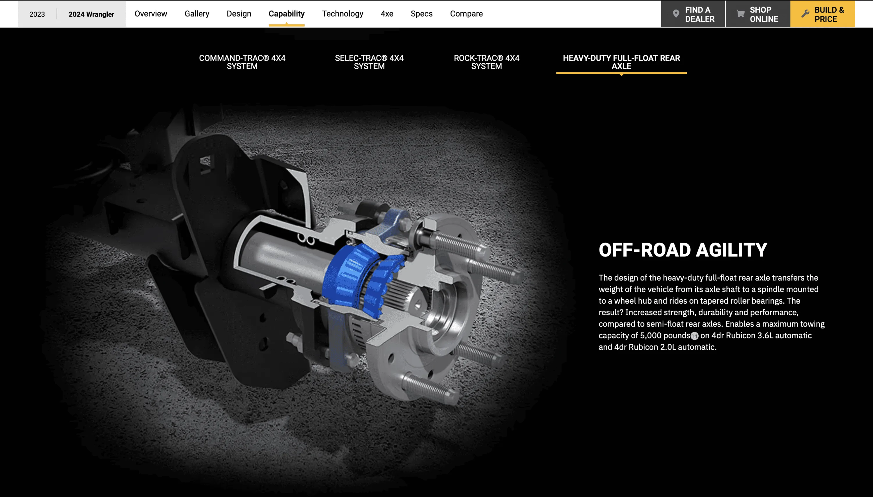

For the benefit of others performing the same search -
TLDR - I've found no evidence of the 2024 JLUR actually supporting a 5000lb towing capacity. Read on for information I've collected regarding the support and rejection of towing capacity claims.
I ordered a 2024 JLUR in August of 2023, accepting the "5000lb towing capacity" at face value from the marketing released last year. I accepted delivery February 6, 2024 and immediately started shopping pop up tent trailers for my family, still under the assumption that my Jeep was rated to tow 5000lbs. Thankfully I haven't made a purchase on a trailer, as come to find out my Jeep is rated at 3500lbs according to the information printed on the B pillar inside the door sill.
I started doing some key word searches on phrases like "what happened to jeep's 5000 pound towing capacity", "2024 JL towing capacity", etc, as well as scrounging YouTube on relevant reviews without discovering any valid information. The caveat for Jeeps "when properly equipped" for towing 5000lbs doesn't seem to exist. All combinations of Wranglers in 2024 seem to list a maximum of 3500lbs towing capacity.
Now for a collection of conflicting information.
- Official communication supporting the 5000lb towing capacity:
From Jeep's site (https://www.jeep.com/wrangler/capability.html), specific mentions under the
3.6L PENTASTAR® V6 ENGINE" section, as well as "HEAVY-DUTY FULL-FLOAT REAR AXLE" section (see attached screenshots)

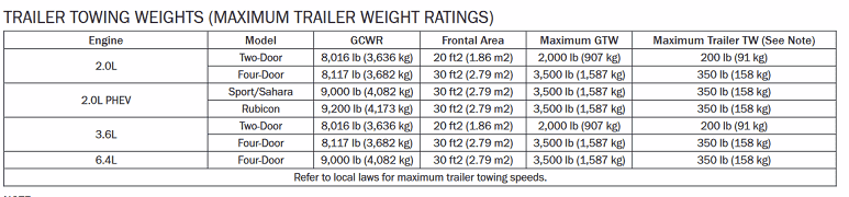

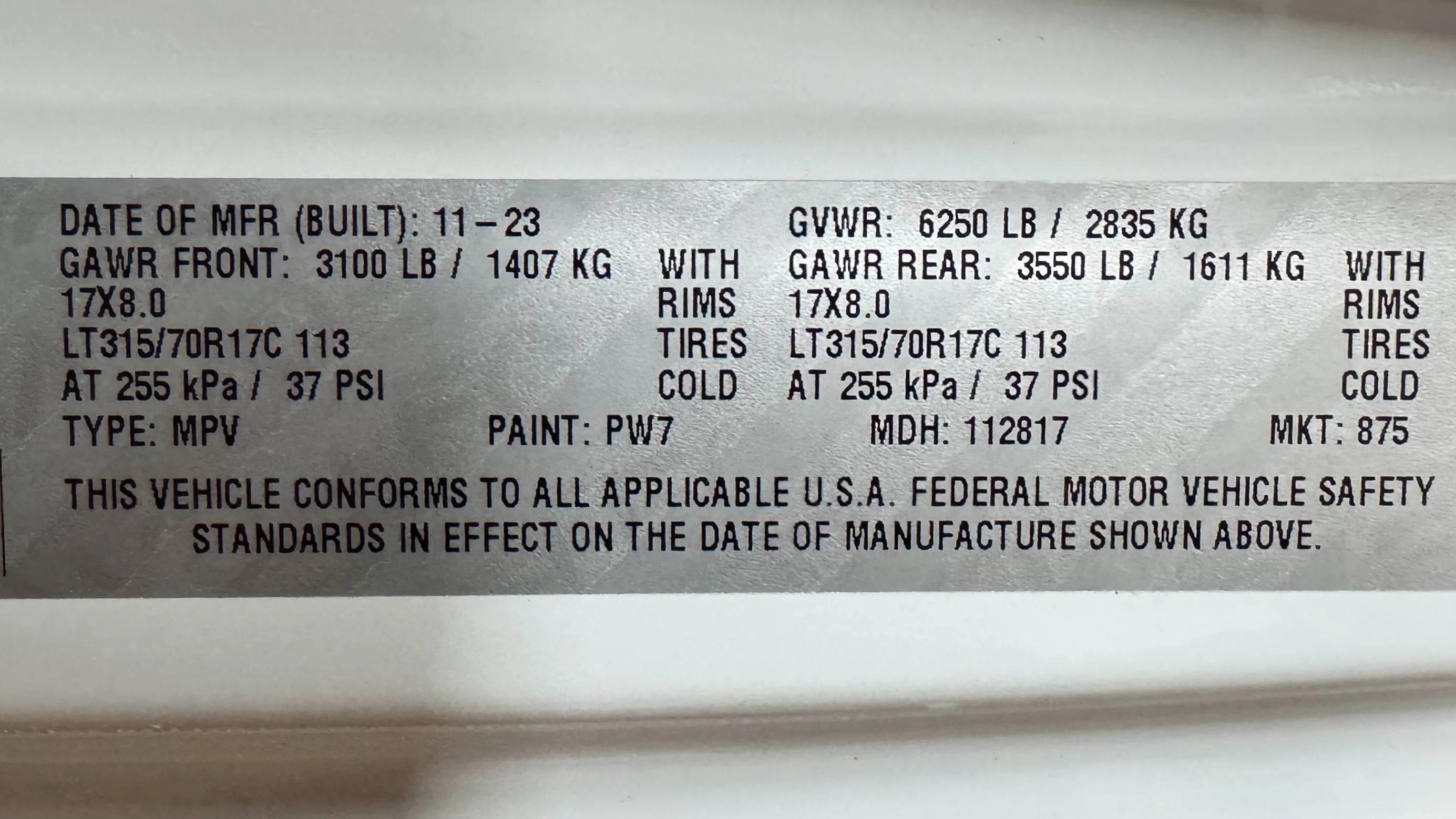

Contrast that to my manufacturer specifications that state 3500lb towing capacity:
- From the owners manual
Jeep Wrangler JL 2024+ Towing Capacity Question Screenshot 2024-02-13 at 12.38.33 PM
- From my 2024 JLUR Door Sill
Jeep Wrangler JL 2024+ Towing Capacity Question IMG_2257

The door sticker does not show your tow rating. The 3550 listed on their is the GAWR, which is the gross axle weight rating for the rear axle. The chart you showed from the manual is the only source of tow ratings.
