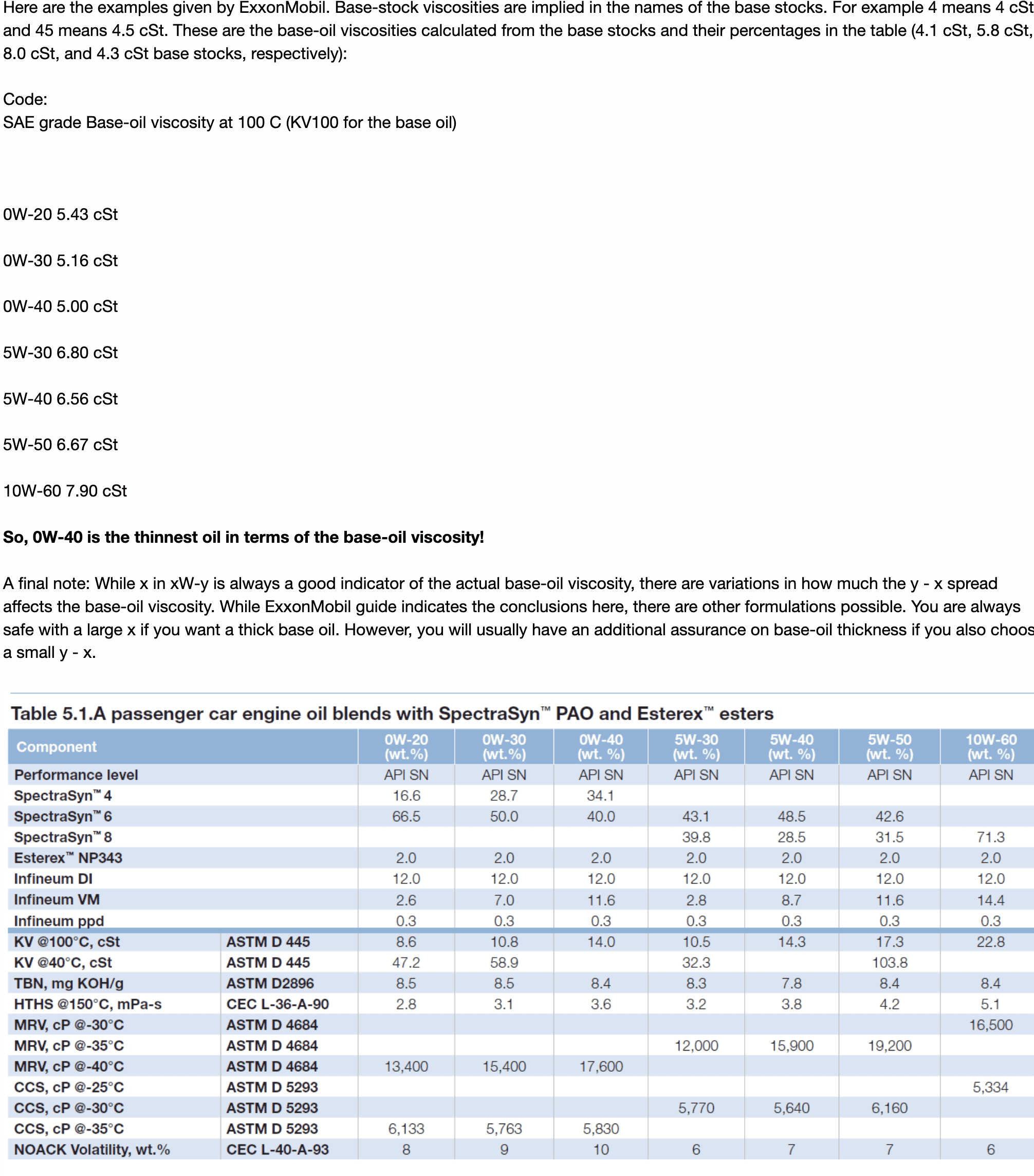

Another reason why I question if Ow20 is really what these engines were designed for, the hypothesis being too high of oil vapor being reintroduced via the PCV system reducing octane.
The NOACK volatility is lowest with 5w30 until it gets to 10w60 where it is the same (6).
https://bobistheoilguy.com/forums/threads/do-you-think-thats-thick-oil-think-again.286877/

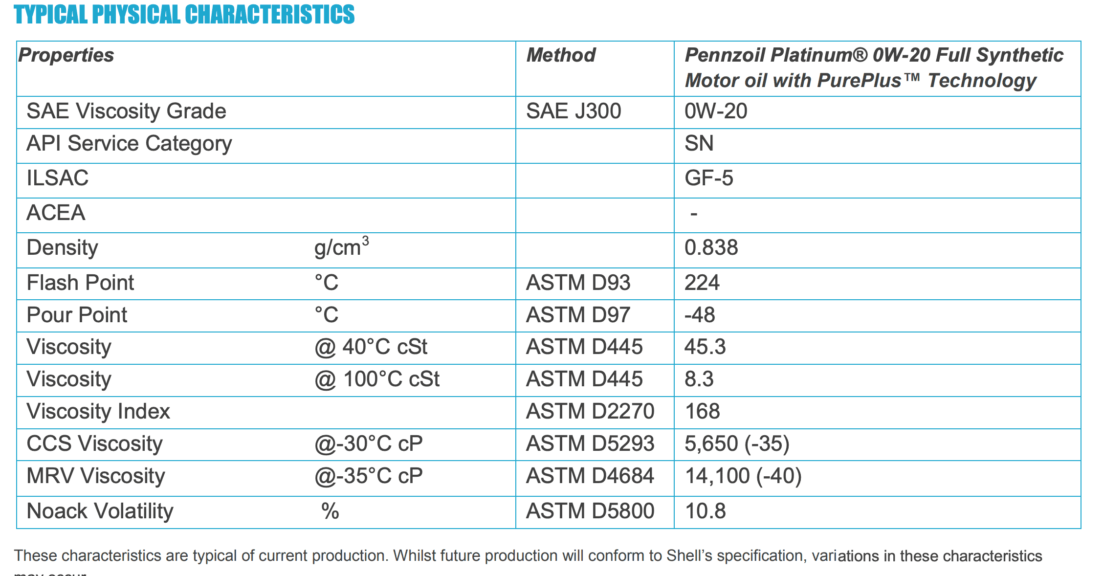

Pennzoil Platinum 0w20 has a higher NOACK volatility 10.8 vs 8 with some other synthetics. This is what my dealer uses for synthetic. Personally, I would avoid it, particularly if seeing oil temps 230+ F as in off roading/towing.
@Willys41 has shown lowering the temps significantly reduced amount of oil emulsion caught in the catch can. I would think oil volatility would be a large factor in that equation.
https://petroleumservicecompany.com/content/pdfs/PZL_PLAT_0W20_TDS.pdf

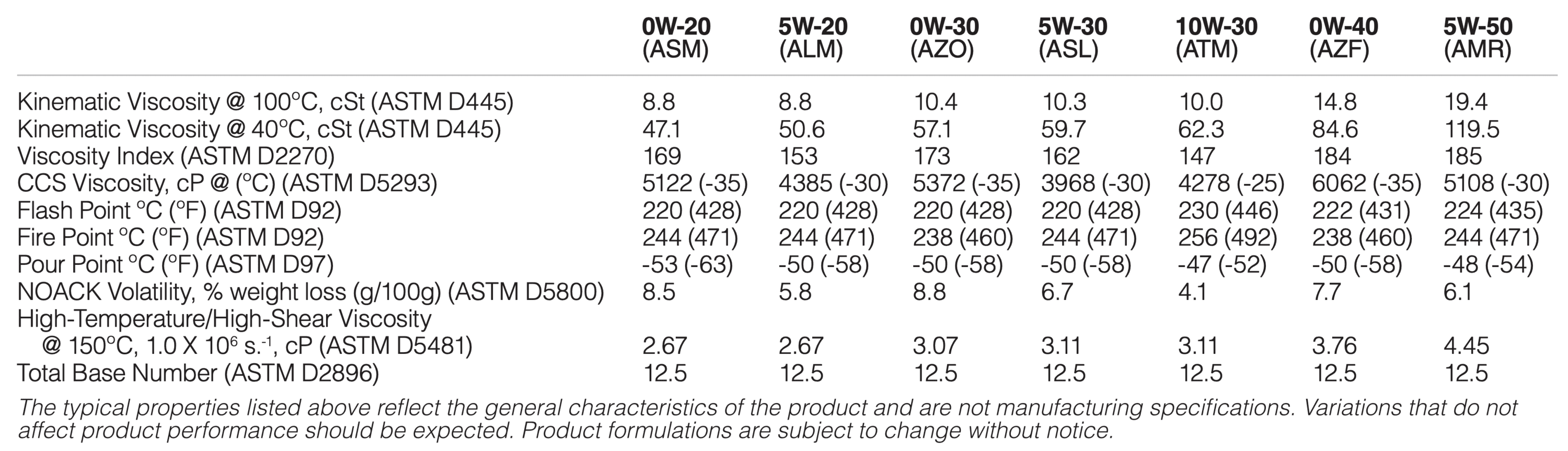

I agree. I also have some suspicions in the way oil is tested and rated, and if it is designed to benefit the CAFE narrative.
If we compare oil data across different weights there are a few things that make me wonder. First off, everyone seems to be (overly?) concerned with cold starting/increased start-up wear which coincidently happens to support the overall adoption of lighter viscosity oils. Taking a look at this data for example, the cold crank simulator (CCS) has a lower cP at 4278 for 10w30 vs 5122 for the Ow20. The difference is the former is at -25 C and the later is at -35 C. Those are extreme cold temps that most of us will never see.
Similarly, if we take the kinematic viscosity of the 10w30 at 40 C of 62.3 cSt, that's not much higher than the 0w20 of 47.1 cSt. Furthermore, if the engine was at a higher temp, say 50-90 C, even the 5w50 could potentially have a lower cSt than the 0w20 at 40 C.
It wasn't that long ago in North America when the OEMs recommended 10wX for temps above 0 F and 5wX for below 0 F. Have tolerances decreased so much to warrant 0wX year round? In some cases, they recently recommend that in global markets depending on the engine and manufacturer.
Getting back to the 3.6l Pentastar, from the OEM's perspective, for light duty, passenger applications perhaps lighter oils are appropriate for that market to maximize efficiency, but in higher load applications such as the Wrangler or RAM trucks, working at higher loads, and for a market that generally cares more about longevity than efficiency, then higher viscosity might be more appropriate.
I am not sure what the safe/optimal upper limit is but the fact that the Maserati 3.0 V6 and your friend running xW40, coupled with the generally lower volatility associated with heavier oils, is encouraging for the adoption of higher viscosity oils.

Appreciate your thoughts on this. On what is a "safe" upper limit (of viscosity) I don't think that's an issue, as long as you're within cold start limits for the "w" rating.
Regarding "tolerances", let's use the correct term, lest the layperson get the wrong information. We're really talking about clearances (or gap), mainly between the pressure lubricated bearings of the crankshaft main bearings, rod bearings, and camshaft bearings. Most of the other parts like the rockers and camshaft lobes, rely on splash or spray lubrication wetting and film strength and thickness. For the layperson, "tolerances" are production allowances in dimensions, torques, etc. (e.g. the blueprint specifies 2.5000" - 2.5005", meaning the dimension can only vary 0.0005", and only between the specified sizes), 0.0005" being the tolerance of that feature.
