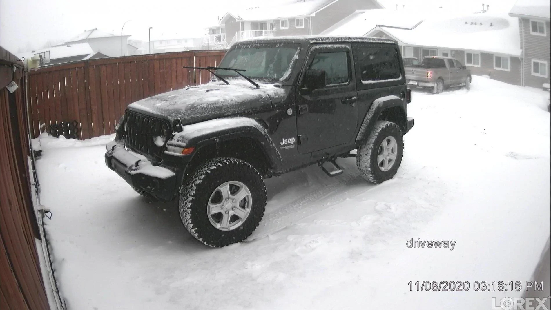

Well my ko2 seemed to be ok but the wipers were not. Big blizzard storm today went for a drive to see how it handles snow, had to get out twice to clear wipers and barely drove anywhere, not sure of factory blades are crap for winter and I need to buy a better set or it's just the flat windshield.

I think it's the windshield and the defrost vents from what I've been reading.

Are winter blades locally available? They're usually shrouded in a thin & flexible rubber. This design does serve to mitigate snow & ice buildup which would adversely affect the wipers' performance.
Yes also to the known issue with the airflow through the JL's defrost vents.

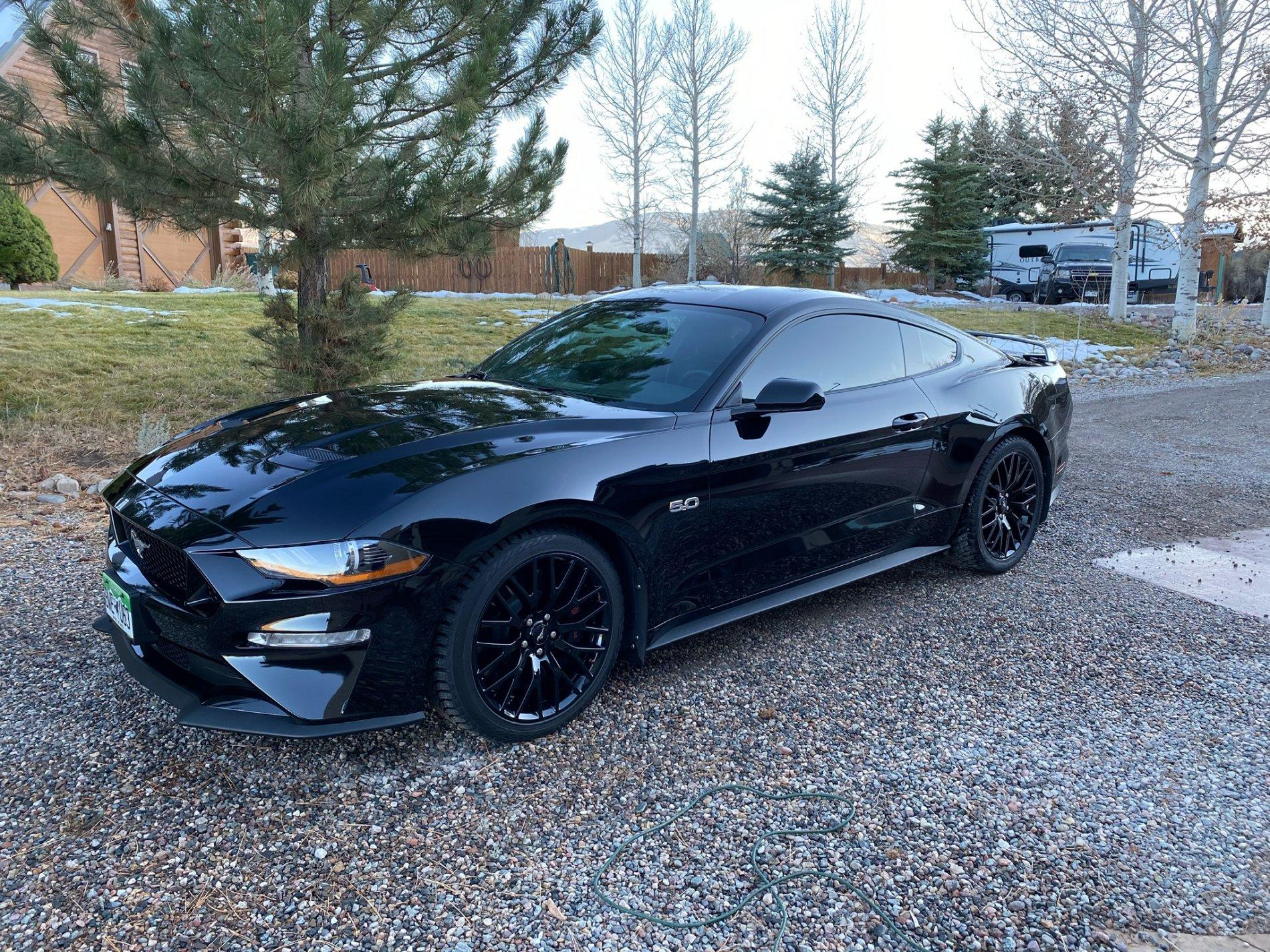

I just drive my daily beater in the snow. It’s got studded Hakkas

TFL posted a video last week complaining about the crummy windshield defroster on their JT.
