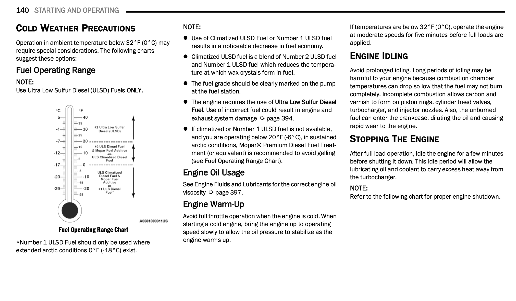

Capricorn
Apr 1, 2018
30
952
804
Las Vegas, NV
2024 JL Willys XR V6
Network Architect & Engineer
From the owner's manual:
Jeep Wrangler JL Would not start, cold morning 1670264056683
Deleted member 59498
Guest
I put the owners manual on the engine cover but it still didn't start.
