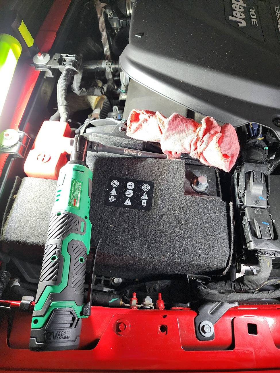

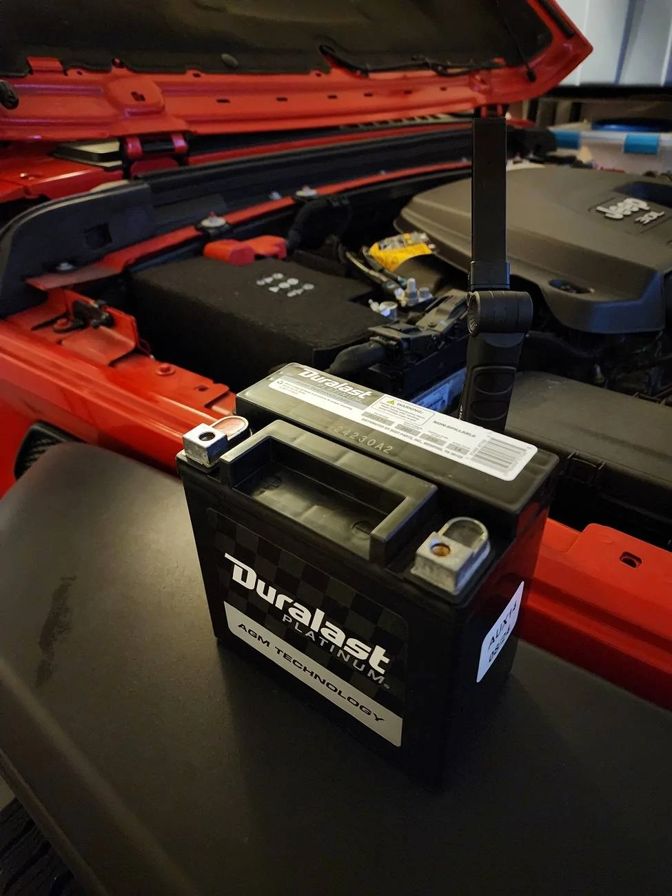

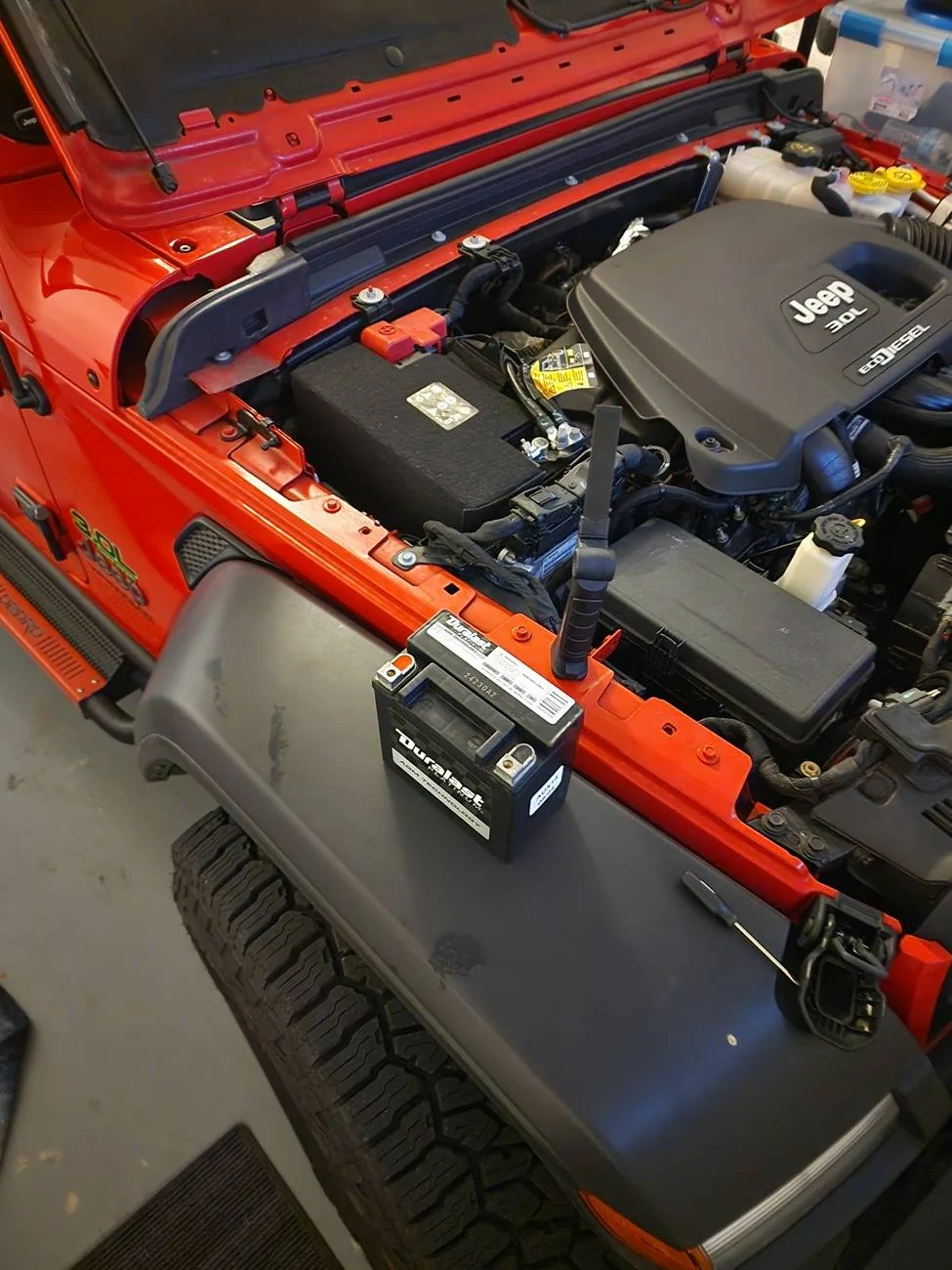

Hey there 👋
If it is Aux. However, keep in mind that many other factors go into the start stop functionality, like temperature, is your AC on? Etc etc. Also, as mentioned previously hood latch. Possibly bypassed by previous owner etc
Lots of reasons it wont function.
Saying not available is different than "not available charging"
Mine kept saying "not available charging" and hadn't worked in months, plus it was still factory, so it was time.
If it is the Aux, then us Diesel owners have it easy. Aux is directly below Main
Very easy to replace, see pics of mine that just replaced @ 42,000 miles
Best of luck, enjoy your Diesel 👍
