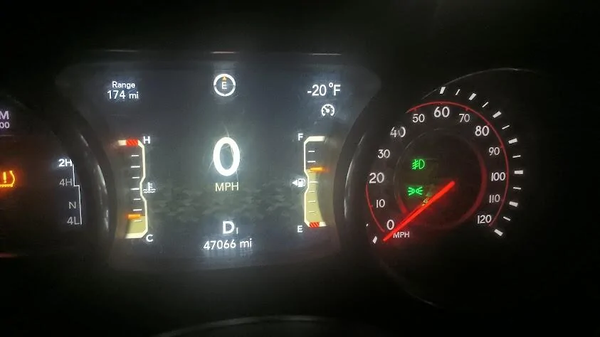

They definitely help! Sorry for your struggles. This was yesterday AM

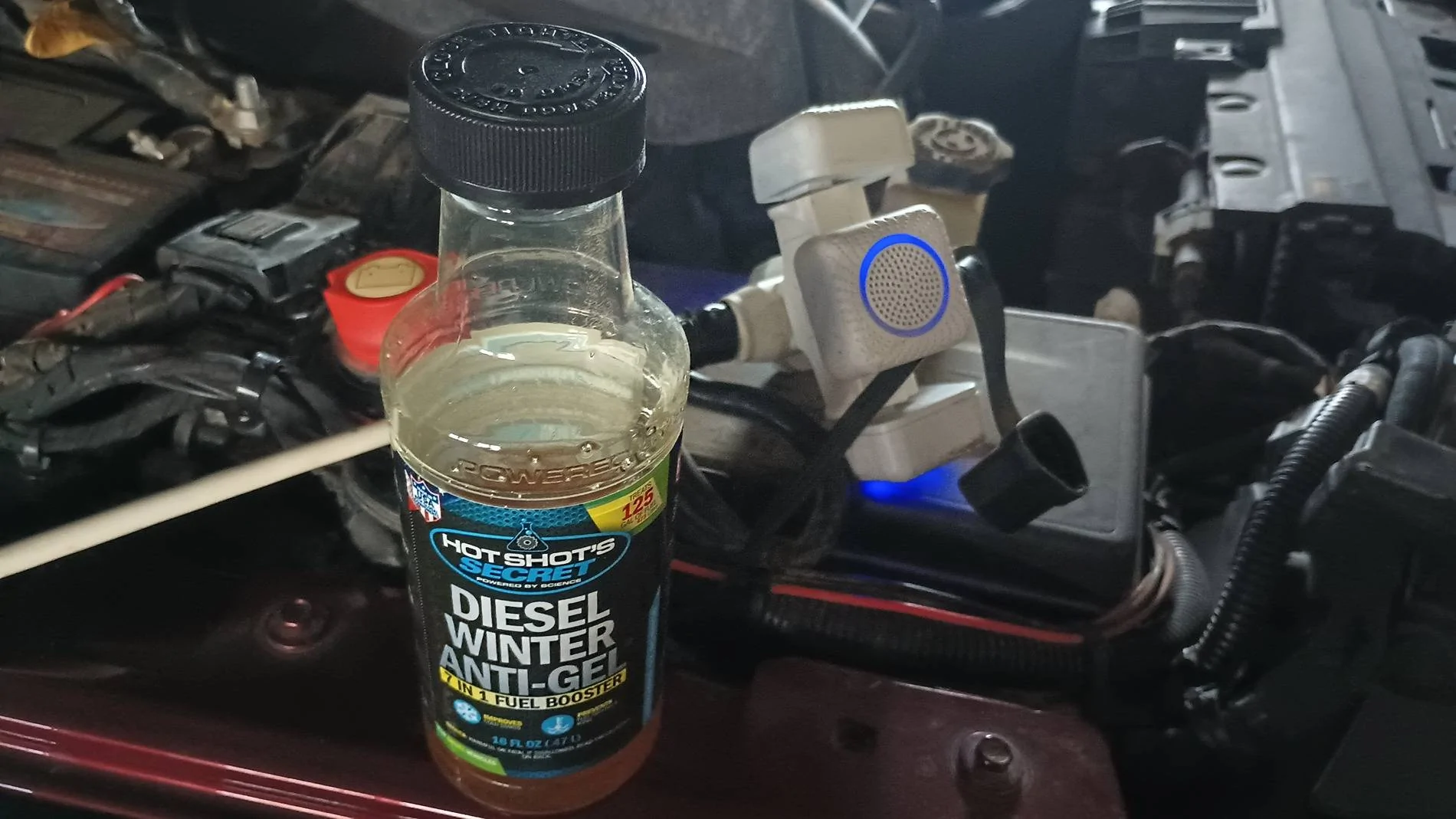

Are you all using an antigell additive for your diesel?

Power service 911 if its gelled. plug it in.
I have mine set (TPMS) at 25. It will kick off after a couple miles of my commute. I am curently using the following:
