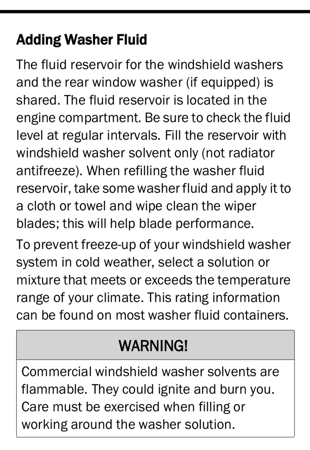

1500 miles and the washer fluid light came on. I’ve used the washer twice since it was delivered so I was curious to know why the light came on. I raised the hood and discovered the cap improperly seated and as a result, left the reservoir open and also nearly empty.
Here’s what the manual says:
Jeep Wrangler JL Windshield washer fluid. E3F53C21-6897-446A-94DE-C731A9C8F308

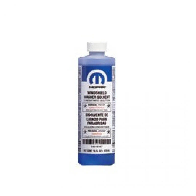

I went ahead and ordered a 32 oz bottle of the Mopar Washer fluid. The dealership charges $18.15 for the bottle. If not needed right at this minute, it’s easy enough to find online for $6-$10.
The part number is 4318068AC.
Jeep Wrangler JL Windshield washer fluid. FE318700-9AB4-4D42-9C48-A22B671B2DD5
I measured out 16oz and poured it into the reservoir. I then added 3L of water since the solution requires water dilution. Everyone else’s level may vary but mine was fairly empty and I wanted to keep the 1:4 part ratio.
The actual work took just a few minutes. Once filled it was slightly below the cap. And the cap does require a firm push to get it to seal properly.
