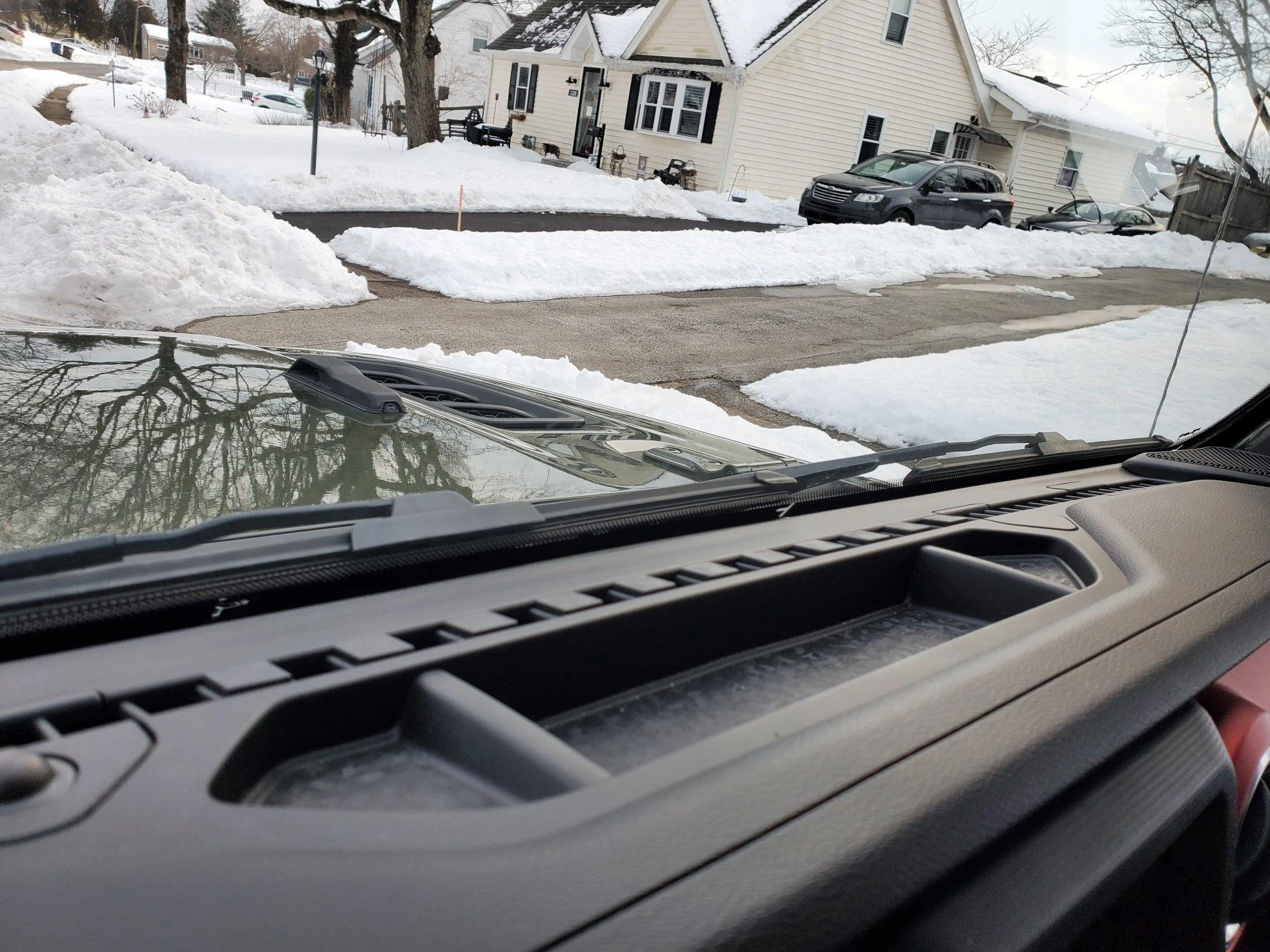

My 1+ hour drive home last night with heavy snowfall and temps around 9 F, I paid close attention to the defrost situation (I have not done the fix). The edges of the windshield definitely did not clear as easily, or stay cleared as easily, and there was a notable difference in airflow from the defroster between the middle and the driver's side end. Having said that, by simply turning the defroster on high when the edge was starting to ice up, it would clear pretty quickly.
So for me, the problem was more balancing the fan/temp speed to the minimum setting that would keep it clear. I have a crack in the windshield from the top, driver's side corner working its way down to the middle. If I wasn't trying to keep the defroster at a minimum to keep the crack from growing, there wouldn't have been an issue.
The short of it: it's definitely not even in how it functions and could use improvement. But I was able to get and keep the ice off the entire windshield without the fix. I may still end up doing it so that it works better at lower settings, though.

I received and installed mine today. I only used 10. There are 14 holes across the center of the windshield between the two bars of the middle dash tray. I tried installing 11, but they weren’t centered and my OCD was killing me. I left the middle two holes, then installed 5 plugs, using every other hole to each side.
I'm glad its not just me. I looked at that picture and immediately counted how many I would use to center it

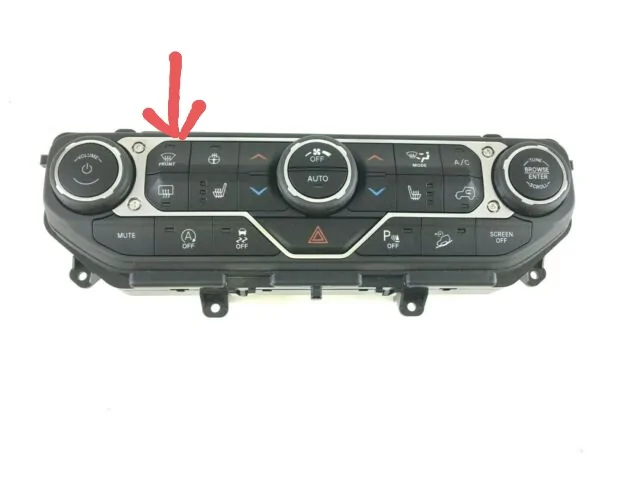

Are you missing a button? My dash has the defrost button right next to the stereo volume. I am missing the heated seats and steering wheel buttons.... :(
well, I’ve had my Jeep for 2 years and never used this button, always used the defroster/vent. I’m in central Texas now and we are in freezing temps. I used this button for the first time and what a difference.
Thanks Hounddog!
I was going to order the caps but it works great without now.

I wanted to verify for those of us struggling to defrost our windshields that this fix really does work. I ordered the 5/8 tubbing plug caps and plugged every other hole in the center portion. Now, the outer portion blows air equally like the center portion! Pics for reference and super easy! Thank you to everyone that has posted this fix, as a new jeeper, really appreciate it!
As I understand it, the black plugs go into the vent openings. But, what's the deal with the long black strip you have on top of it? Is that something you bought or made?
