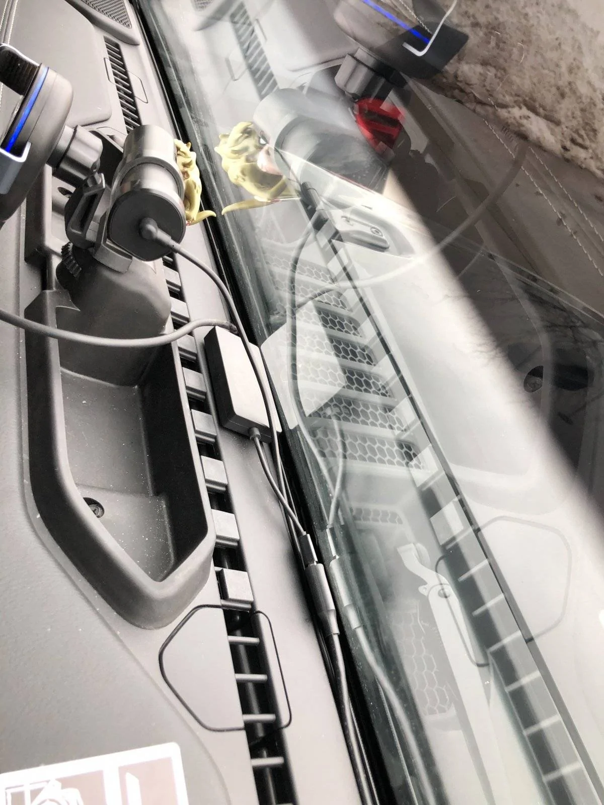

As I understand it, the black plugs go into the vent openings. But, what's the deal with the long black strip you have on top of it? Is that something you bought or made?
There is no long black strip - I used 11 plugs in every other hole. Just looks that way.

I believe the fault is the number of vents going across. There's too many so the flow gets less and less- these caps close some off so it helps to push the air through to the end. It's like blowing air through a straw and then blowing air through 30 straws!

I got mine today and put them in.... trying something different... left the 2 middle ones openthen working my way to the side, blocked 3 then 4 open, blocked 3, then 4 open, blocked 2 then the last four open.... will see how this performs.... if not...I will go with every other one blocked.... but I did notice a difference in air volume at the ends....

I've recently attended to the defroster fix, using the 5/8" plugs frequently pictured in this thread.
Wanting to experiment a bit, I installed the original set of 8 plugs whilst the vehicle was in the garage. I carried the second set with me, intending to pull over whilst the defroster was warm and running, putting the additional plugs in place to further refine the airflow. I did just that. However,...
When inserting the 9th and 10th plugs, etc., they didn't seat correctly as the original 8 did. Rather, the new ones began to fall through the square defroster vent holes. I immediately stopped the installation, allowing them to stay cockeyed and stuck, and carefully extracted them when I arrived back home.
I'd posit that the heated air (the temperature knob was turned fully to the right) was sufficient to allow flex in the plastic vent openings. By extension, the action of pressing the plugs in place was concurrently sufficient to disallow proper seating of the plugs, now that said flex was introduced into the equation.
So...take proper care here, in the event that any of you experience something similar. I hesitate to think about the difficulty of retrieving a plug that fell down into the defroster duct.

Installing mine, I went through the same thing with a few of them.... but I found that turning them a quarter turn to the right or left, they fit snuggly.... could try that also... but yes, you're right... one would be very difficult to retrieve if one fell in.... and also I found that you had to insert them pushing down flat and not at an angle or they would not seat in right.

And it works well!!!!! Heat is getting to the sides of the window now keeping ice at bay!
