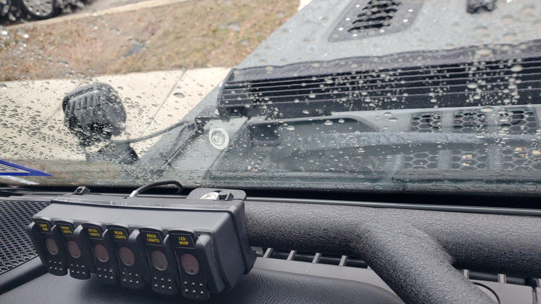

I figured it was s good time to test out @1JeepDad 's idea. I fired up Stomper, and checked airflow with my hand. There was full flow in the center...
and zero air flowing on driver and passenger sides.
I stuffed a flannel shirt over the center and confirmed the air instantly diverted to the sides. No internal blockage, no fake vents, just poor coverage of the windshield.

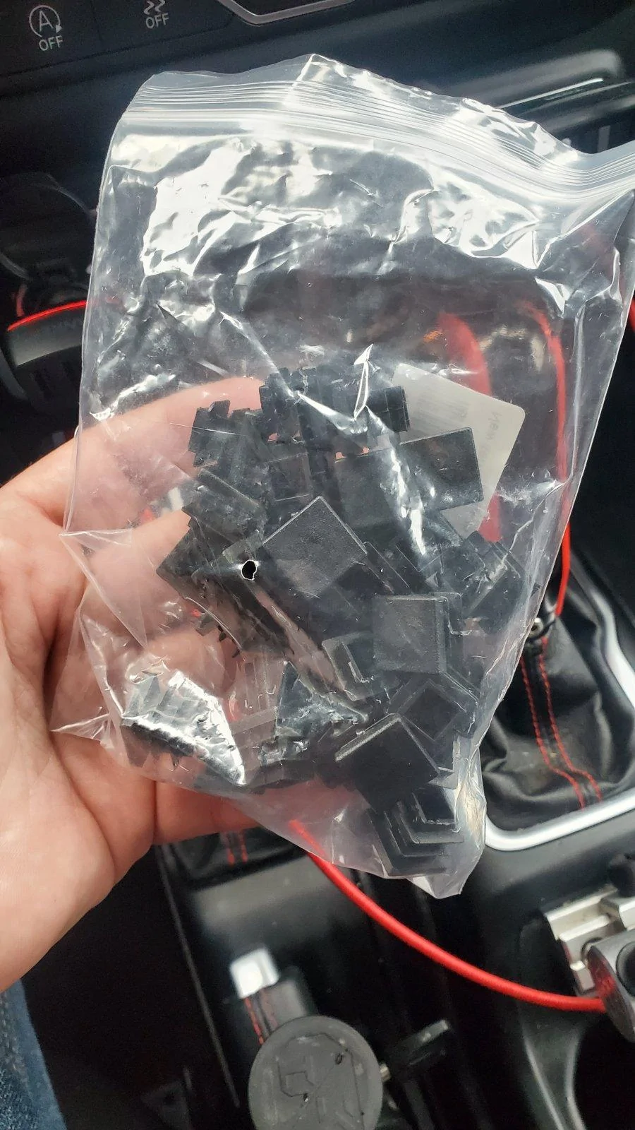

I had come prepared.

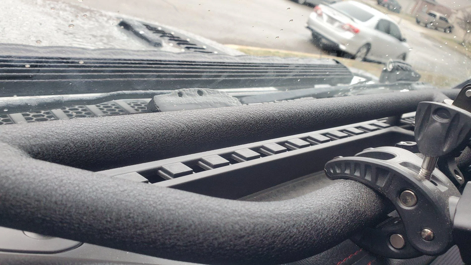

After a QUICK install (no thanks to old hands and the @Vector Offroad mount that I LOVE), 50-ish% of the air now flows to the sides.
So THANKS @1JeepDad for a practical and highly effective tip! ??
