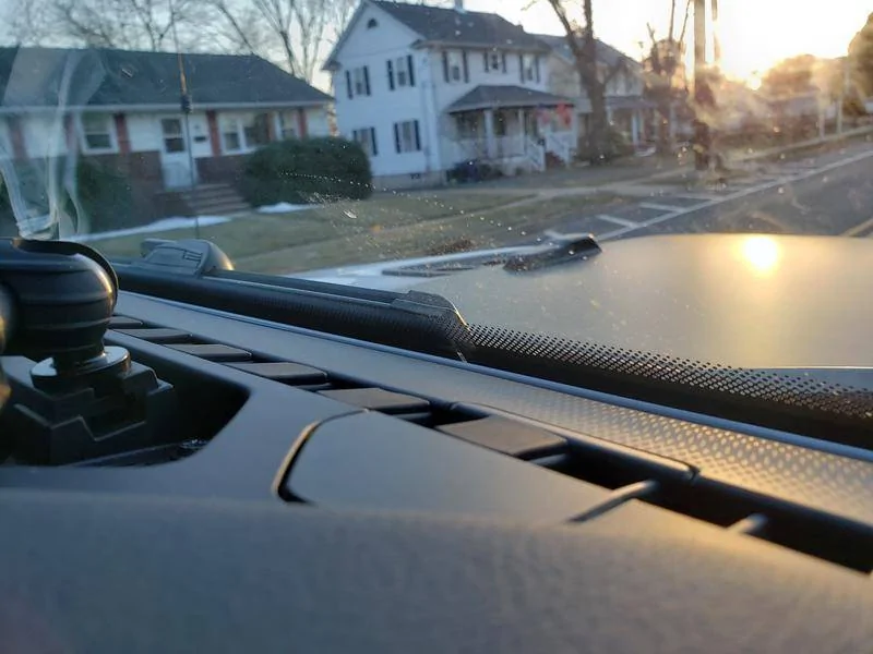

i tried a few different of the plastic caps and i wasn't happy with the fit of any of them, they don't seat all the way or jiggle out of place. these silicone ones are the keepers for me, they fit snug, and the caps sit nice and level.
from the other defrost fix thread
*edit*
added photo..
Jeep Wrangler JL Windshield Defroster Fix swyfbAc
