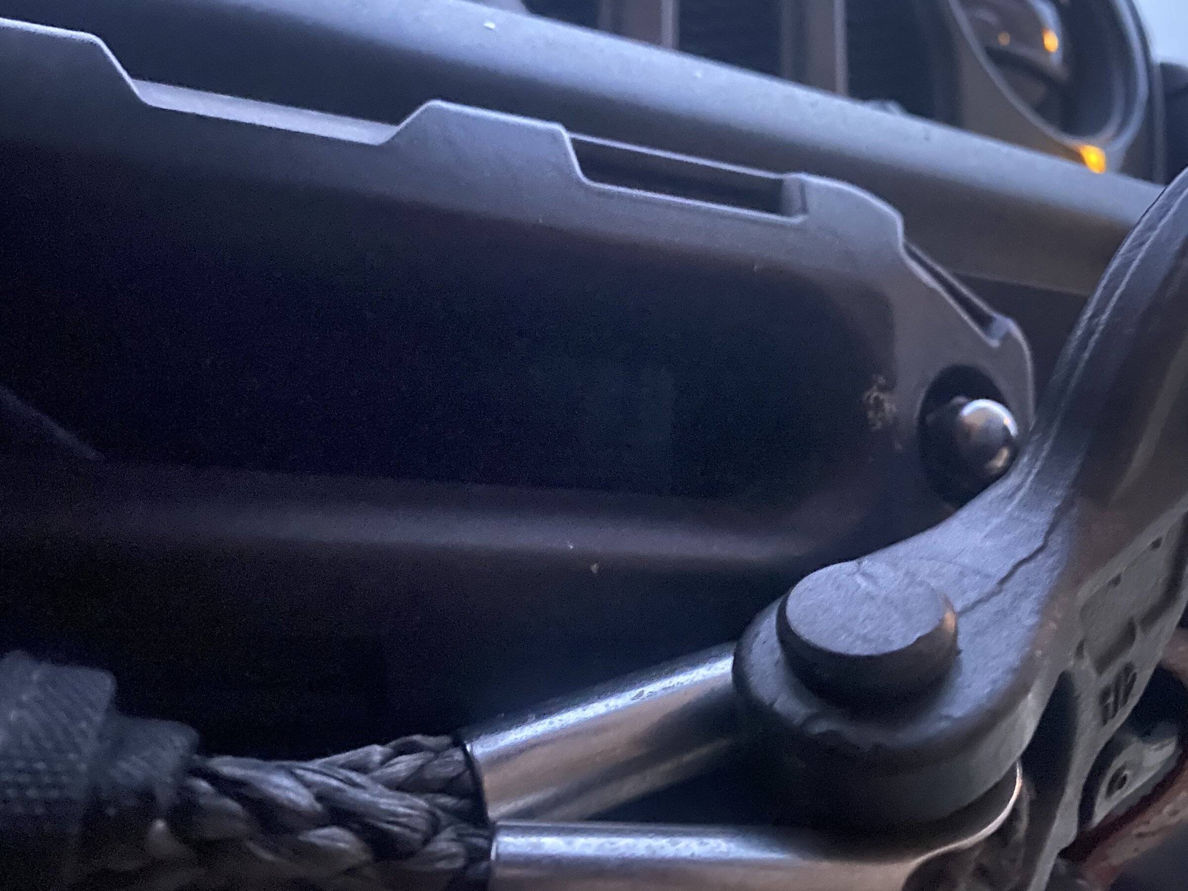

Jeep Wrangler JL Winch Install issue 7C7AD442-CE00-4E0C-B216-B6A3D72A9CEF
It’s not a great photo, but I increased the contrast so you can make out the lip of black metal sticking up past the hawse fairlead about 1/8” of an inch.
I think larger bolts may force the fairlead up enough.
bacon392
bacon392
Jan 22, 2022
105
161
Northern NJ
Sarge Rubicon 392 XR
See the acorn nuts used. There is about 1/8” of vertical clearance from top lip of fairlead to winchplate as I feel with my finger.
Interesting. The bolt comes through from the inside and the nut is on the outside? I have it mounted the opposite way with a hex head button bolt facing inward from the outside.
