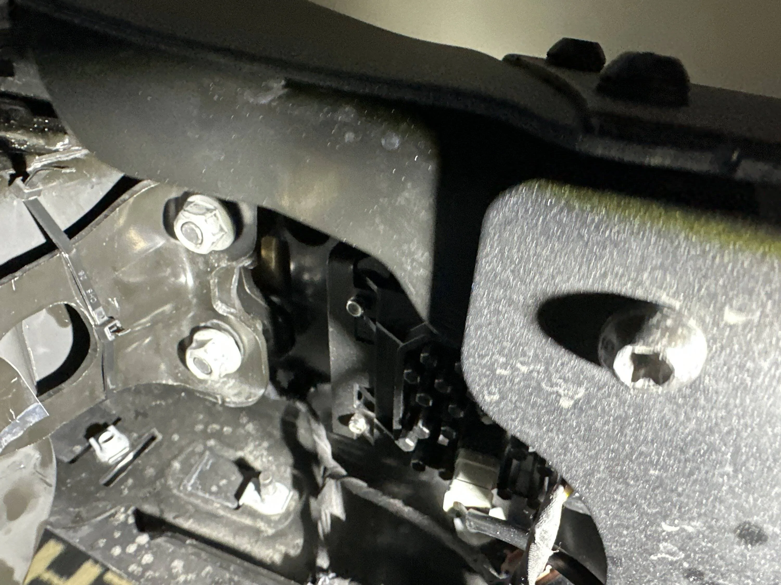

Are the holes through the frame horns clear? I installed that plate a few weeks ago and I had to loosen the brackets on the sides to make them align properly so I could get he bolts through. Once I did that I did not have problem.​

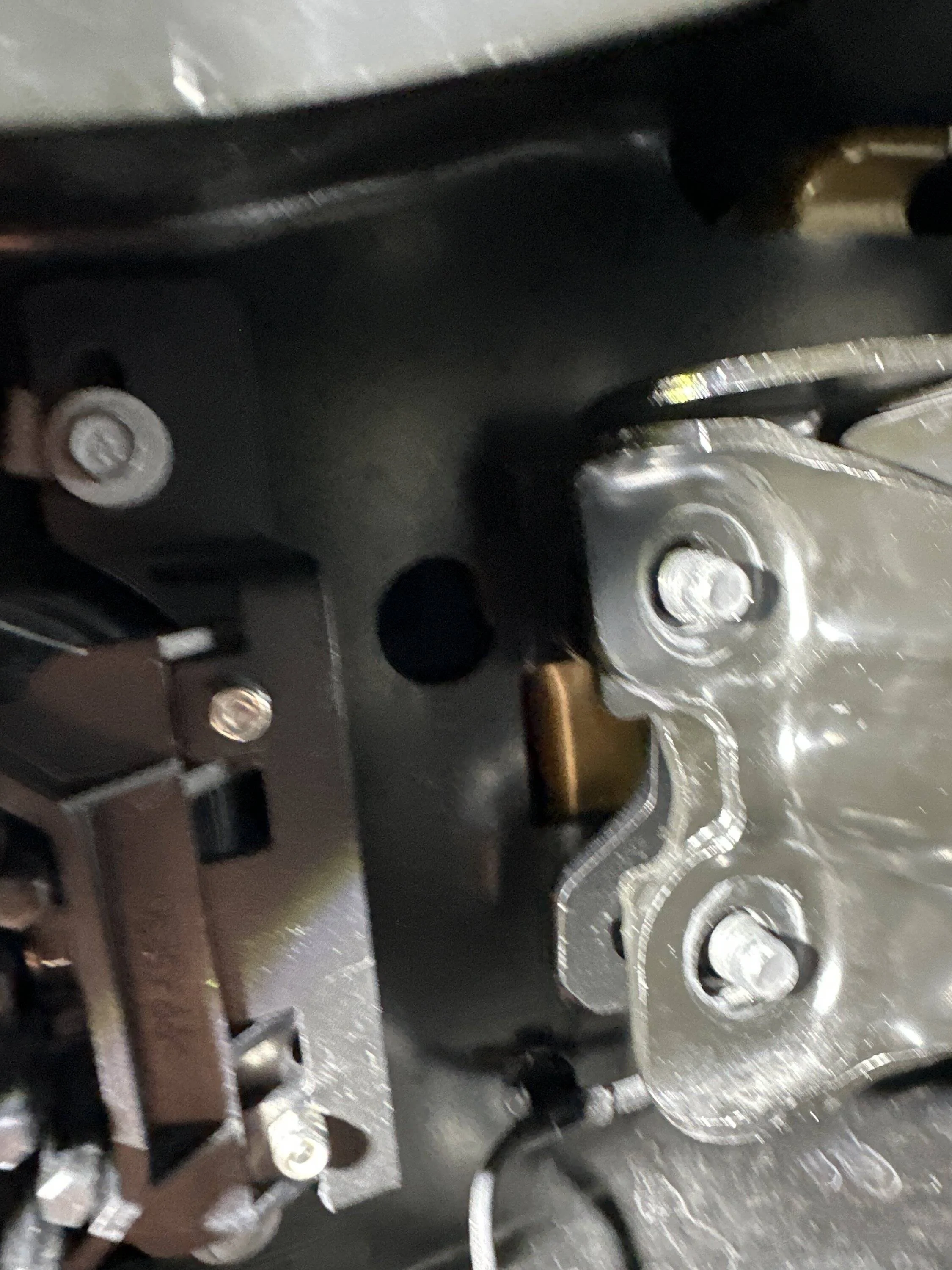

So here is my update. I removed the fairlead, it seems the two bolts that I used to attach the fairlead, may have been part of the problem, but not sure. Are they supposed to be bolt behind and nut in the front?
I was able to start two outside nuts on passenger side. Still cannot get the driver side started. My rubber mallet and I are working overtime, again.
Here are current state of affairs.
Everything has been reloosened. If that is the word.

You made me go out and check my bumper. LOL. There seems to be very little room as the bumper is very close to the frame mounts. If I were you, I'll loosen the winch plate and see if there's any play in it and try fitting the bumper with the winch plate loosened.

So, another update. After many words that my mother told me not to say, it decided to cooperate! Four bolts attached!
Now comes the dreaded wiring to the battery.
