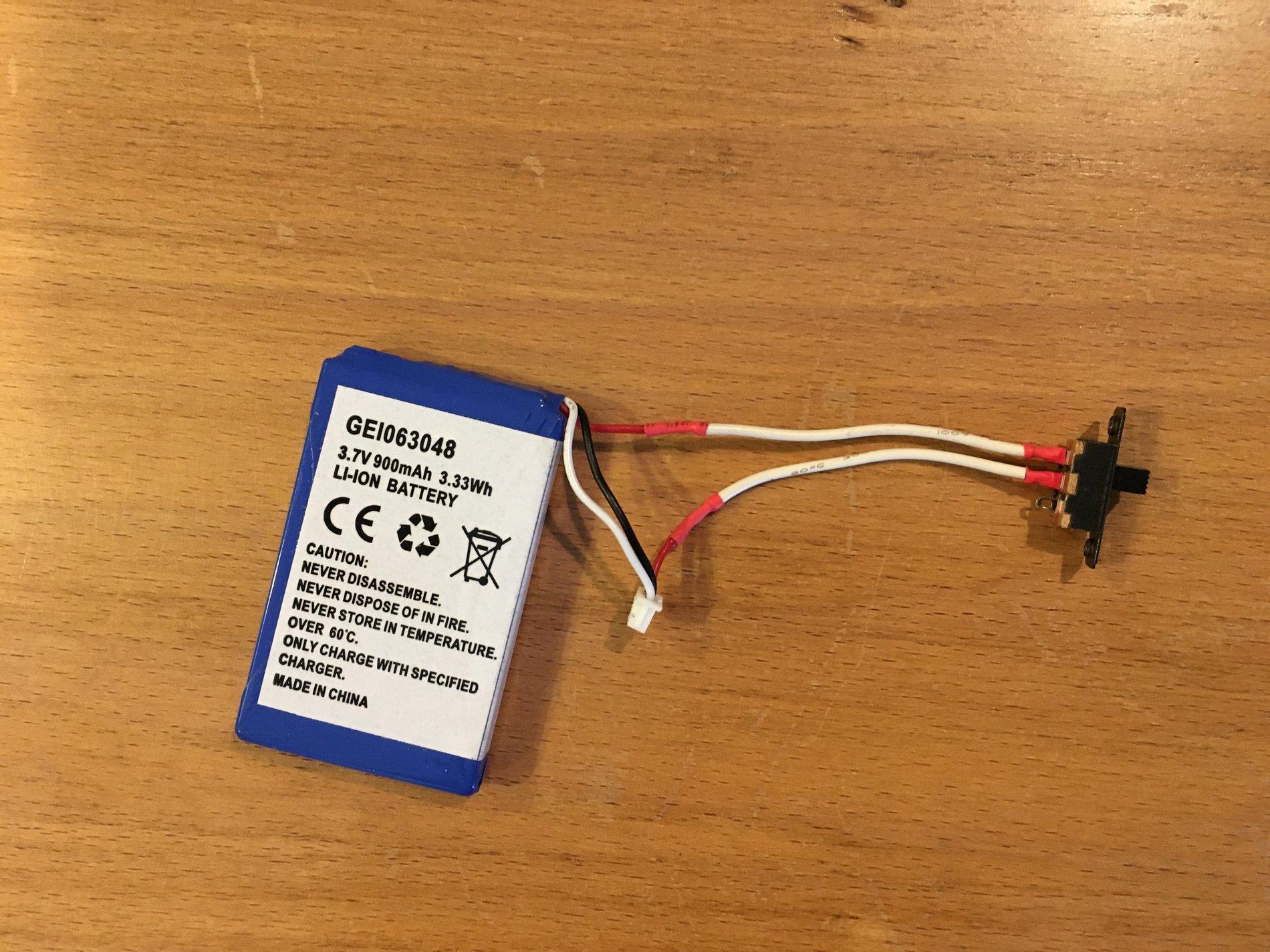

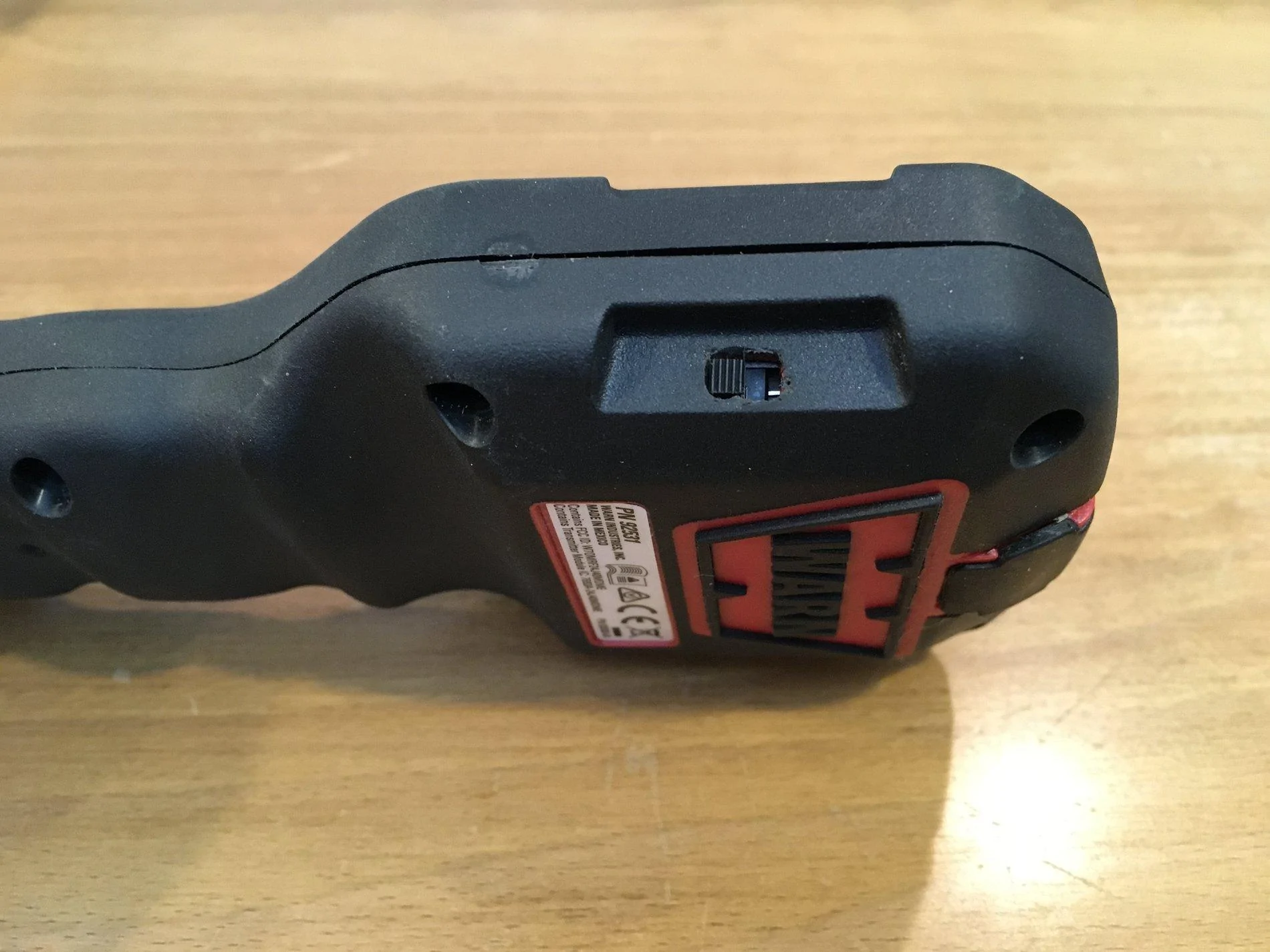

The problem is not the battery. Something in the circuitry is draining the battery, even when the remote is off. I have had four different batteries and a different remote and all have have ended up dead within a couple of weeks of sitting unused.
The last time I had this problem I contacted Warn and talked to Tom Sommers...(not sure about the spelling of the last name) and he acted like I was an idiot and as though this was a “new” problem to him. I then got on the Toyota Tacoma forum and found that a number of people have had the same problem. One even mentioned talking to Tom Sommers about it. Anyway...seems that many have contacted Warn about this problem, but they are not addressing it.
Since I now had two remotes I decided to try to resolve the problem myself. I installed a sliding switch on the red wire of the battery and then cut a slot in the side of the transmitter to mount it. I now turn the remote off and on with this switch and I have no problems with the battery holding a charge for extended periods of time. The only down side of this is that now the remote is not waterproof, but I can deal with that.

In a very similar approach to @Kansascoast there is a vid on Youtube that details how to McGyver a solution. I would link it here but Youtube is blocked from work. However just go to Youtube and type in "Warn ZEON Platinum - Dead Battery Solution". The poster is named CL Biro and his video shows how what he discovered with regards to battery drain and what he did to fix it. Like @Kansascoast you may have to be prepared to be McGyver. I haven't used my Platinum S yet...though I did buy it used....so I'm preparing for the worst.
