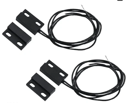

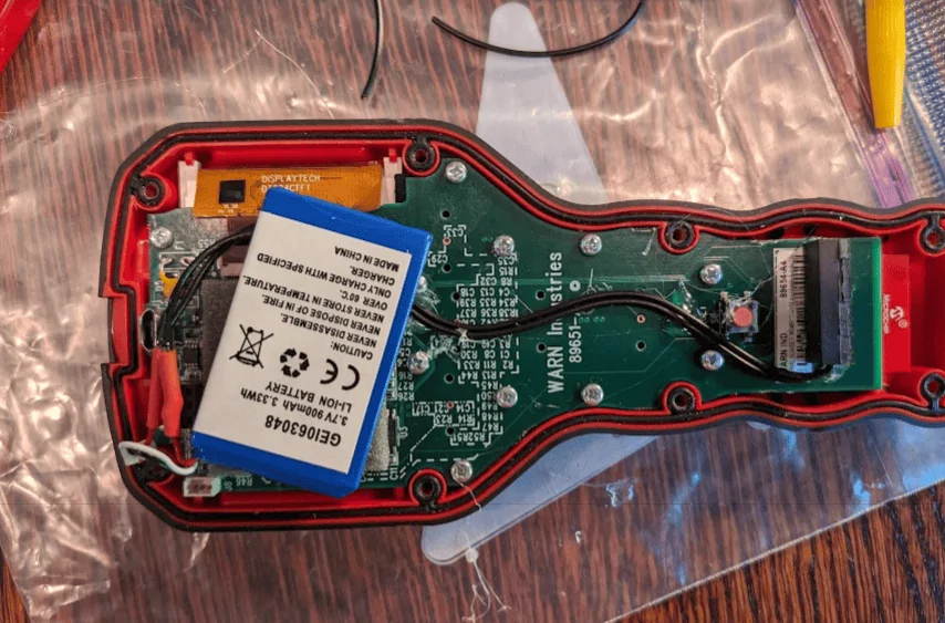

I did this mod, here's the parts I used:
https://www.amazon.com/gp/product/B0B7QZF9YZ/ref=ppx_yo_dt_b_search_asin_title?ie=UTF8&psc=1
Jeep Wrangler JL WARN Zeon Advanced Wireless Winch Controller Issues 1717270445060-jg
these reed switches are small and fit easily in the bottom half of the remote - I cut off the part of the switch with the mounting holes and glued it to the circuit board
Other than that it's just some solder and heat shrink, but it is a bit tedious due to the short leads on the battery. Oh, and some modification to the bottom half of the remote to make room for the wires.
Jeep Wrangler JL WARN Zeon Advanced Wireless Winch Controller Issues 1717270568166-qg
My magnet is attached to a strip of velcro with some heat shrink and glue, should be quite durable. The magnet that comes with those switches is not quite powerful enough to work once the case is back on (at least reliably) so I used a more powerful one from a larger door/window reed switch I had around.
Jeep Wrangler JL WARN Zeon Advanced Wireless Winch Controller Issues 1717270656845-hm
Works like it should now.
