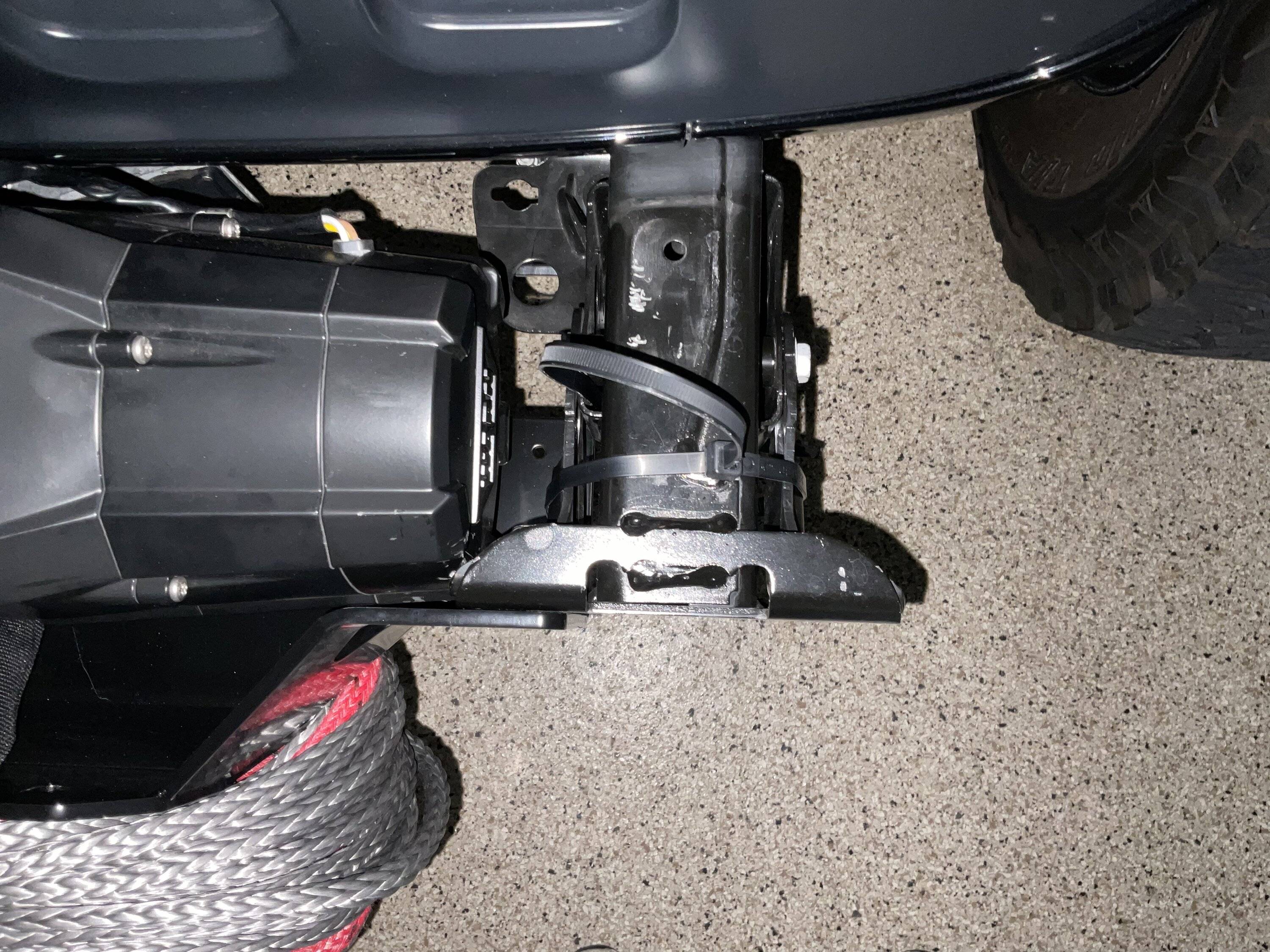

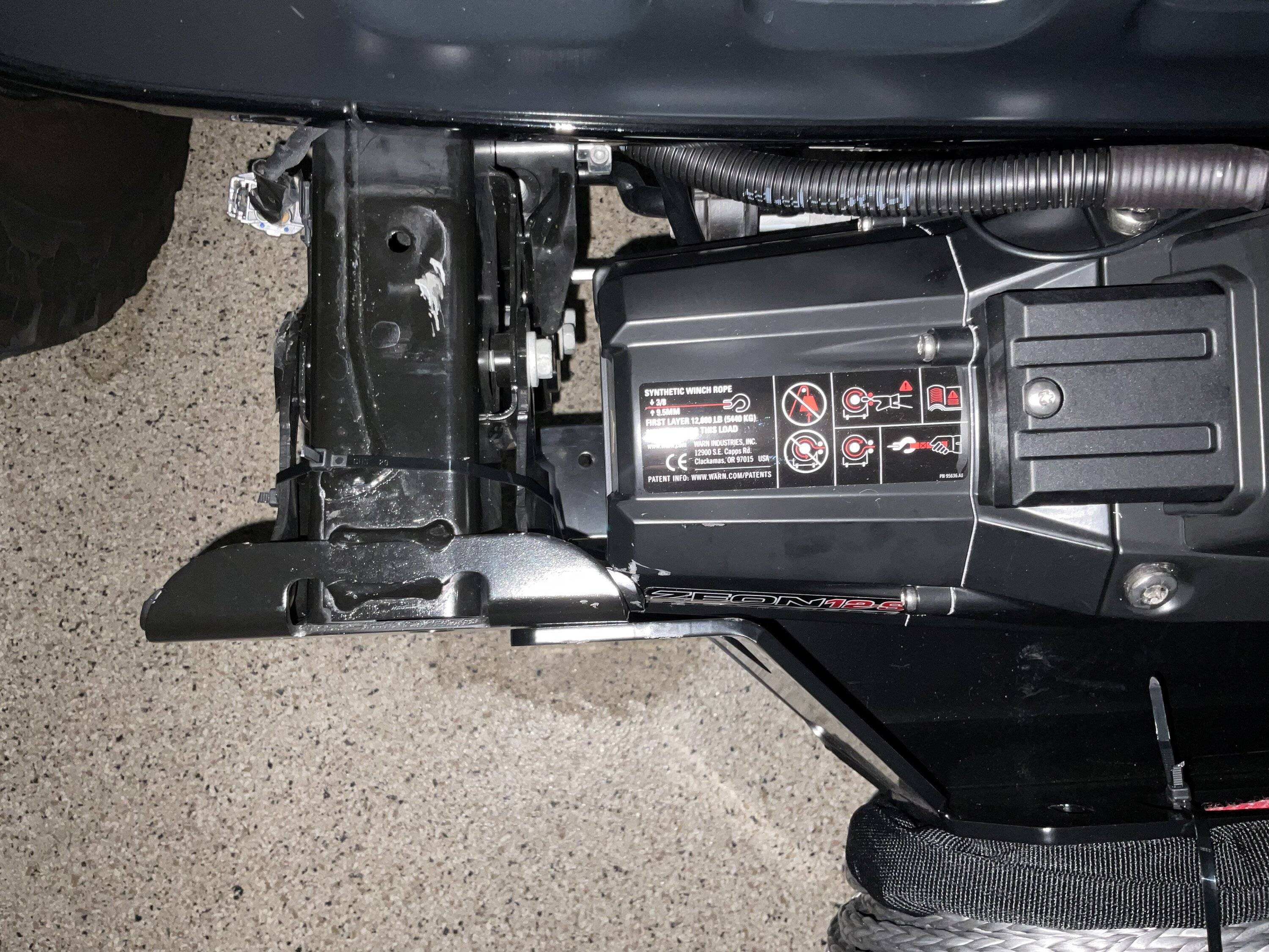

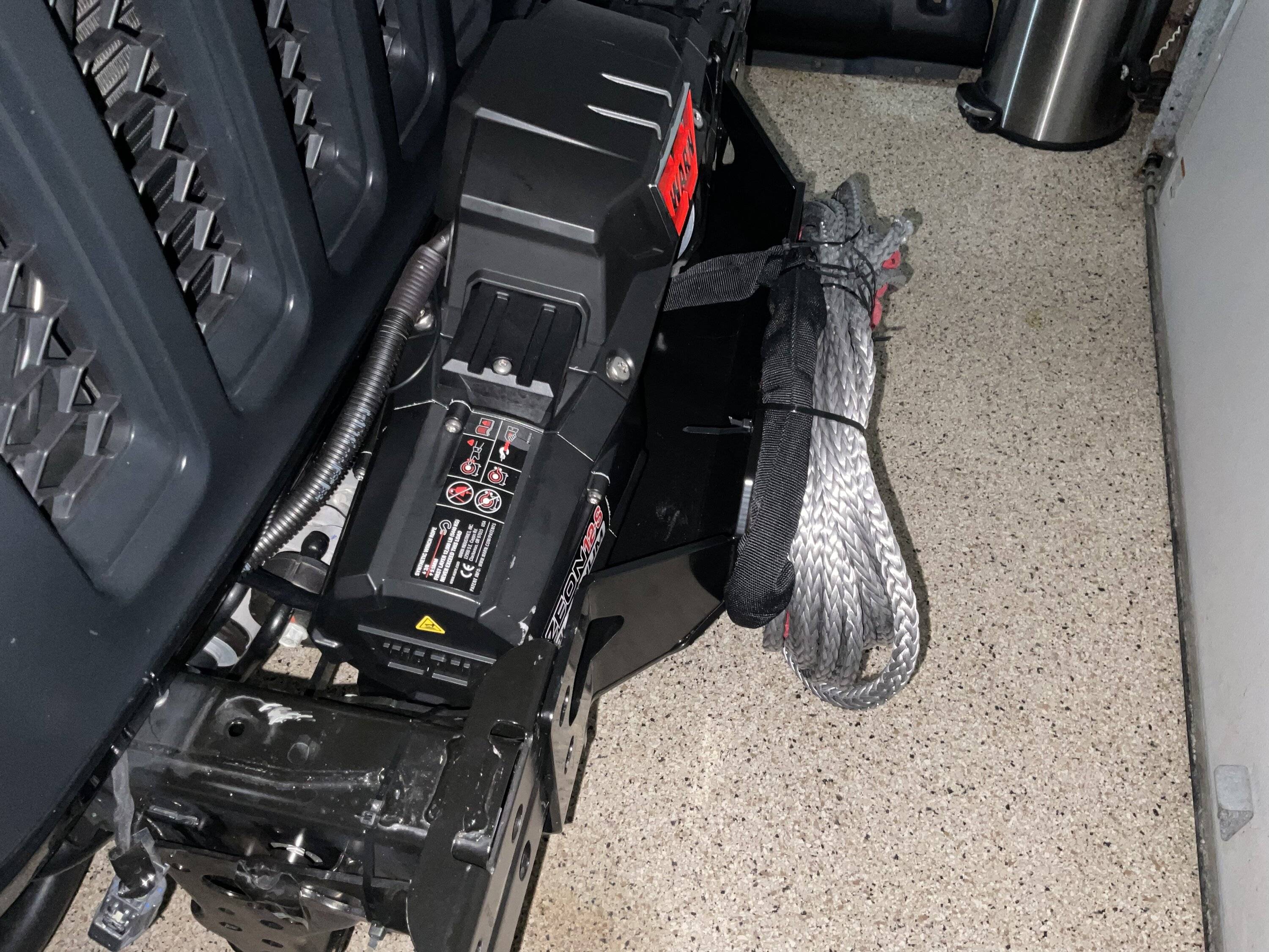

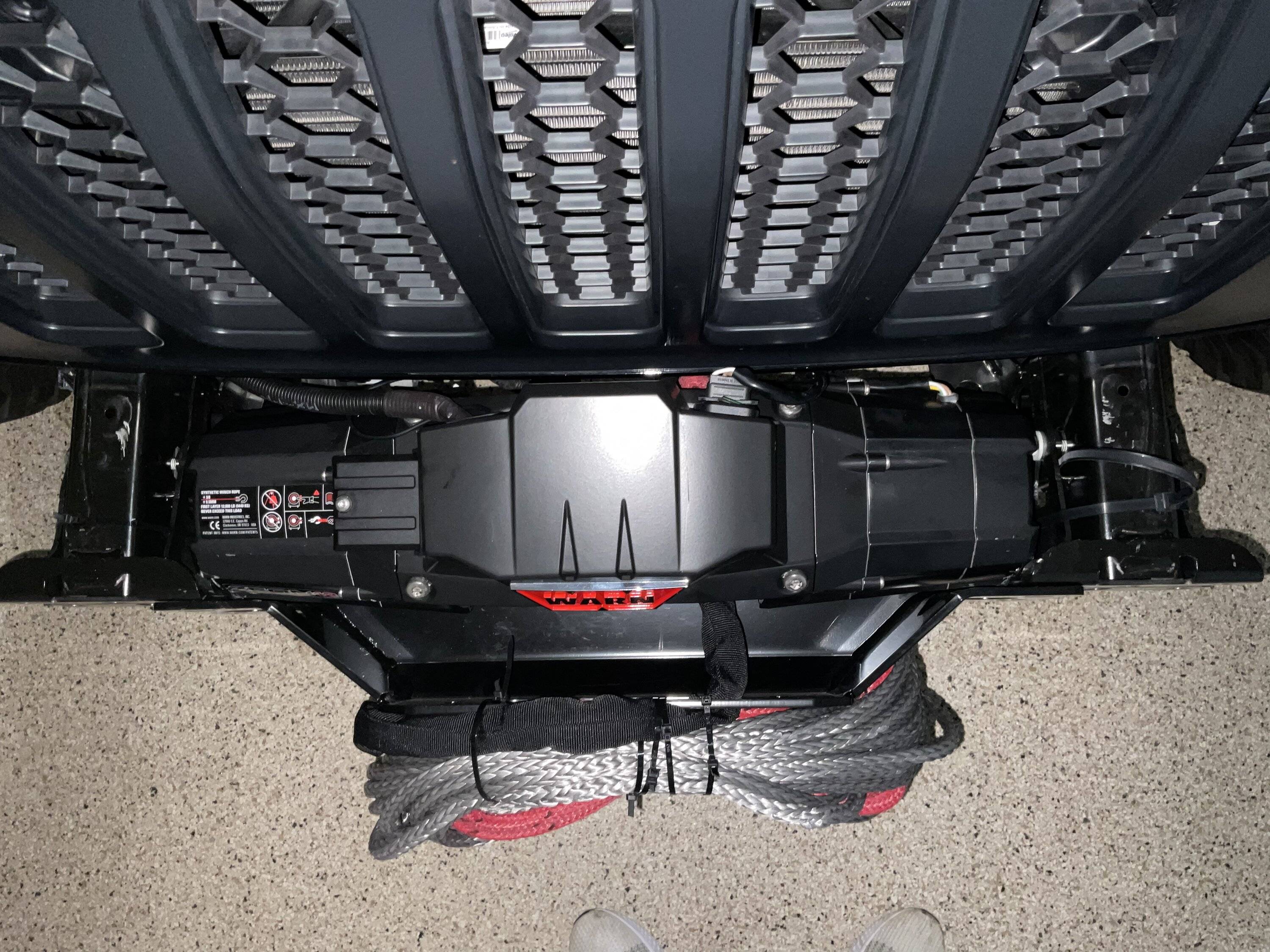

Hi All,
Newbie installer on my own 23 Wrangler 392. I have a Warn 12-S Platinum winch, with Winch plate 101255. I have the winch and plate mounted to the Jeep. I cannot, for the life of me, get the bumper back on. When I go to reinstall the bumper, the studs on the bumper are too short to even get the nuts threaded on the back. Seven hours on Saturday of hair pulling, and I have none to pull to start with. I watched install videos all week in preparation for this task, and never saw this pop up. Must be good editing or user error on my end!
I have attached a couple pics for reference of the install. Winch plate off, no problem reinstalling the bumper.
I appreciate the guidance!

I would start by loosening the 4 tow hook reinforcement brackets. Those could be causing the holes to not properly line up. Also, the two reinforcement brackets on the inner frame are making contact with your winch. I would take those off and grind them for clearance. With all of that said, I don’t know if the newer models made changes to the bumper bolt lengths.

I would start by loosening the 4 tow hook reinforcement brackets. Those could be causing the holes to not properly line up. Also the two reinforcement brackets on the inner frame are making contact with your winch. I would take those off and grind them for clearance.
Thanks for the info. I do have the holes lined up and open, to get the studs on the bumper to the hole. I just can’t get them in far enough to attach the mounting nuts.

Is that stack of rope in front, in the way? And just for clarification, you have the OEM steel bumper, right?
The stack of rope is the winch line. I zip tied out of the way to use the vehicle. With that out of the way, I still have the issue.
Yes it is the factory steel bumper.

Its been so long since I added the winch to my factory steel bumper. I dont recall that bump out that you show in your pics.(behind the winch line) Isnt the winch line supposed to feed through the bumper? Maybe the bump out and the line is preventing your bumper from being close enough to engage the bolts.
My understanding from Warn, “That is the right part number. The last time we test fit was 2020.”
The line was out of the way when trying to fit it all together.
My assumption was the same as yours, with the bump out from not being correct. I second guessed Warn and went to “4 Wheel Parts” location near me. He gave me the same part number. ?

You made me go out and check my bumper. LOL. There seems to be very little room as the bumper is very close to the frame mounts. If I were you, I'll loosen the winch plate and see if there's any play in it and try fitting the bumper with the winch plate loosened.
