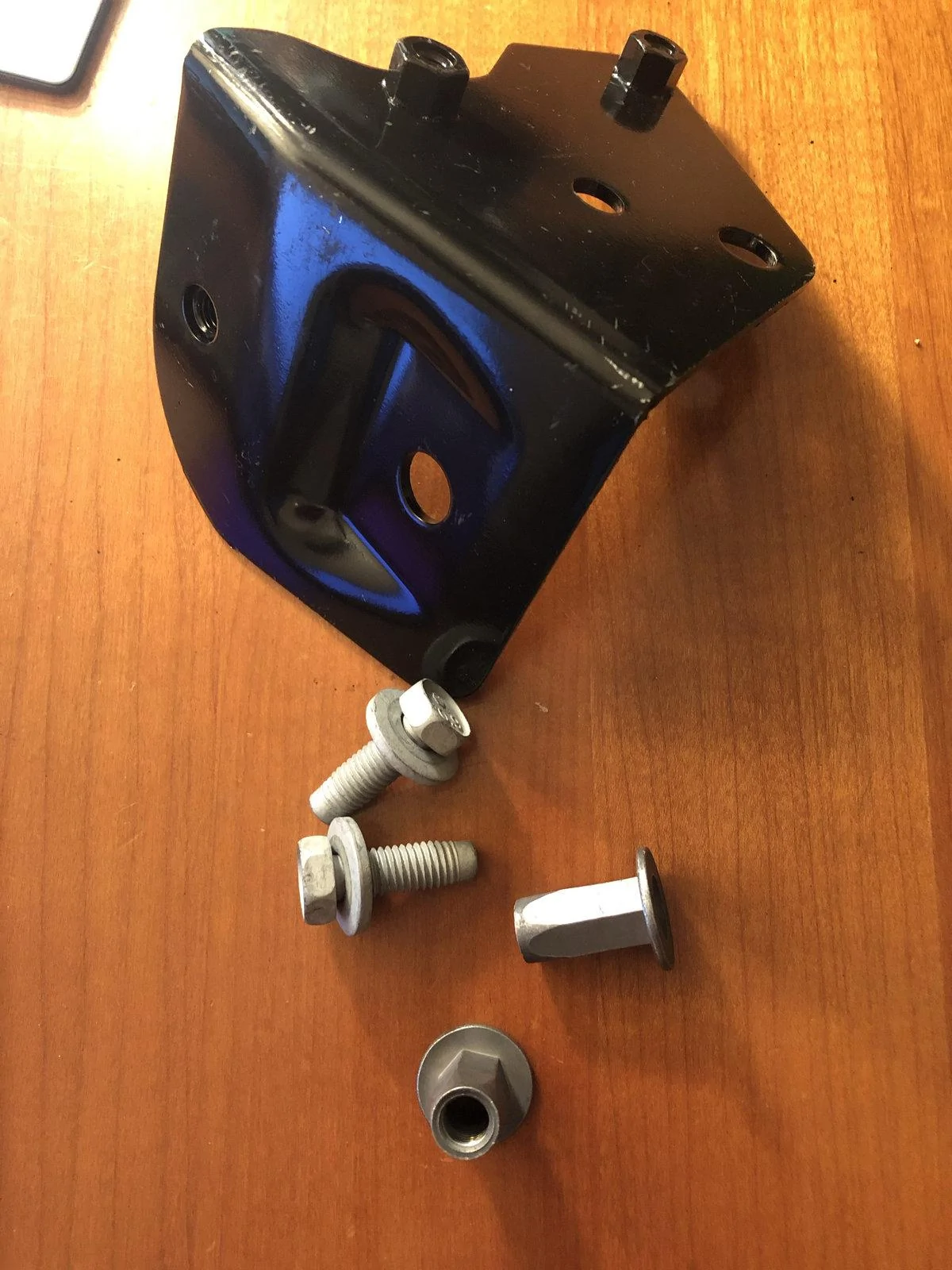

I chose the Warn winch plate, which requires the Rubi skid plate mounting bracket - which carries with it the need for additional captive nuts, nutserts, etc. style install.

So at some point, I'll have 2 extra sets of Skid Plate mounting brackets and hardware ready for the next person tackling this project.

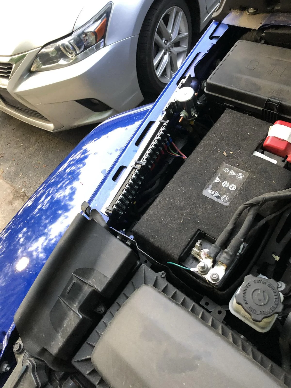

On the wiring, I went with the Warn power interrupt solenoid, followed all the hints online to wire up Aux4.. Now just waiting for the parts so I can get to the hard part of this install. Followed the HomeDepot angle iron bracket strategy, but choose the 1" angle aluminum. Cut and trimmed the bracket to mount the Solenoid and some new term blocks for the Aux switches, ground and future projects.

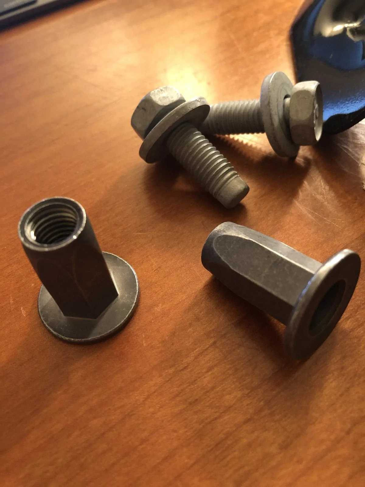

Has anyone dealt with these nut inserts? Do you know how to install them?
I imagine you set it in the hole of the frame, somehow hold the back with a small socket/wrench and tighten it up which causes it to somewhat collapse and sandwich the frame between the front flange and the portion of the cylindrical body that doesn't have threads.. much like those plastic drywall mounting things for screws in your wall..

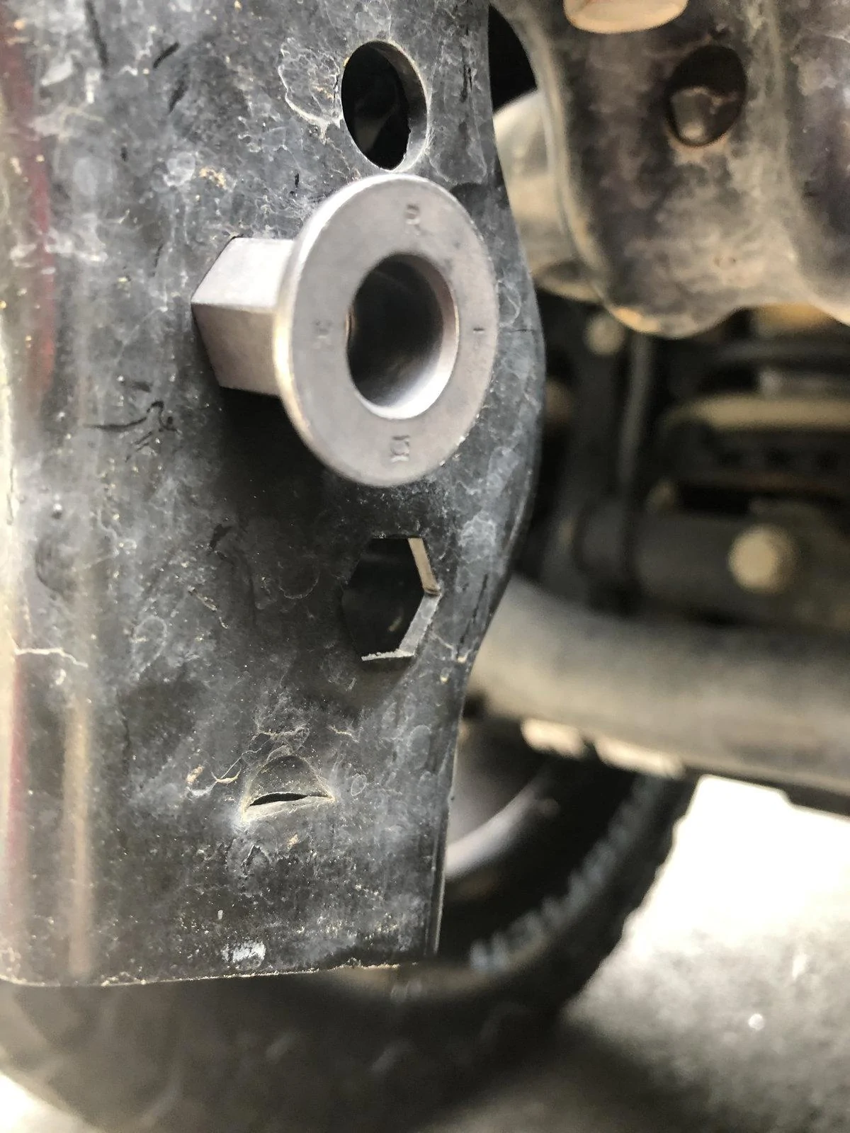

So the frame holes are keyed to the shape of the nut. Cool.
Now the bolts provided are too short to engage the threads when the Warn plate mounts are used. I expect this is because I first have to set the nut into the frame tighten it down and that should pull the threads in allowing for the bolt to be used.

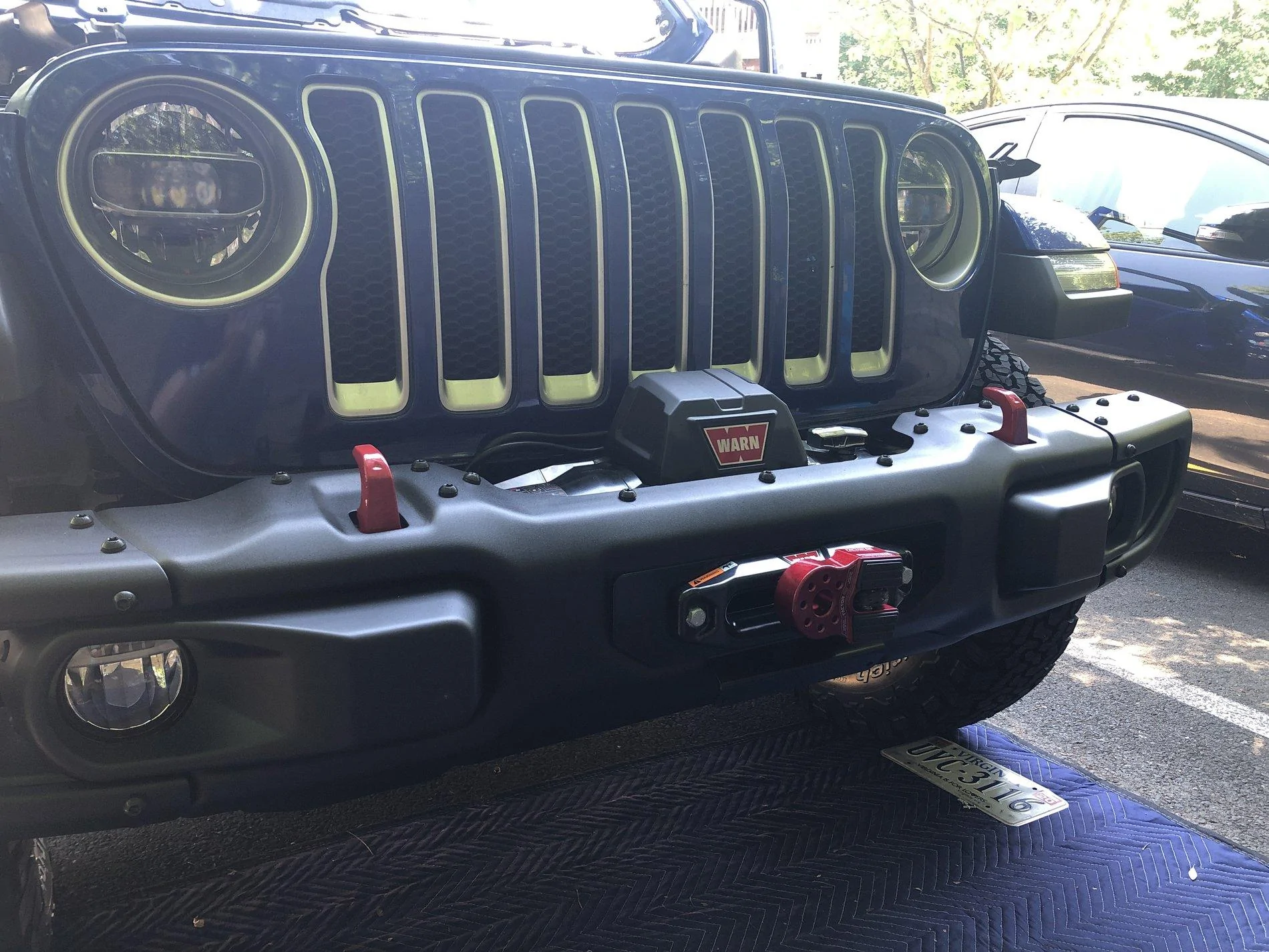

Got her done today.
I caught a mention of mounting the fairlead before putting the bumper on... No - The fiarlead also bolts to the winch plate. Bolts were too short to go through the fairlead, license plate holder, bumper and winch plate - So I improvised.
The two bottom bolts for the skid obviously wouldn't fit since everything was 1/4" forward - I expected this and a few minutes with a file opened the mounting holes to make everything fit.
The ground lead from the winch was the only one without a protective cover; found one in my parts pile and installed that, was a pita with the winch in place. Turns out that extra cover was for the solenoid battery port.
Wired the solenoid up to Aux4, Snaked the cables up inside the body mount by the radiators and air box, then under that brace and to the solenoid and battery.
Had no real trouble with any of the bolts, but that's probably because I went with the VR EVO 12S, so there was probably more room on the sides than all the videos with the Zeon installs.
