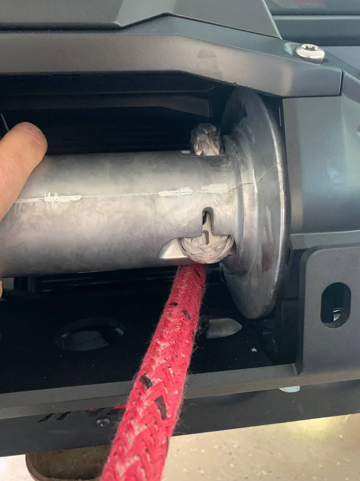

What about this? For some reason I can’t get the rope flush with the drum. It’s sticking out a little bit. 😭😭😭
Should be fine, too.
I hooked to another Jeep and just idled backwards to gently snug it in there. The loop was at the back of the drum when doing this. It went flush.
