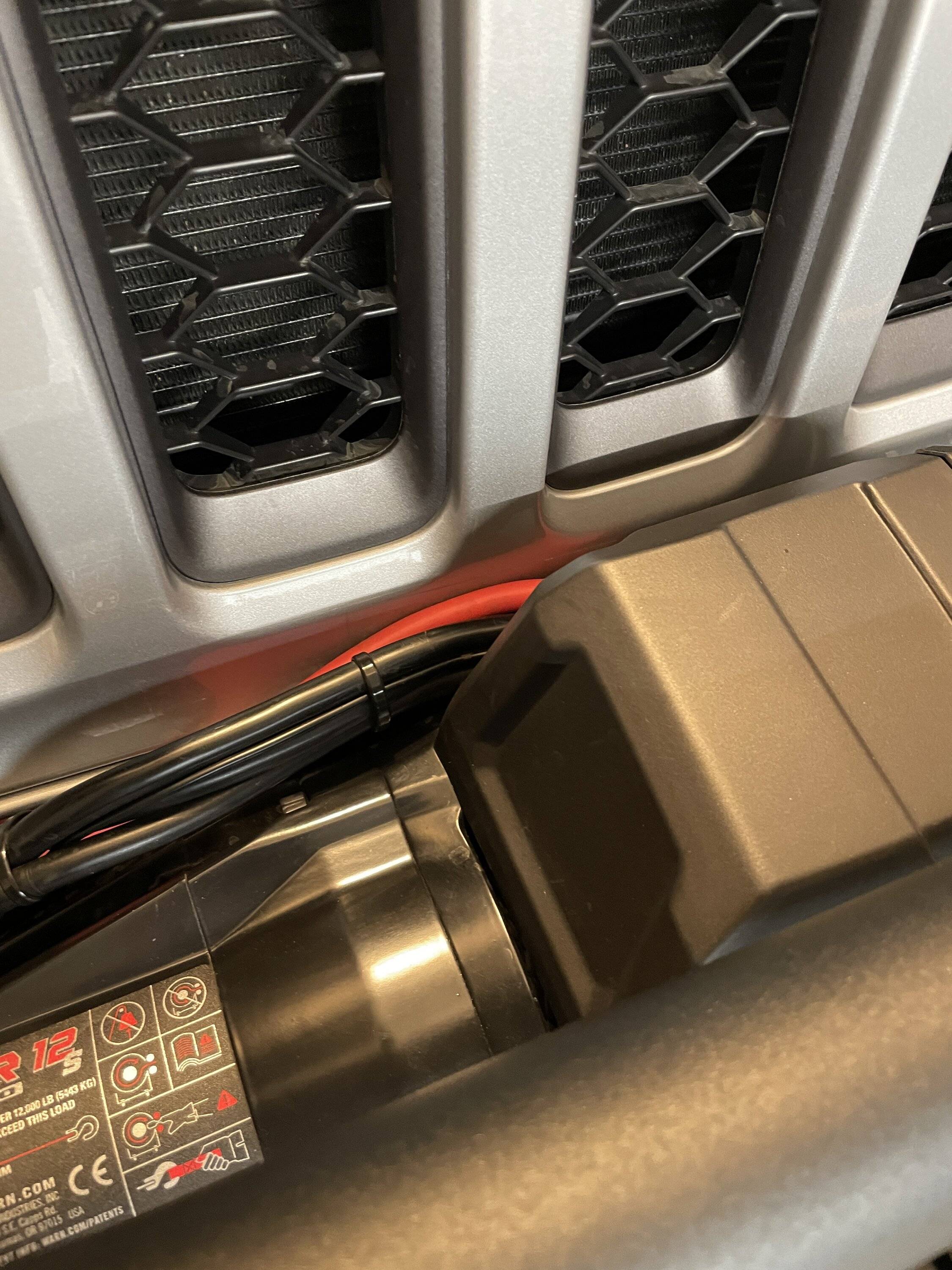

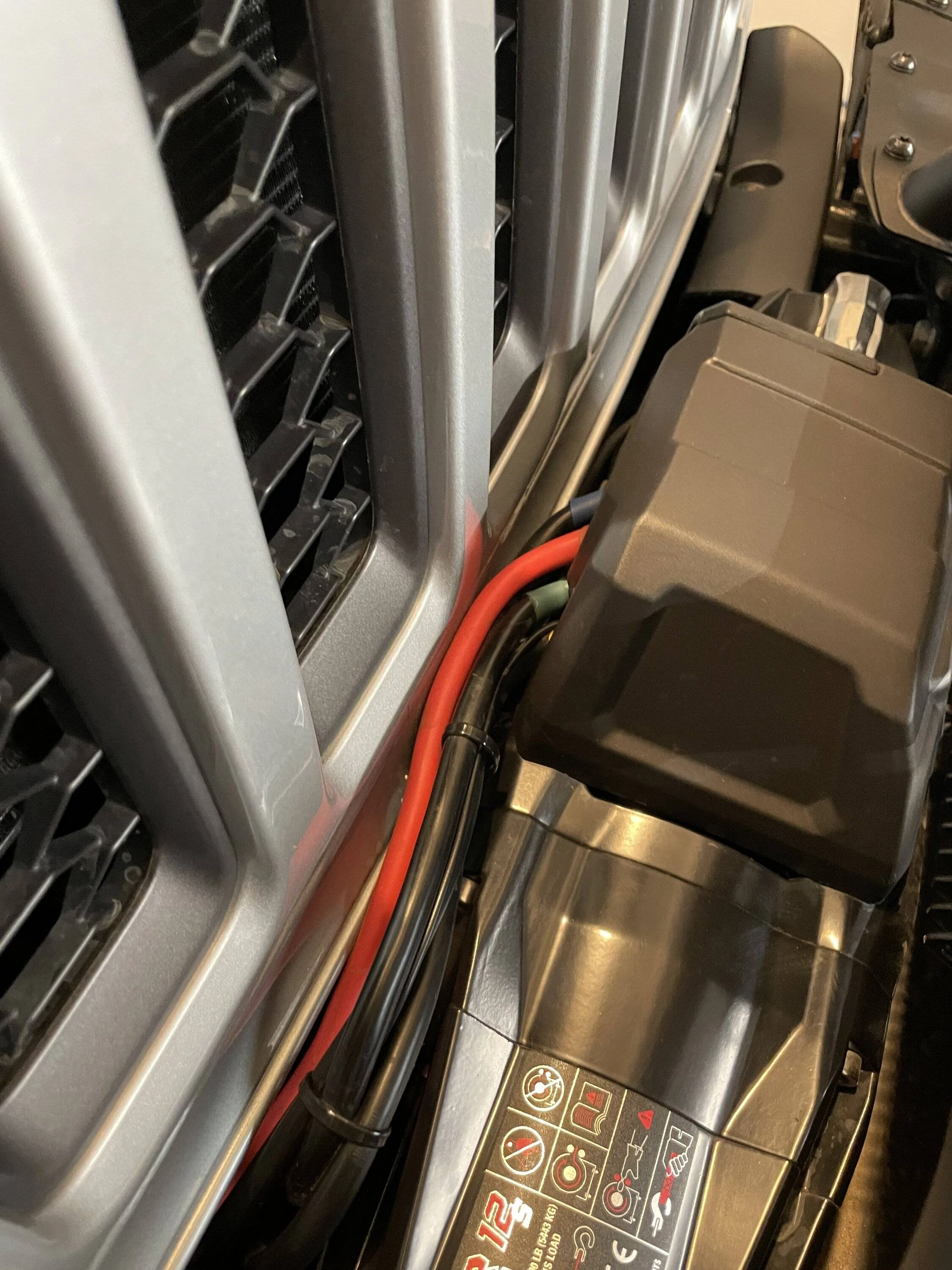

I used the Warn winch plate, and mine is maybe just a little farther forward then yours, but not by much- it would look much the same had you used the Warn plate. Those cables are just a fact of life with the Evo vs the Zeon- not much you can do with them. I ziptied mine together in a couple of spots. I also put a piece of 3M clear bra on the grille where they touch to keep them from rubbing through the paint. If you trim down the plastic trim piece that was between the bumper and frame before the winch and reinstall, it will help hide part of the winch cables and the fog light connection- see my post on that above.
thank you for the reply. My winch is so tight to the grille I don't think I can slip a piece of paper in between! Literally thinking about changing it out. not sure if I need a different winch. I have looked at so many online this morning and I can't find any like ours with the cords running like that. Brad with Trail Recon had one on his JLURD with no cords visible. I'm not sure what warn winch he used.
Not sure which winch he has, but the Zeon's use a bus bar for the electrical connectors rather than cables, one of the reason it looks much cleaner, but costs a whole lot more. Not sure there's any way to mount an Evo on a JL without the cables showing to some degree. I wouldn't worry about it if it works! This video is a great comparison between the less expensive Evo and the Zeon.

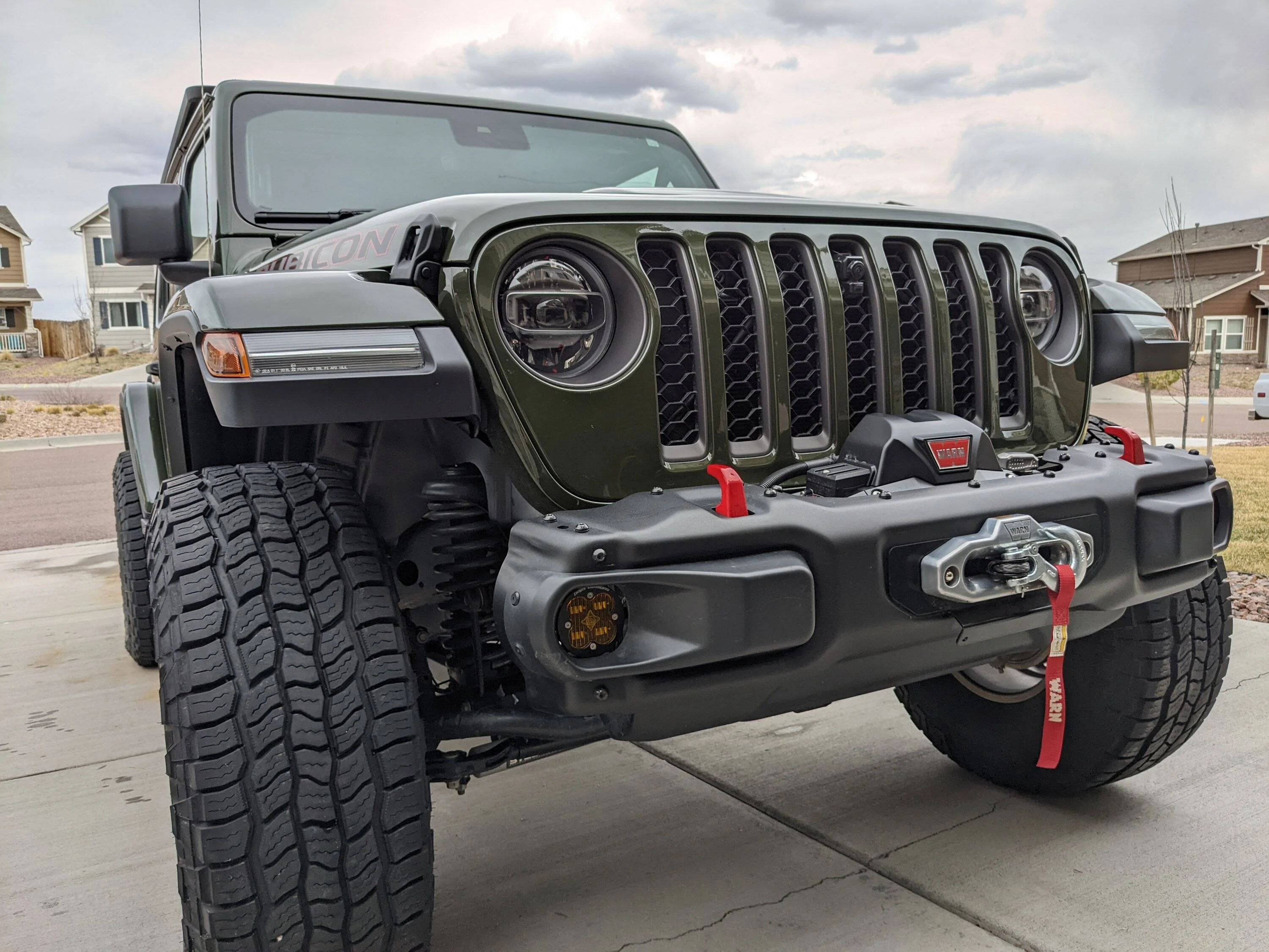

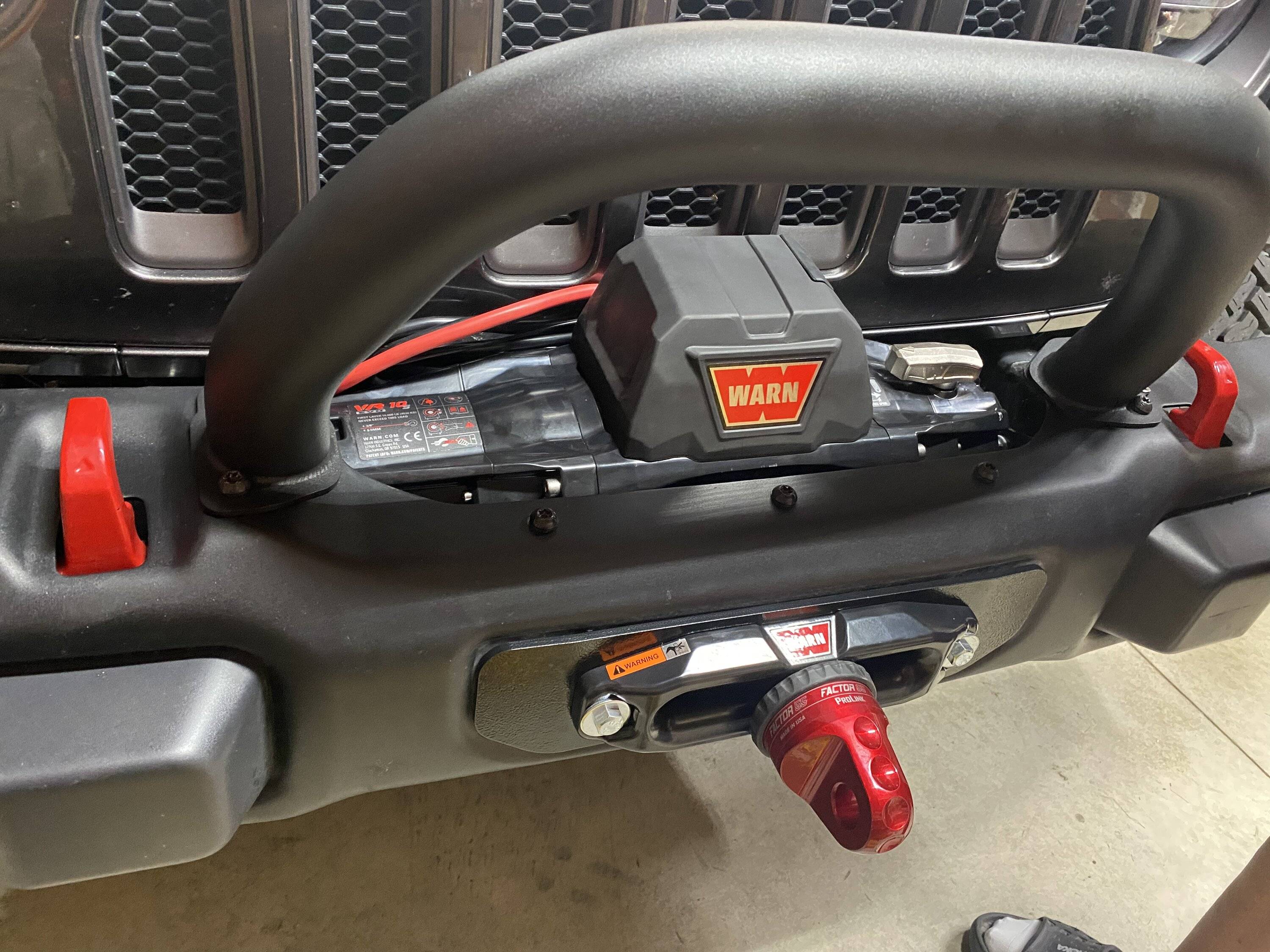

I mounted a warn zeon 10-s with the warn winch plate in the factory steel bumper. I did not have to trim anything. I did have to redrill the holes in the frame horns to get everything to line up because the factory had them so far out of alignment. It was easy though. I just ran a drill bit through them to elongate them just a tad.

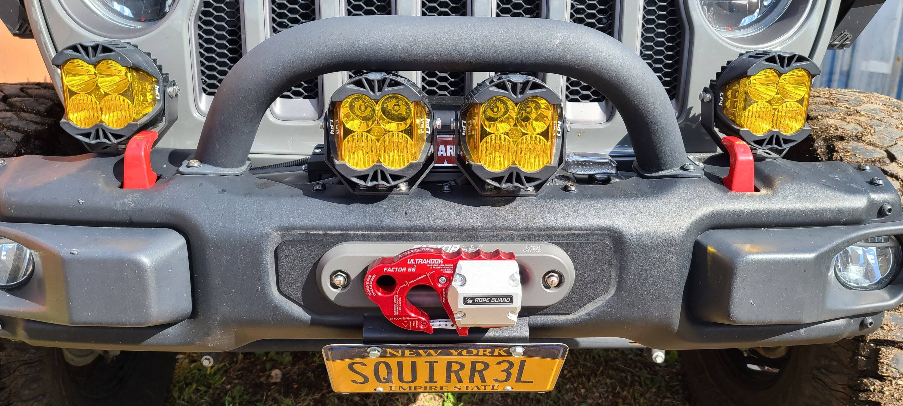

What amber lights are you running?
Adv_aw8s
Rob
May 30, 2021
482
766
2021 Rubicon diesel
I'm running the baja designs sae squadrons in amber. Absolutely love them. I have the led package and tried the amber film over the stock ones but only ran it for a couple weeks before I ordered these. I wasn't happy with the amber film at all, these are hands down much better.

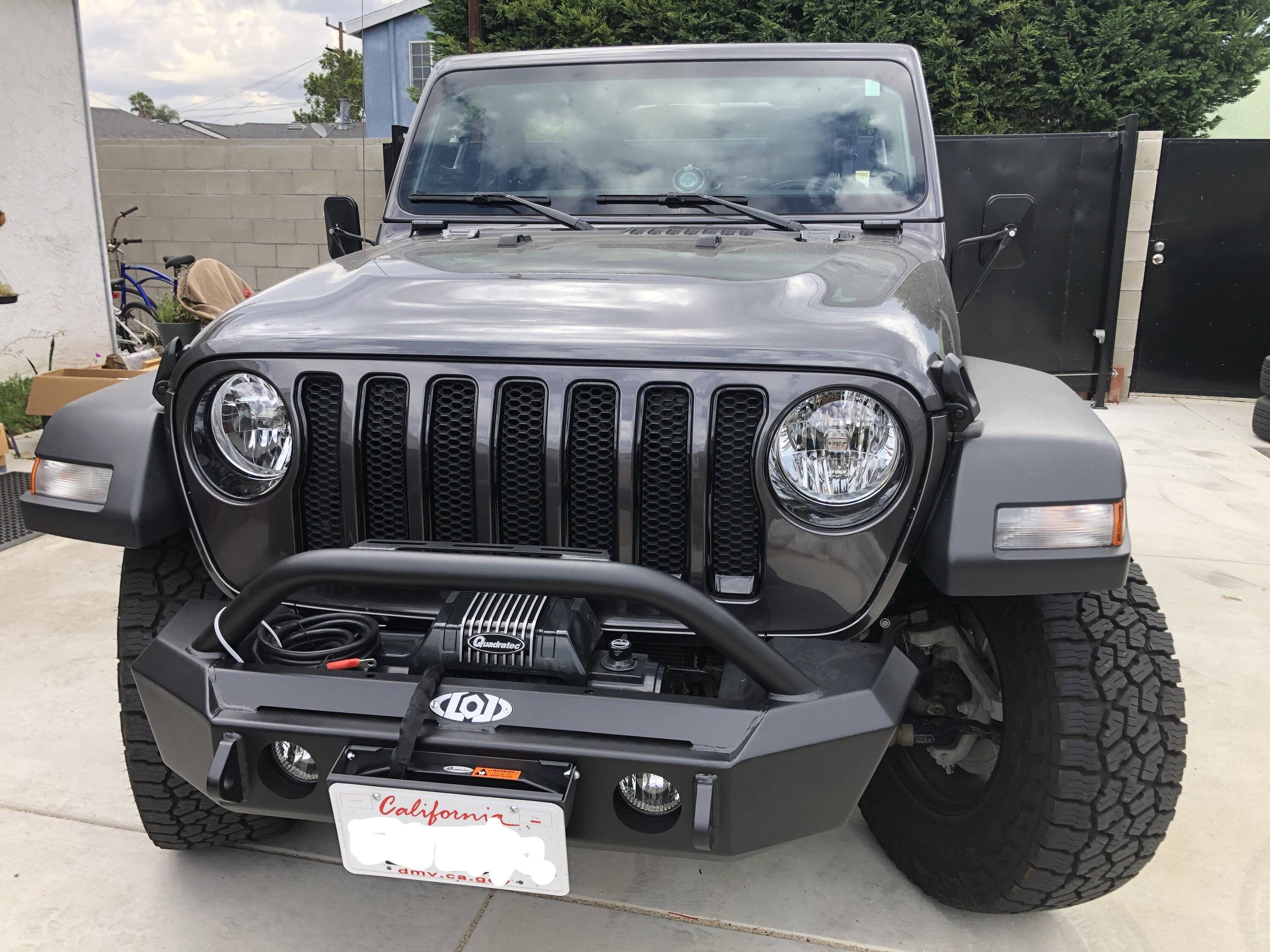

I installed the Badlands 12K winch on Rugged Ridge Arcus front bumper with no trimming or issues. Pretty straightforward install by myself in driveway with no grinding, great instructions plus multiple videos online to cherry pick the better parts.
I'm about to do this same install, the Arcus will go on this week, I'll do the winch later on in the year more than likely.

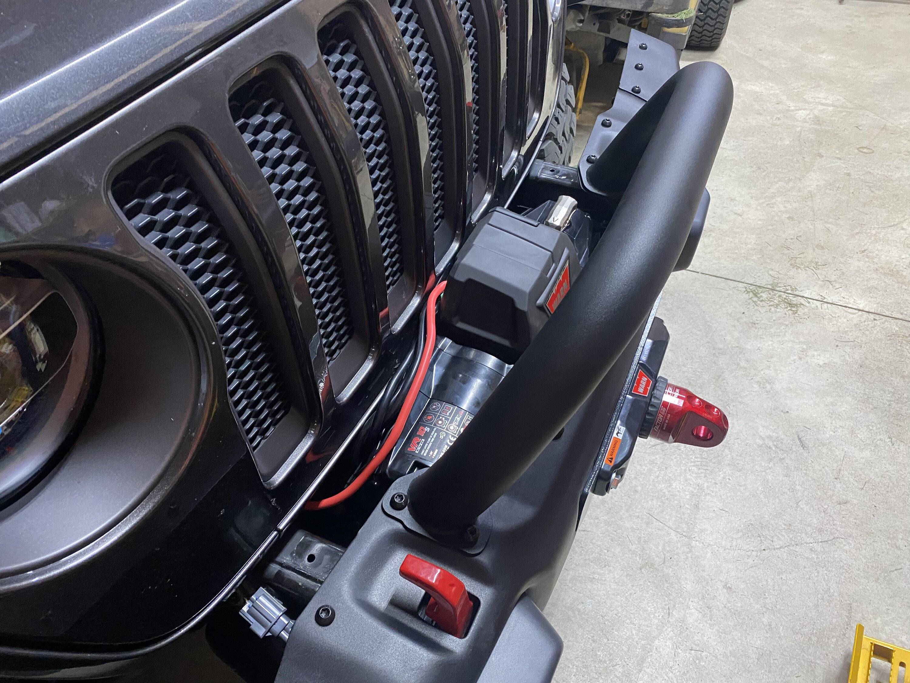

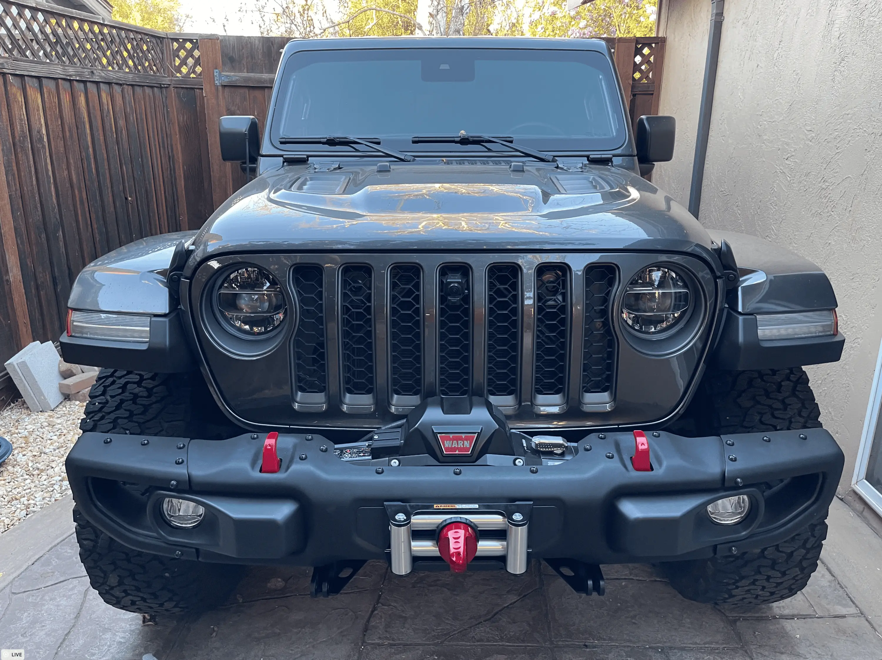

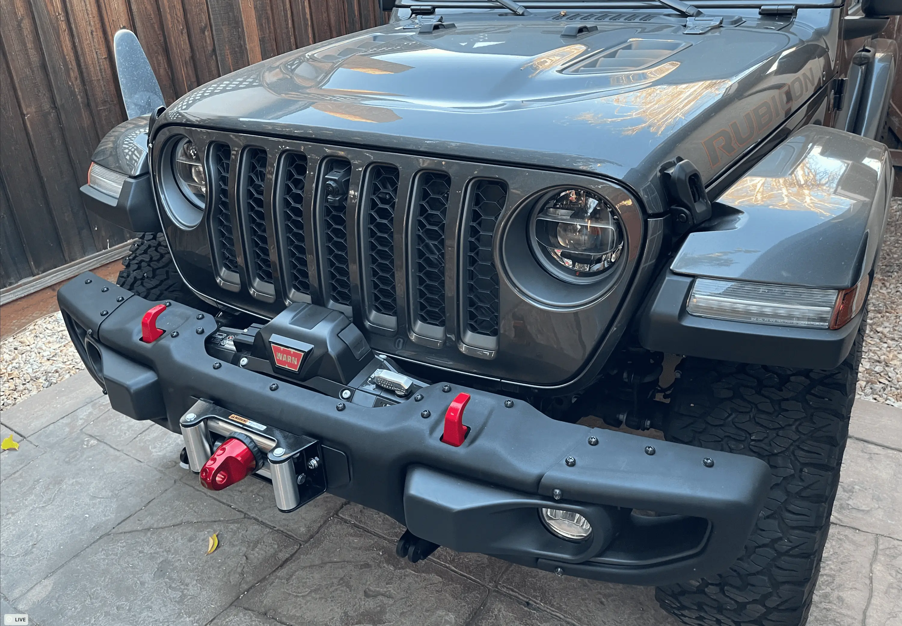

I installed the Warn Zeon 12s and the Warn winch plate in my mopar steel bumper, and it was completely a bolt on affair. Zero cutting or grinding. I also have frame reinforcement brackets that strengthen the bull bar, which are mounted on the inside of the frame rails, and still no issues...
Looks good, I've also got the steel Rubicon front bumper, what frame reinforcement brackets to strengthen OEM bullbar are you using?
Barnes 4WD sells some nice powder coated black metal pieces to cover the open area around and behind the winch, looks pretty nice too.
