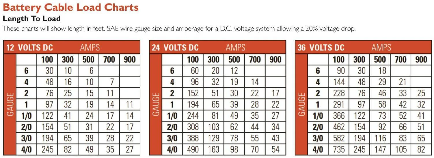

SAE J1127 (Battery Cable) doesn't specify ampacity. Best I can find is Waytek's battery cable chart allowing 20%:
Thanks for sharing the fuse/breaker trip and wire load charts - great stuff.
But, if 11 feet of 2 gauge wire can take 700 A continous, why did the OP winch cable melt it's insulation?

Thanks for sharing the fuse/breaker and wire load charts - great stuff.
Since it's an automotive chart, I'd assume it's based on a specific starter motor load duration.
Where resistance is minimal, current can skyrocket. (I=V/R) Solid 2 AWG is .000124 ohms/ft (from a quick google).
For 11 feet, I = 12V/.001364 ohms = 8,797.65 Amps.

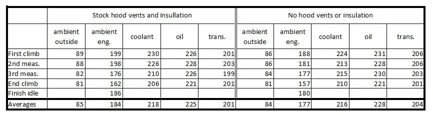

Engine bay temps can hit 200° F, according to testing in this thread:
Jeep Wrangler JL Botched winch install hood-vent-measurements-jpg
Personally, I've experimented with touching metal components near the battery and they are too hot to comfortably hold my palm on them for more than a second or 2. I should try my infrared thermometer.
I'm definitely still genuinely curious but skeptical about using a circuit breaker for winch wiring. Thanks for contributing your thoughts.
