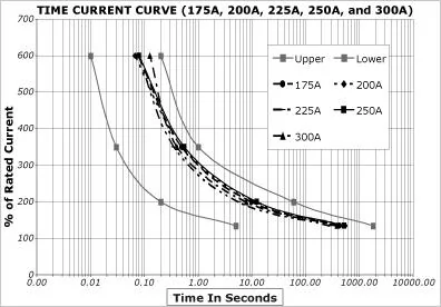

Which circuit breaker do you use and/or recommend?
For cost and availability, I'd probably go with the ANL fuse holder and handful of fuses mentioned earlier. Choose the fuse based on the trip curve and your individual winch current draw.

My question was about circuit breaker recommendations because I'm interested in whether they've been successfully used for winches.
Check out the data sheet on this guy.
This in a 200 amp version should do just fine for most winches. It will have double the amperage for at least 10 seconds before cutting out. There aren't many situations where your winch is going to be drawing it's max for very long. If it is you likely should've been using a pulley. Worst case, you let it cool and reset it.
https://powerwerx.com/eaton-187f-waterproof-circuit-breaker-surface-mount

The problem I have with these type of breakers is the 1200A it will flow for several seconds. At that point you probably have the melted wires/fire potential that you're trying to mitigate with the breaker in the 1st place. That's been my point all along. Any breaker large enough to power a large winch reliably will flow the full CCA of the battery for several seconds which defeats the purpose of the breaker.

The max operating temp (185° F) seems like a potential deal breaker for the engine bay.
And there's still the issue of potentially overheating 120 A rated wire with 200 A continuous current.
Kind of interesting to see the trip curves side by side. This is Blue Sea terminal fuse vs ANL fuse vs 187 Breaker (same Bussman line)
