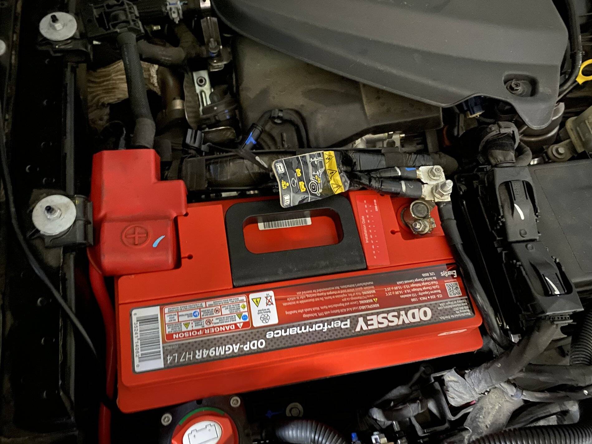

2021 diesel Never died , replaced with pure lead AGM ..
Jeep Wrangler JL When did your battery die? 3E04E4B8-ABE9-47F8-940A-AEBA86BC26BA
