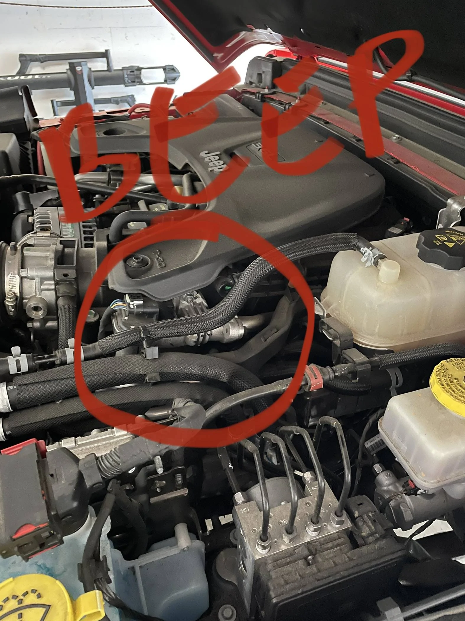

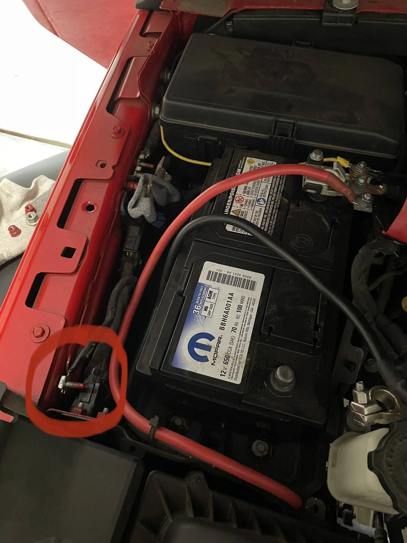

I have a 2019 JLU with a 3.6. I’m trying to disconnect the battery to remove the seats to avoid airbag problems. I’ve disconnected all battery terminals yet there is a strange audible steady tone sound coming from somewhere in the engine when I disconnect a certain cable marked in the picture. Any ideas how I can completely disconnect this battery or what this beeping is?

You would not be hearing the tone if 12v was totally killed... You need to disconnect and separate the cables.
Follow these instructions:
