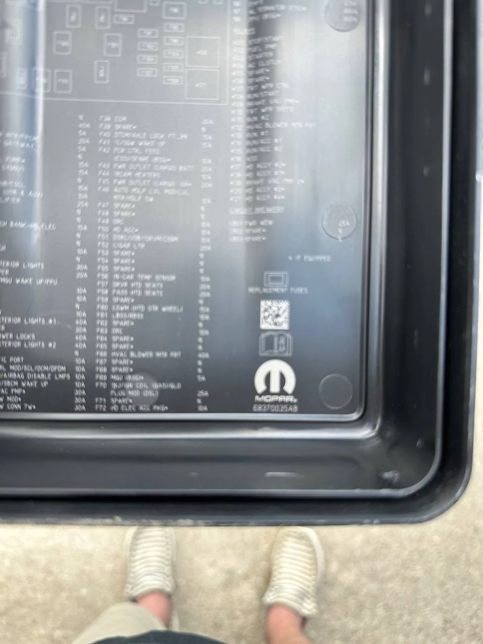

2018 jlur very early build.
I removed negative cable from main and pulled fuse 42.
done just like videos show. I forgot to disable the start stop switch and the start stop flashed green and did its thing.
I was having all kinds of codes before this and now it’s worse. Any tips here?
