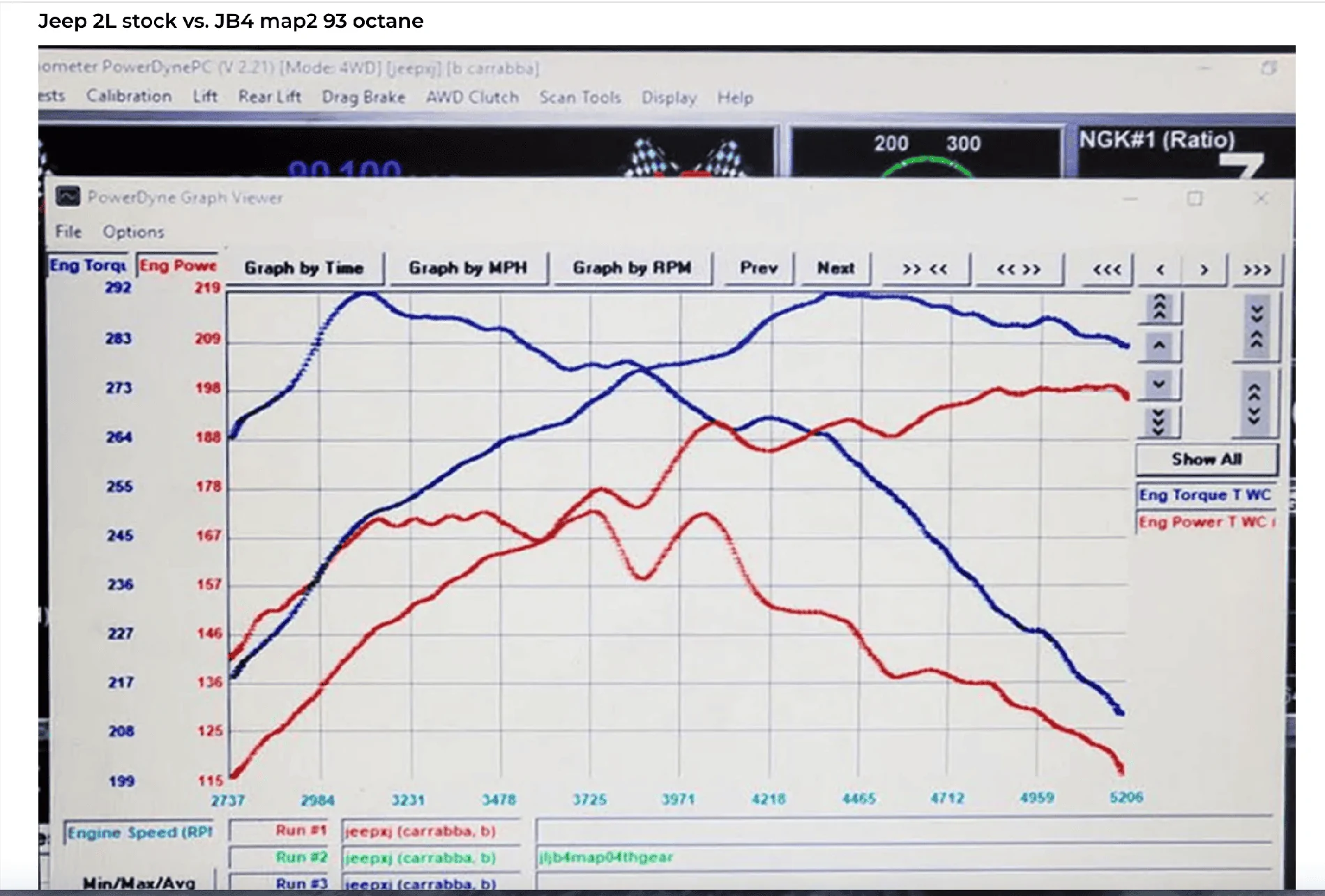

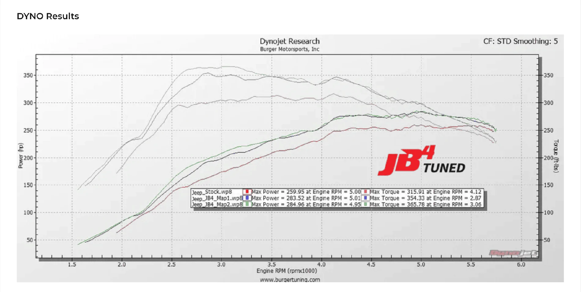

What's everyone's thoughts on the JB4 tuner? They claim some pretty serious gains and have dyno charts to back it up.

Are you looking to spend money, just for the sake of spending money?
Obviously an unhelpful rhetorical question. So I take that to mean it's not worth it? If not, why? Or did you just feel like posting a comment for no reason other than to waste your time and mine?
