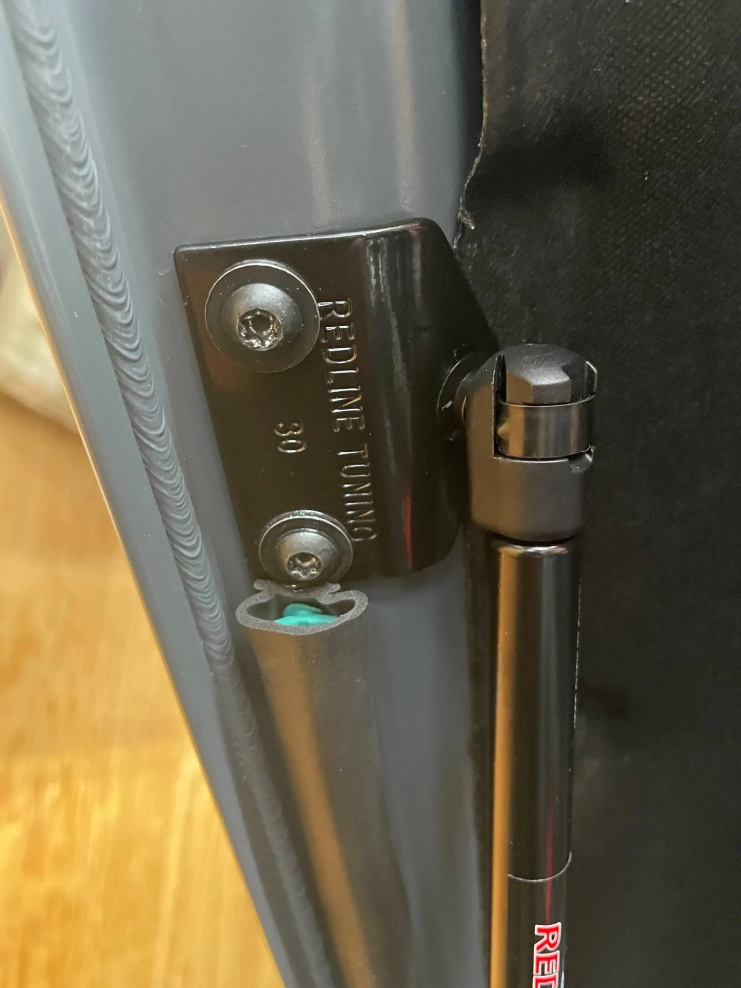

@Redline Tuning I received the the quick lift system on my 2024 Rubicon with a slight problem and I made a modification you may or not be interested in.
While installing the hood mounting units using a 1/4 drive ratchet I could feel the threads starting to strip out even though I did not apply too much torque. So, not satisfied I removed both sides and came up with what I think was a better game plan.
Simply put I re tapped the backing piece to a 1/4 x 20 thread and used some left over Harley Davidson torx bits fasteners and washers. I applied blue Loctite to all fasteners and easily tightened without over tightening using a torx bit screwdriver.
Additionally I trimmed the weather stripping off at the end so as to not overlap the bracket and fasteners. In my opinion this is better than the fasteners you used with the kit and I am attaching a photo for your consideration.
Not meaning to step on anyone's toes but I think these are better for the kit.
