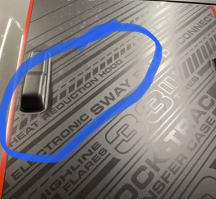

Side note, and I know this is kinda petty on my part… but this really ticks me off:
In my opinion that is a flat out marketing lie.
Where did you see this and maybe we can get Jeep to give us a recall and give us all head reduction hoods.... I mean... after seeing this I decided to buy my Jeep so, this was the sole determining factor....
It’s the hood sticker that came on our 2020 Recon edition. Me too! Totally got suckered by what turned out to be fake vents but a little ginsu action on the plastic and all is right in the world now. ;)

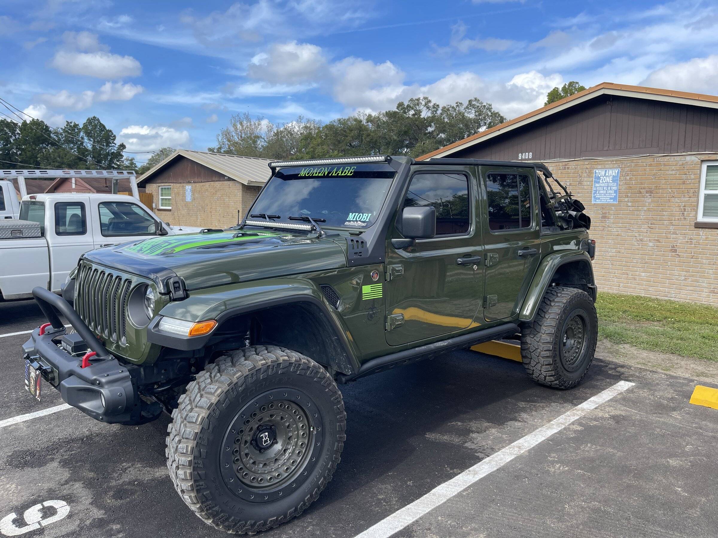

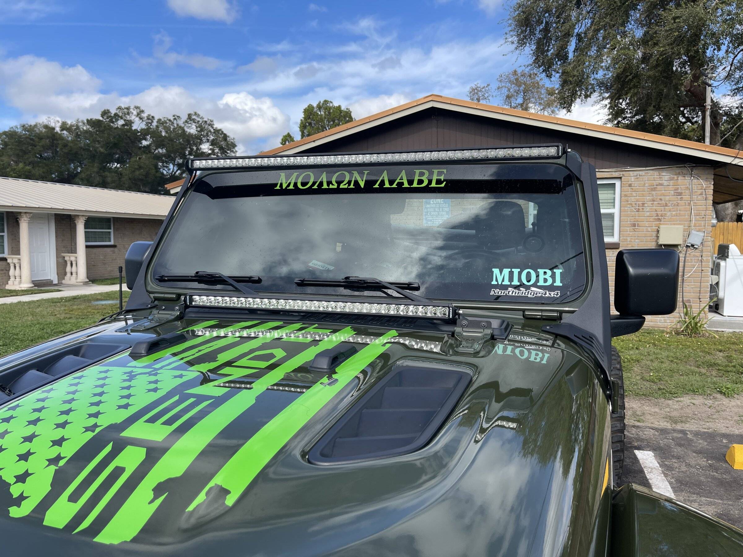

So after reading 8 pages of comments here my crayon eater thoughts. I also went with the redline struts absolutely love them. I also used a dermal and opened up the vents on the hood. As for the insulators slash waste of material I took it out . I have a flag decal on my hood I’m also in Florida .
OK, thanks! Nice graphics. Love the drab!
