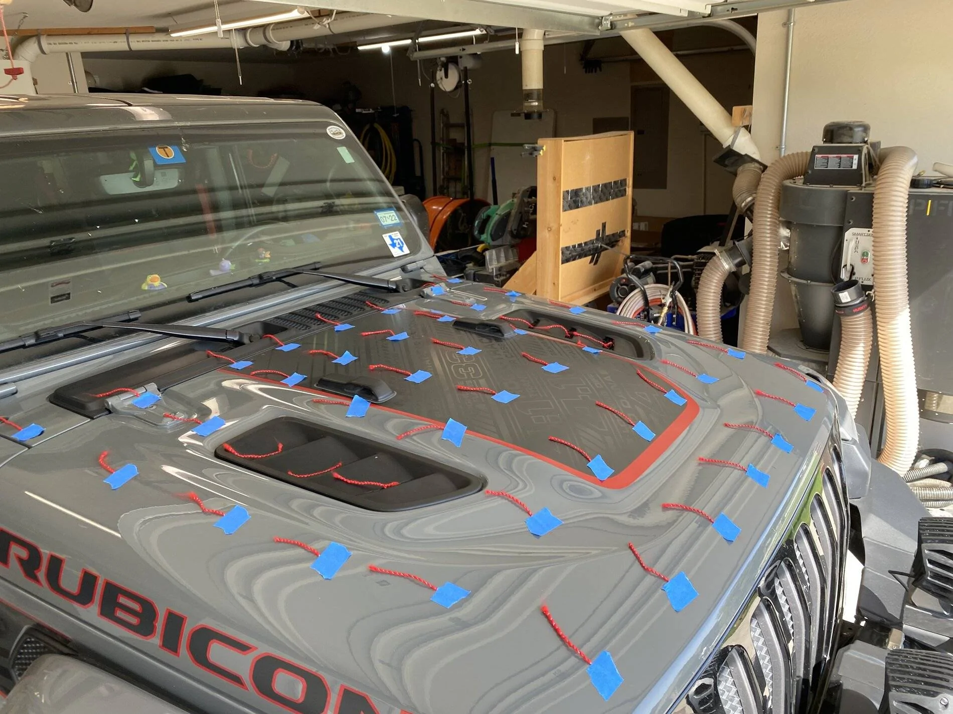

So I decided to get sciency this morning and taped a bunch of yarn to the hood a la NASA style:
Then took it for a spin down a backroad to see what happened:

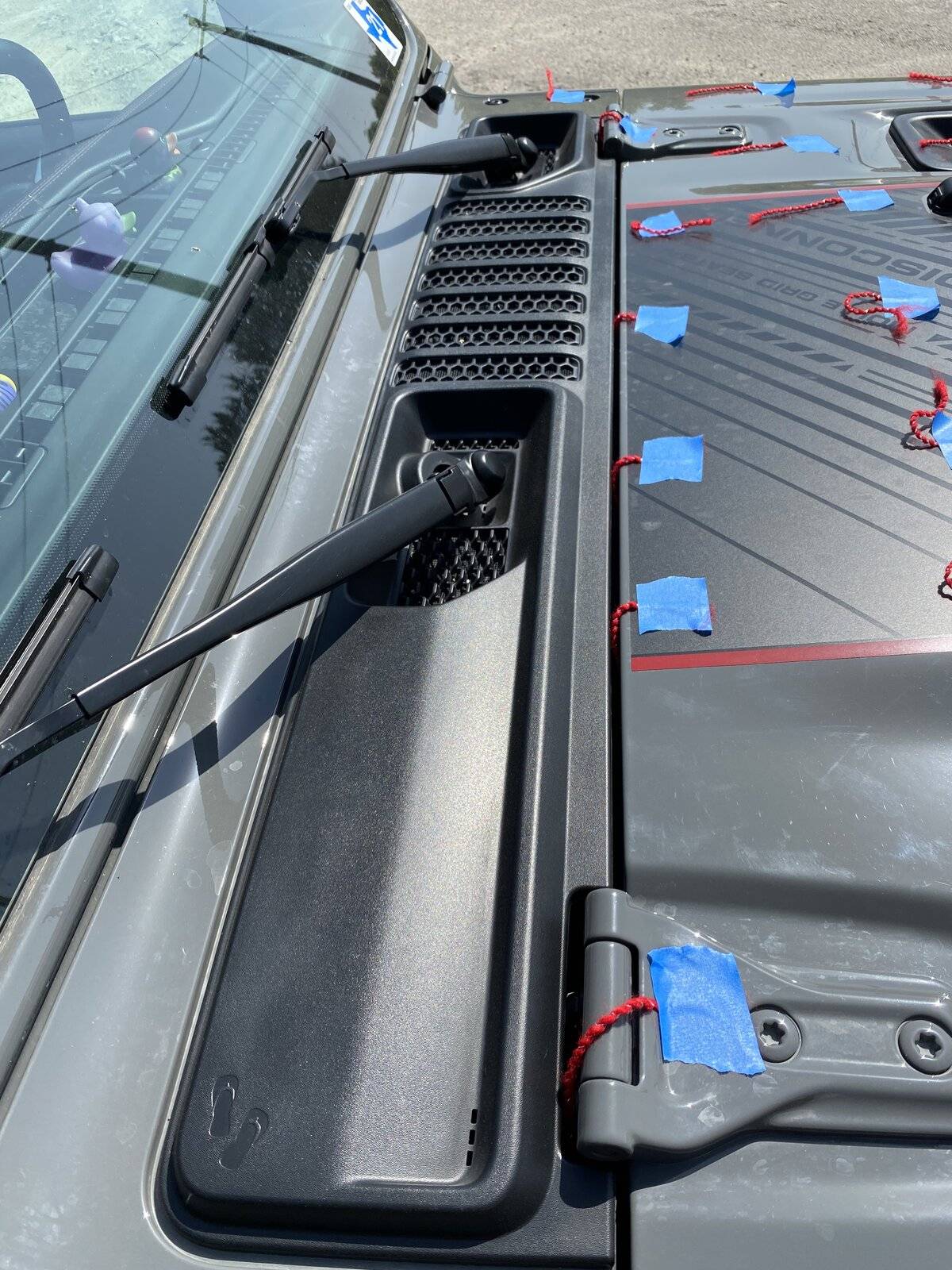

It appears the center yarns are going directly at the windshield, the edge most ones are at a bit of an angle to the direction of travel, and the vent ones are even more so at an angle. My thoughts on that is there IS air coming up and out and the lowest pressure direction for it to escape is out to the sides.
Interestingly, ALL of the yarns nearest the windshield pushed down into the engine compartment which might be an indication that elevating the rear of the hood is allowing higher pressure air from the windshield to push into the engine compartment rather than allowing hot air to escape. Edit: the one that isn’t going down I pulled out to “restart the test” before I registered it was all of them like that.
After we got the fan spinning at takeoff speeds, the yarn stayed laying down on the vents. I could feel air coming out though and wanted a better idea of how much. Jarhead mentality, if you can’t break it, light it on fire:
There is noticeably more airflow on the passenger side and I suspect (on a 2.0T at least) this is because it is alot more cramped on that side than the driver side.
My theory is the fan brings air in, and it rides along the underside of the hood and out the vent because it can’t escape down as easily. This may also be why our batteries have such a short life expectancy. If you want to cook hot dogs on your motor, on top of the battery is probably a good place.

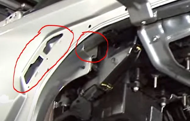

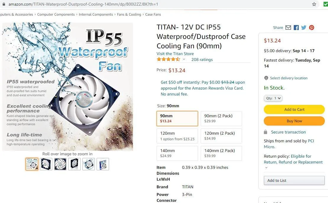

I found these 12V water & dust proof mini fans online (see attached). I wonder if an evacuation duct could be used with these fans and routed through the side vents (see attached) to dissipate heat and relieve pressure under the hood

Those look like cooling fans for a PC, not sure they are intended to operate in an engine compartment but I like where you're going. I think we need to reduce back pressure in the engine compartment. In the gladiator forum thread somebody pointed out there should be a seal between the bottom of the radiator and grill to help direct air through the radiator rather then under it. That also sounds like a reasonable addition.
